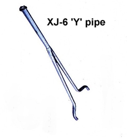

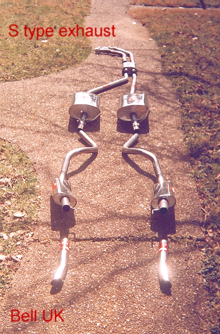

I removed both exhaust systems in my XJ and S type, and then reinstalled brand new stock systems in both, all by myself with the cars on blocks, one piece at a time, but I never measured the diameter of the pipes.
Having said that, I believe the XJ pipes are indeed 1 and 7/8" diameter, and the S type's are 1 and 5/8", so you might have it correctly. However, the stainless steel Tips are narrower in the XJ 4.2 than they are in the S type 3.8, which contradicts the measurements of the pipes.
Here's a picture of the complete exhaust system for the S type before I installed it, and a picture of the European 'Y' pipe I installed in the XJ-6. (the European 'Y' pipe does not have the second catalityc converter found in US cars).
