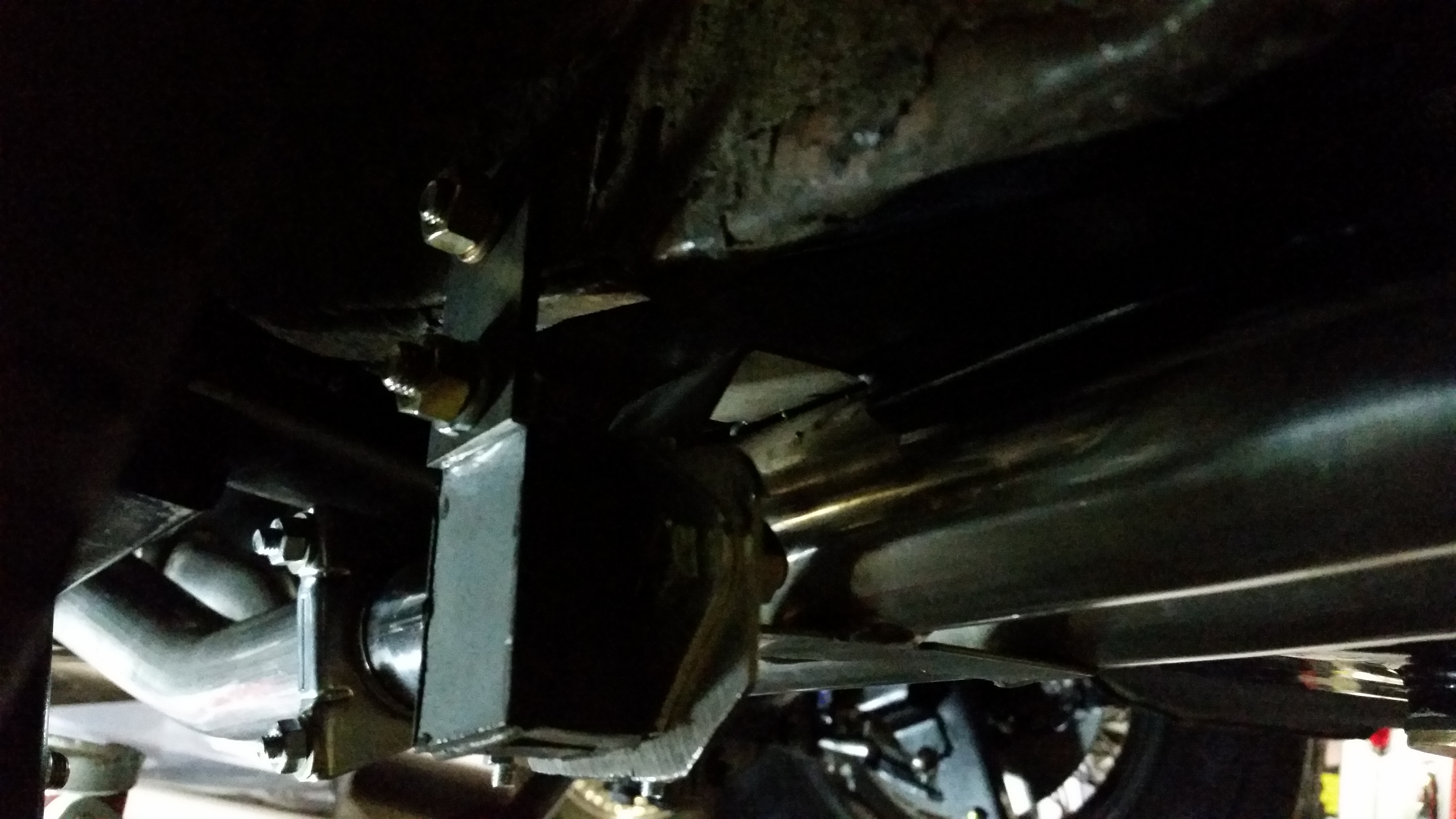

Here's a picture of the rear-most exhaust mount extension strap. I thought I had used aluminum, but clearly its steel.
Hope this is helpful.

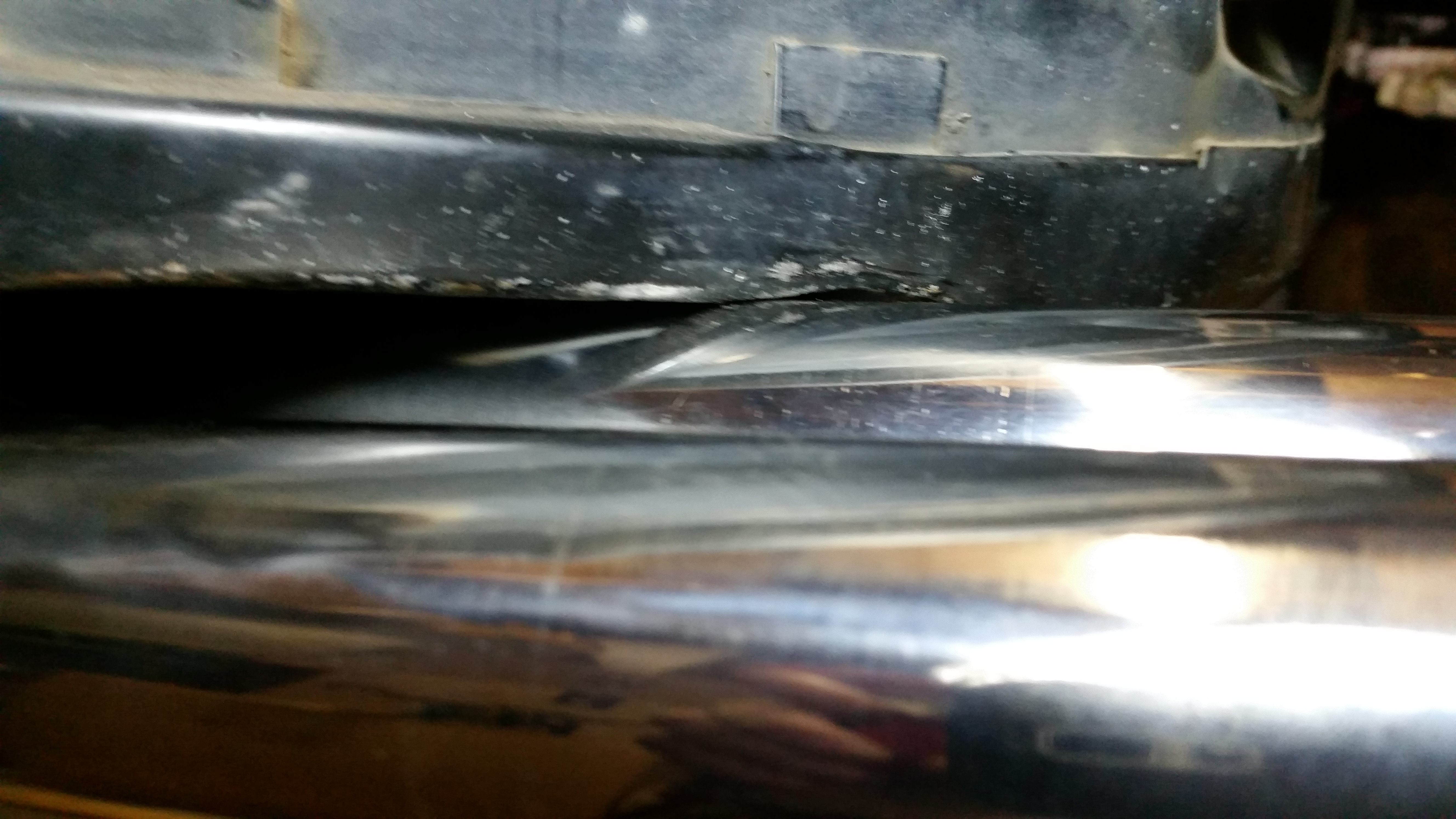

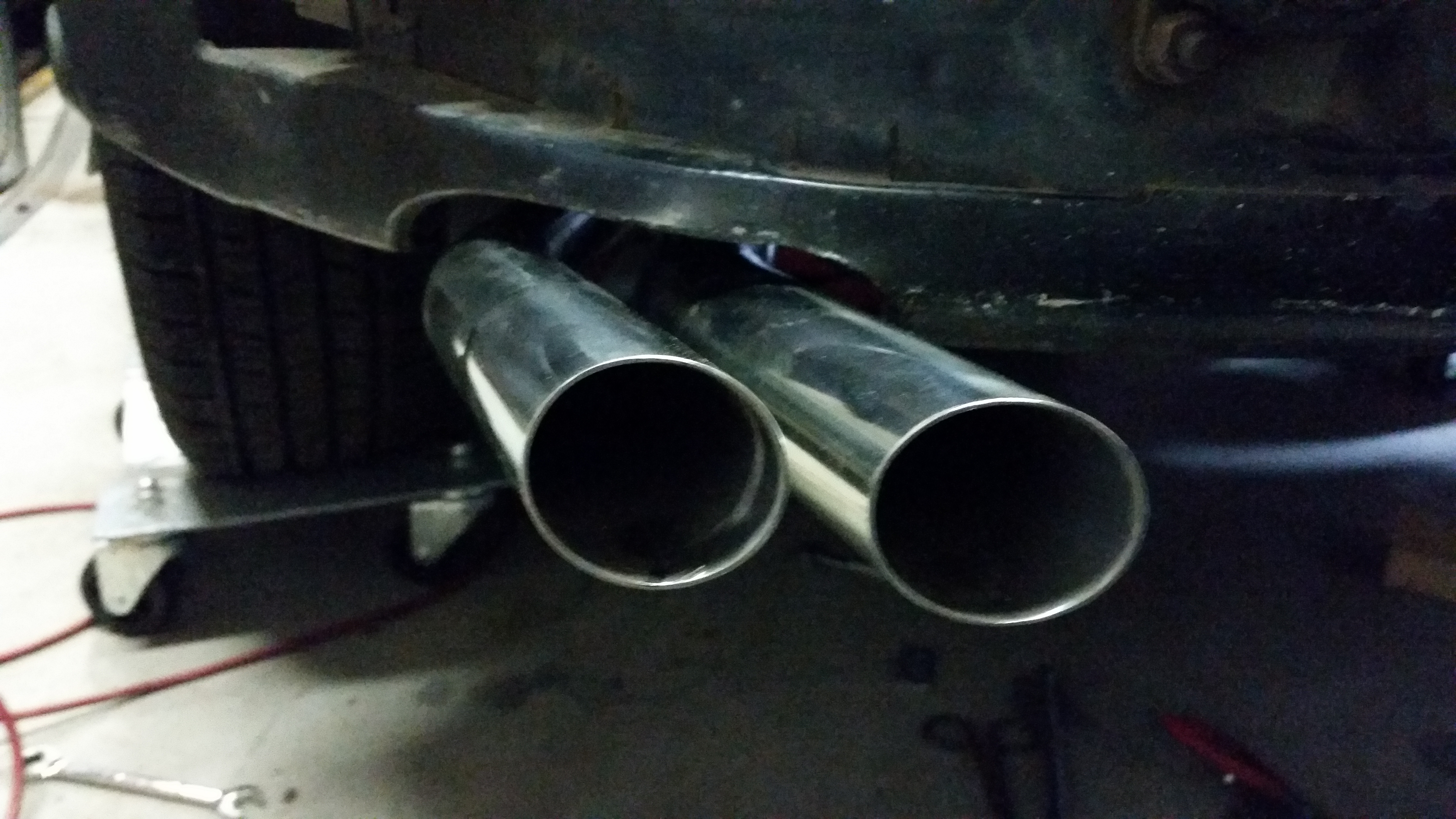

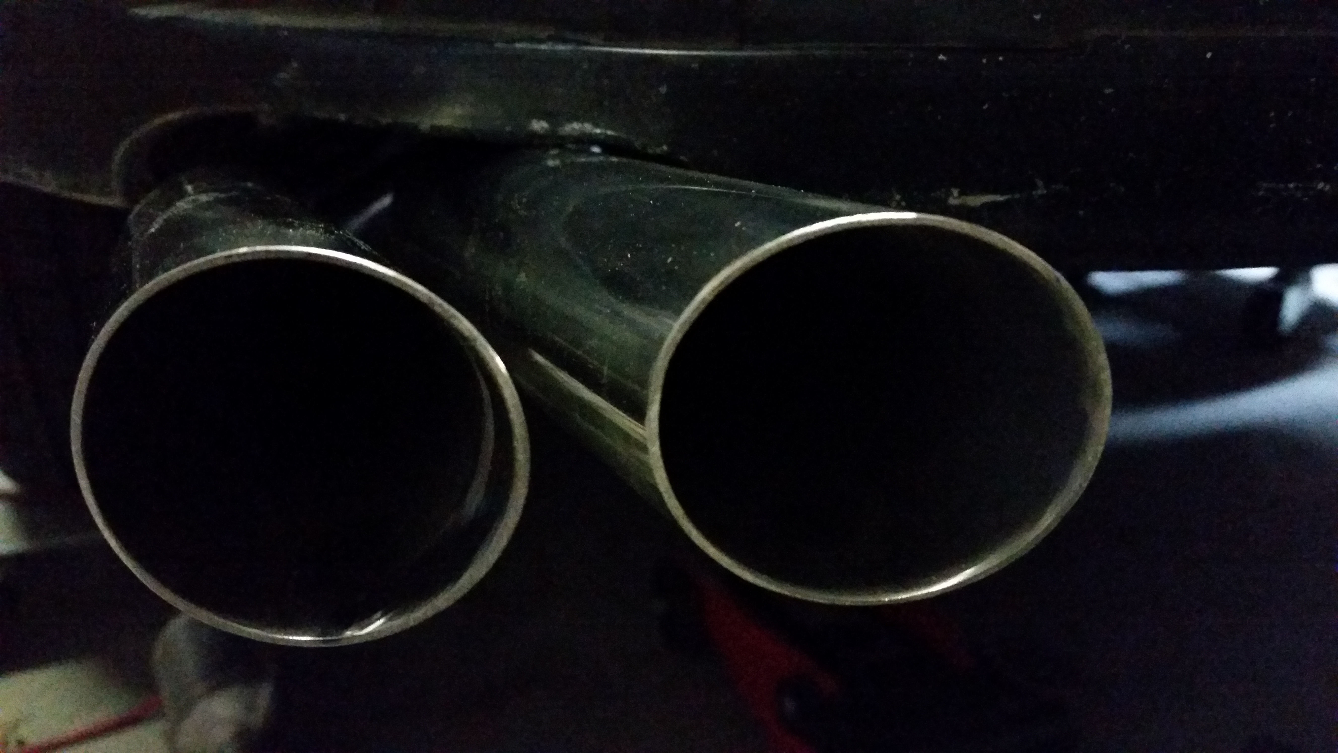

Jon, in addition to the photo Dean posted, I have included two photos showing where the tail pipe exits the body at the rear. As you can see, the tail pipes touch the body and are not level. I wasn't able to get a good photo of the tail pipes relative to the fuel tank, but the clearance there is less than 1/4". I haven't made the extensions yet, but I plan to do the same thing Dean has done. This lowers the entire system. My belief is that the two pipes exiting the mufflers were installed at the wrong angle, creating the problems some of us are having.

Interesting, if you look at SNG for the fixings kit BSSFK015 they supply the mounts you guys have used and also the round doughnut rubbers for the ring mounting bracket C25017 I wonder if the ring brackets would suspend the exhaust in a lower position which would be a problem with the fixing kit rather than the exhaust itself ?
Could you post a dimension for the mounts you have i.e. from the 2 bolt holes (lower in the pic) to the single bolt hole (fixed to your adapter bracket), I could compare that to the ring type mount to see what the difference is, as I think from memory that the ring bracket bolt to bolt dimension is greater than that I can see in your picture for the new mount.

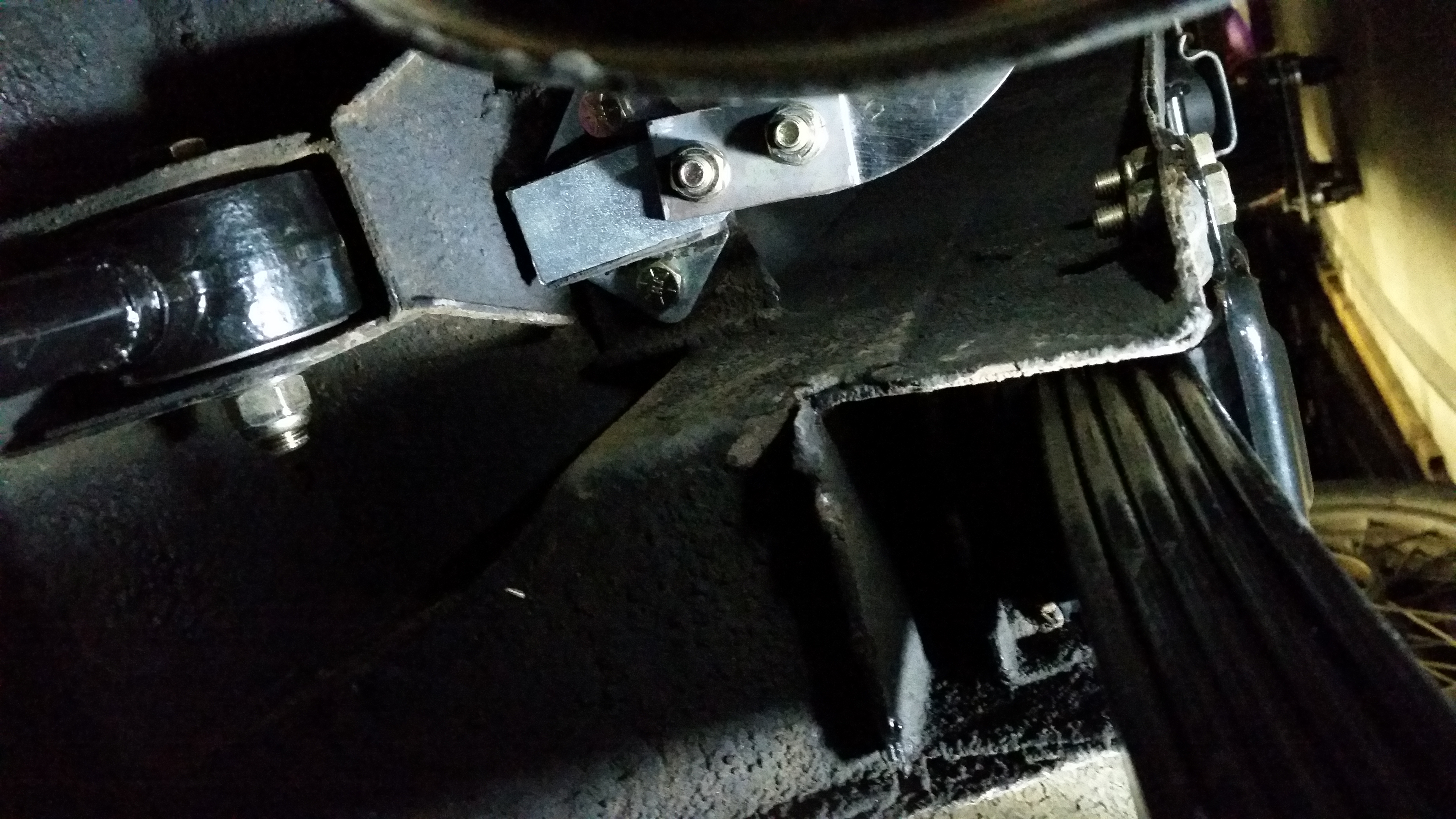

One last post to this thread. I have included photos of the brackets I made, two of the mounting positions and the final result at the rear of the body. The gap between the tail pipe and body is now about 1/2" and about the same to the fuel tank.

The photos didn't make it, so one more try. On the muffler mounting tabs, the brackets I installed are 1" center to center for the bolts.
