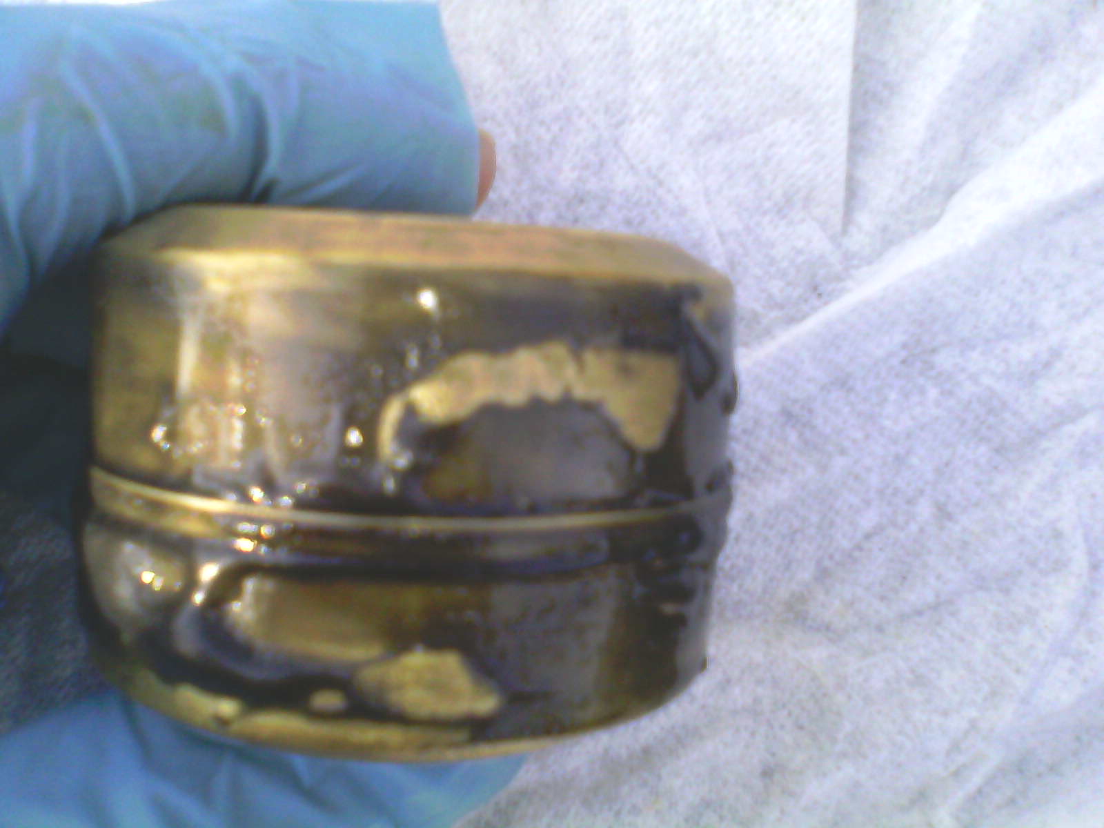

Update: there may or may not have been water inside.
I shook the float, and there was a distinctive ping sound.
I suspect a drop of solder came off during the first heating.
It was heated again, and a drop or two or water teared out, maybe from the top of the float. The Plastic bond shriveled off.
It is now being filed off.
When the plastic bond was first applied, it went on very smooth and even.
But as it set, gravity pulled it down, and it aggravated into drops that dried.
The attached picture shows some of the long accumulation.
So it will be filed down, and retried with less, and then dunked again in water to determine water-proof or not
Will try again.

Update: the the clumps of sealant were filed off. And there was a small hole on the circumference, probably from the expansion when the torch was used.
Next the sealant will be applied in timed sequences to avoid clumping.
Then it will dunked in water and then gasoline.
Attached Thumbnails Float Fix - Hairline Crack - JB Weld, No - Solder Next-037.jpg   Float Fix - Hairline Crack - JB Weld, No - Solder Next-038.jpg

Why not just use gasoline, since the float will never have to work in water ?
Old Apr 22, 2017 | 05:53 PM
1964Daimler's Avatar
Joined: Jun 2015
Posts: 203
Likes: 12
Good point... gasoline was next in the process.
The reason: given the combustible nature of gasoline, water was the first choice to determine seal. And then would come gas next phase.
