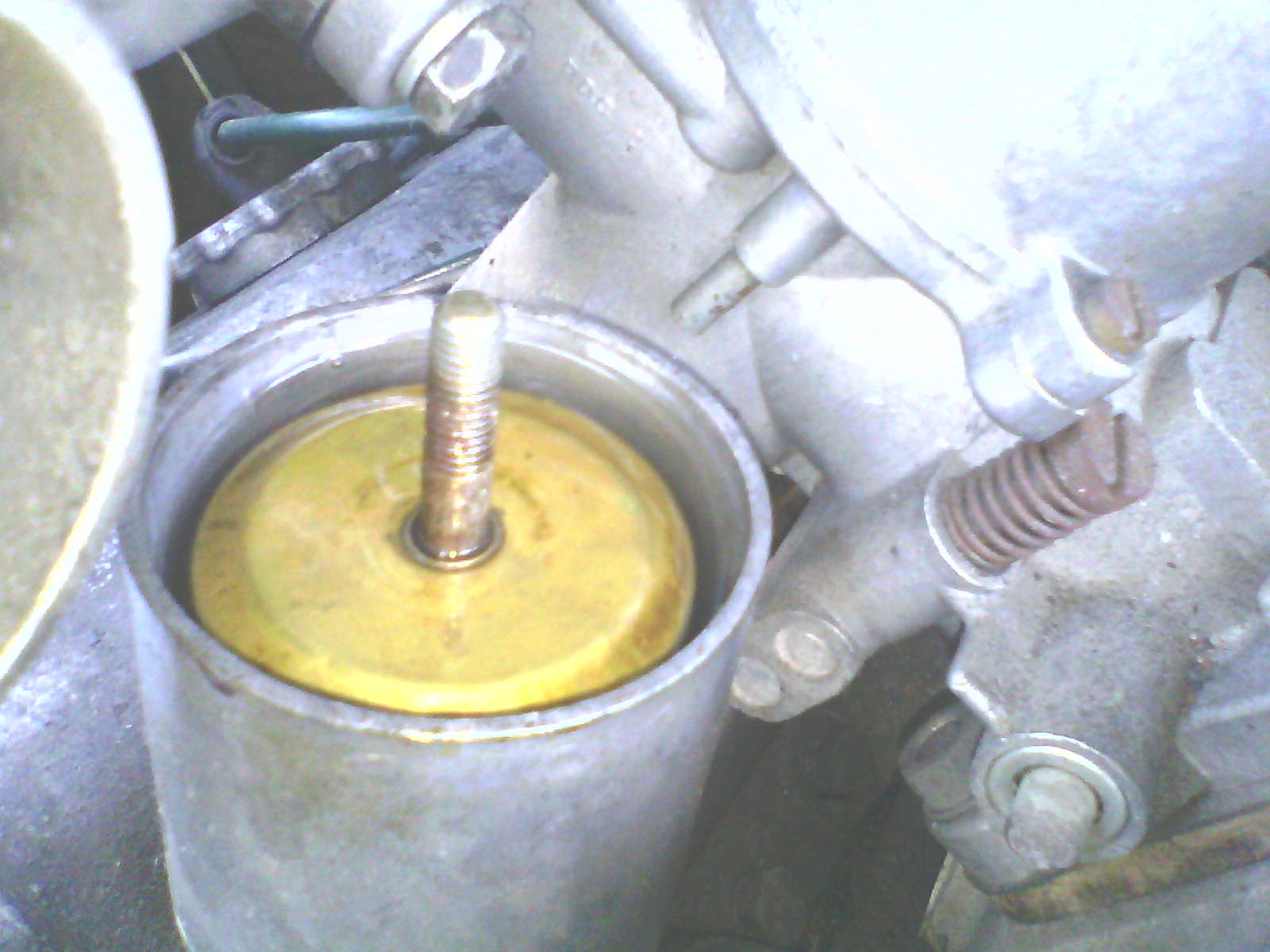

Well the float fix has been suspended for the moment. I put on solder on the crack and sanded it smooth. Then I dunked in water over night and shook the float the next morning. Water was inside. I realized that there were more hairline cracks on the float than I could see.
I'll still try other repair methods just for a learning experience, but right now the goal is to get a working float to float.
( FYI: JB Weld worked the best but the skin came off after a two days dunked in water. )
So I went out and bought a new float for $20.
Put it into the bowl, and it floated to the top when the gas filled the bowl. I checked the two-prong "armature" that closes the inlet valve and the pin atop: all work fine.
But now the car won't start!
I put starter spray into the air intake, and the engine starts and then dies. It won't idle.
So I wonder:
A) Is the connection from the float bowl into the carb clogged?
B) Bad gas?
C) Pressure from the gas line insufficient?
( I doubt "C" as both bowls are full of gas )
Any thoughts?

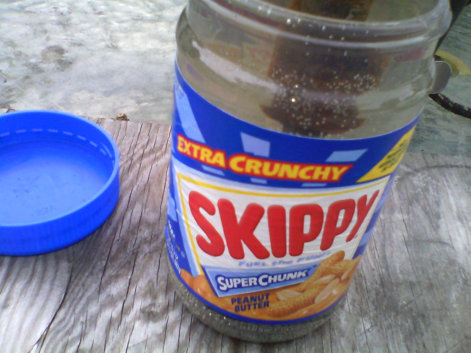

Still getting results...
Thus far, it did hold.
I've had it submerged for about three days in water
( See pics )
Not sure if Super Chunky, chunky, or smooth variables may affect results
I will note that I did take the float out today and shook it to see if any liquid seeped inside.
I heard something, but it didn't sound like water sloshing about.
More of a ping that was bouncing around...
Maybe a bit of solder from the interior dislodged... maybe not
( There was a storm that knocked it off the table, so it is possible )
And as was noted, it was already dinged up a lot.
So it's just floating in H2O at the moment.
Will post more float updates as it happens.
