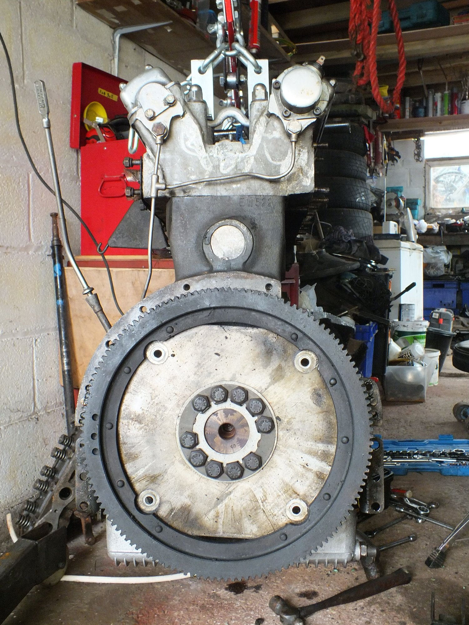

Here is a picture of my ring gear which I think has 133 teeth. Mine is a 3.4s with the BW35 auto gearbox.

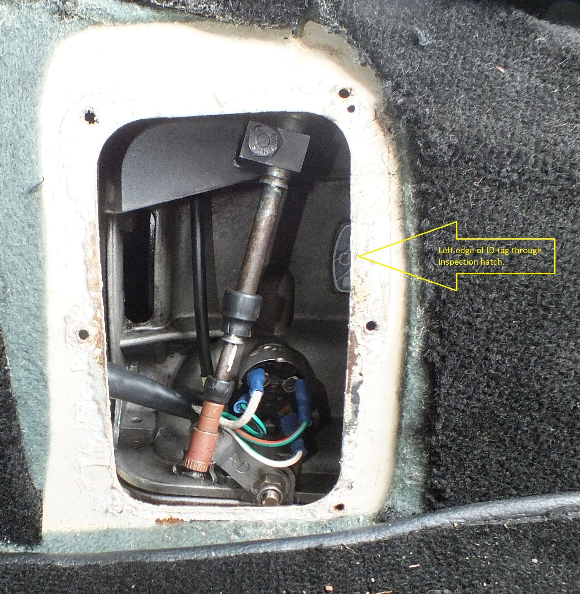

The ID plate is not easy to get to as it is tucked up on the left side of the gearbox so the only way to see it is with the gearbox out or by sticking a camera phone up the side of the box and tunnel and take a photo of it. You will need to take several to get a clear one. The ID plate actually says "Borg Warner 35" and should have the serial number beginning FG. Obviously you can also find this number on the VIN plate so if your gear box number begins FG it is a BW35. If it begins JBC its a DG250. There is an inspection plate in the left side of the gearbox tunnel that gives you access to the gear change lever and if it is a BW35 the Inhibitor switch located on the side of the gearbox. You could by looking in this hatch see the ID plate. The DG250 has the inhibitor switch under the dash behind the gear selector handle.

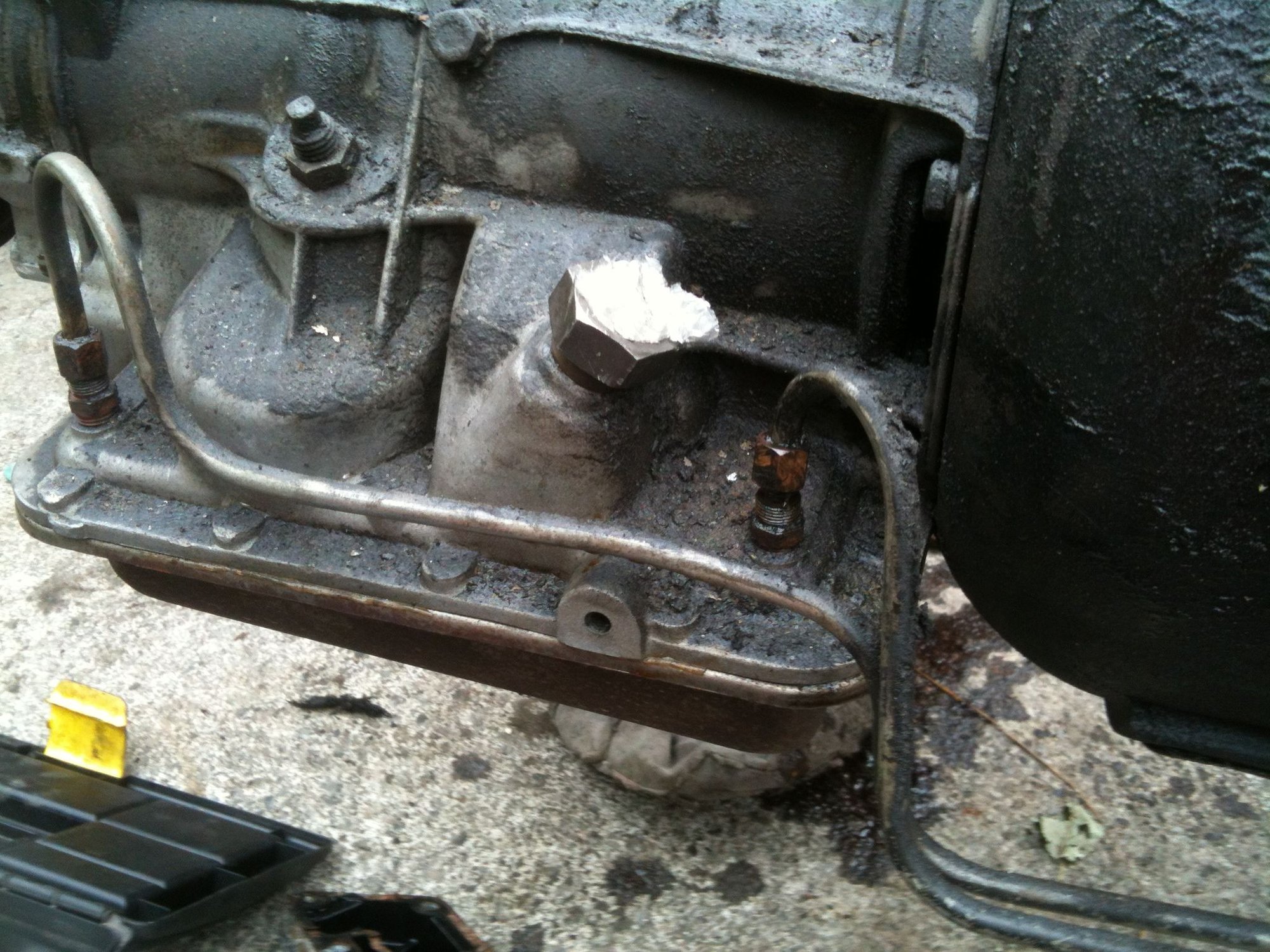

The BW35 has an oil cooler in the bottom of the radiator and has two pipes running from the right side of the gearbox along the line of the sump joint to the bottom of the water radiator.

Location of the ID plate on the BW35 gearbox.
Oil cooler pipes coming from right side of BW35 gearbox.
