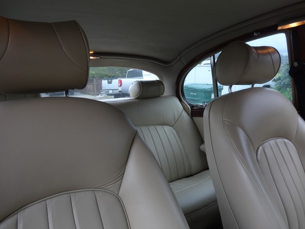

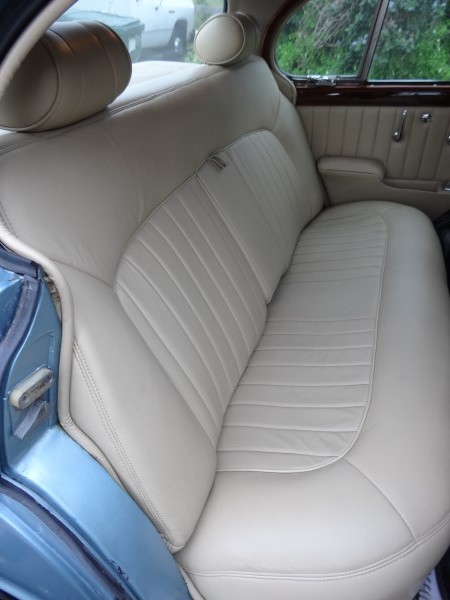

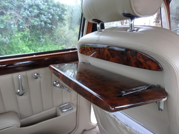

I have a 1963 S type and for me I mounted 2004 Vaden Plas front and rear seats. I wanted full electric seats with the wooden picnic trays and full head support. I think any of the Jaguar sedan and sports car seats will fit but some modifications will be needed. For my setup the front seats required some minor cutting of the seat mount and minor welding to clean it up and make it clean. The rear seats were 1 foot too long so they had to be sectioned to fit. Even if you do not have those skills any good custom car shop that can weld could to the same and the mods would take them a day or two max so I would not let that scare you off. I doubt any seat will just drop right in without some mods. I did not need to modify the center consul for the seats but I did add cup holders and two gauges to monitor my dual battery system.
Doug, whom has a MKII with a modern Jagu V8 did a similar seat install as mine but he added a modern consul, etc. but looking at his I think you could do it with the stock consul but maybe you might need to mod it to fit?
