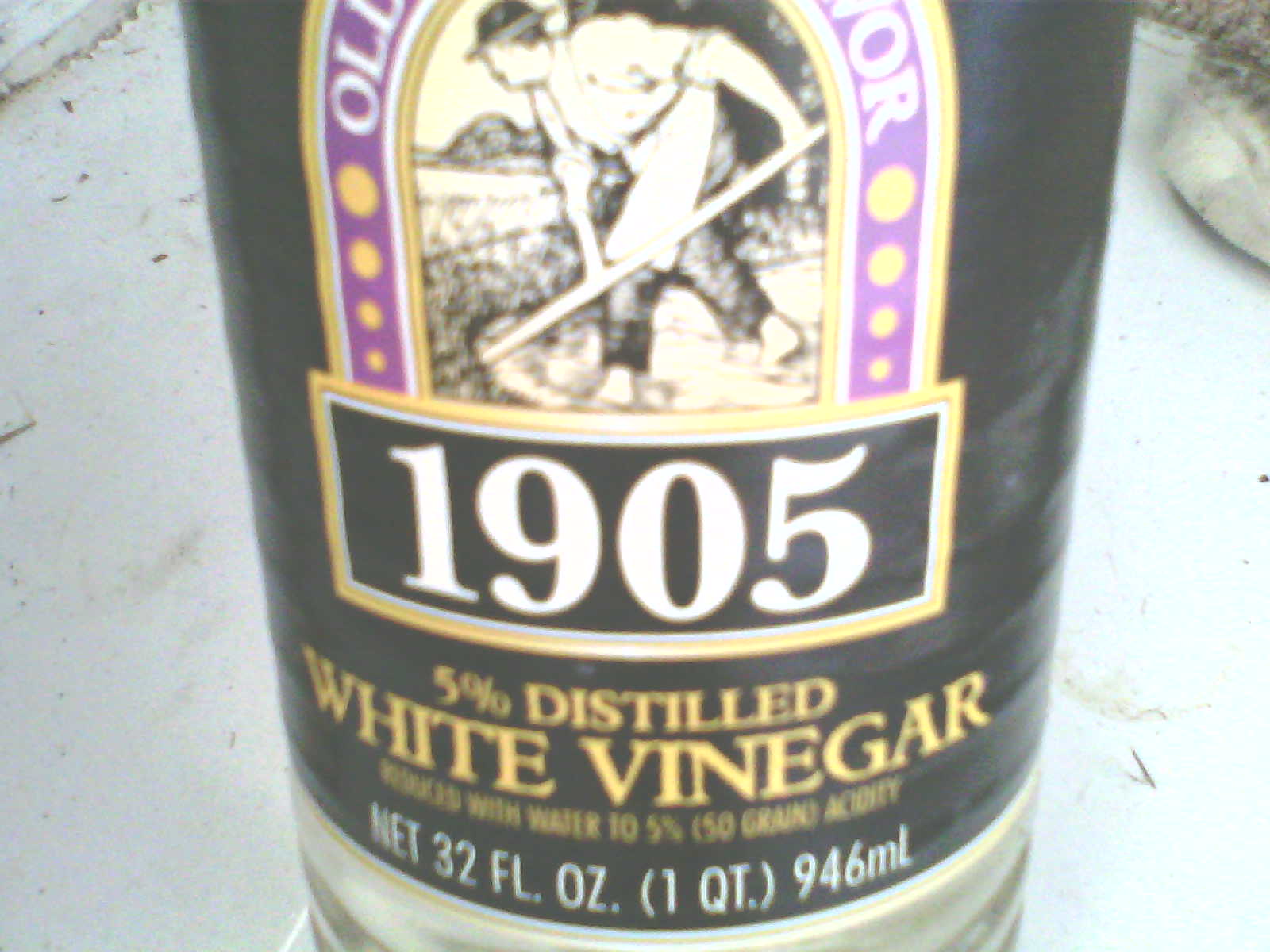

The situation is this 1964 Daimler had gas sitting in the tank and lines for at least six years. The fuel had turned beat red. I cleaned out the glass filling pot and took a sample to the local British Motor Supply (BMS) shop when I brought in a fuel float that was sticking. ( The red fuel was spouting out the overflow. Will post the pics when I find them ...)
The BMS guy said the red fuel would clog the pistons and valves if I ran it through the engine and result in an engine seizing. The seizing means the whole engine would then need to be rebuilt. Advised to clean out the lines.
So this is what I did. Please comment and critic.
1) I disconnected the feed line going into the gas tank and put the line into a bottle of 1905 White Vinegar ( 1905 was a good year for vinegar!).
2) I disconnected the gas line going into the glass gas holding vial inside the engine compartment and put the line into an empty bottle.
3) I turned on the ignition and let the electric gas pump pull the vinegar through the gas lines to clean out any residual bad gas that was in the gas lines.
4) It flowed clear.
( No vinegar was ever in the glass vial or into the carburetor. )

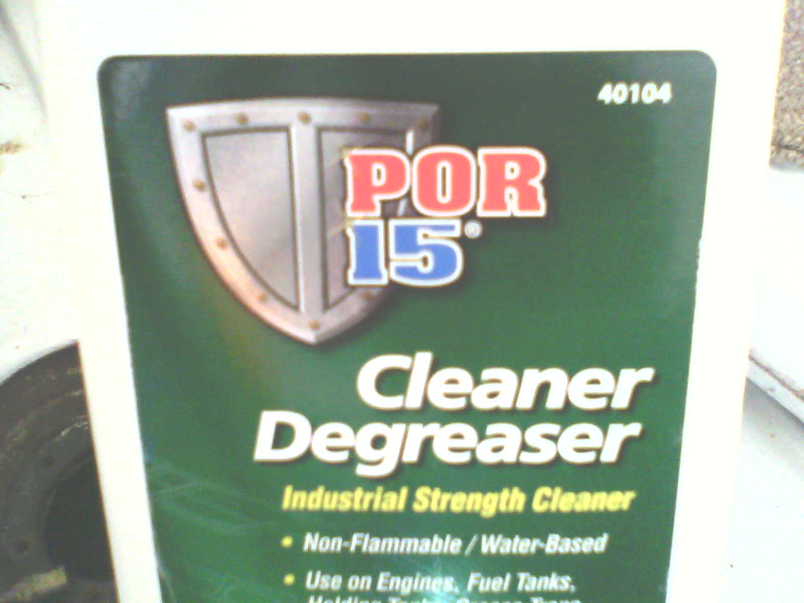

I am concerned as to any more of the beet red gas in the gas tank.I unscrewed the gas cap and put a stick into the gas tank. Nothing. I was still concerned, so I took off the round shield and float inside trunk ( English conversion: bonnet???).
I looked inside the tank. It was dry. But I did see some film remnants of the beet red gas. So I bought a bottle of Por15 Tank Cleaner.
I poured in half of the bottle and boiling hot water, per directions. Let it set and then dry. Was told to let the mixture set and evaporate.
This is where I am at this time.
Next put some gas into tank and run through lines into a container, just as I have set up now without connection to carburetor or engine.
When I see clean gas come through, all is good. Reconnect gas lines and monitor the glass holding vial for any contaminants.
But before proceeding, I request you thoughts an opinions.
And since I have the float out of the tank, before it goes back inside the tank, what can I do to it to ensure good/better working order?

One more thing, I've never heard of vinegar to remove old gas, just use fresh gas and discard it after words.

Update:
I looked into the gas tank after using the tank cleaner. There wasn't any of that red gunk.
So I put the float back in, screwed it into place, and reconnected the wires, both green and yellow.
I'll run some gas through the disconnected gas pump before reconnecting the line back into the tank. Once that fuel line is clean, I'll then reconnect the gas pump intake line to the tank and put in a gallon or two of gas.
I'll flush it out via the pump, thru the gas lines, and into the engine compartment and into a gas can. I'll inspect the gas and see what comes out visually.
If the gas is clear and clean, is it good to go into the engine for ignition and fire up run?

You should see a small fuel filter in the engine compartment. If that is there and not blocked, and doesn't get blocked you're OK. Filtration has to be really fine with fuel injected systems due to the very fine clearances, but is not quite so critical with carburettor systems.
