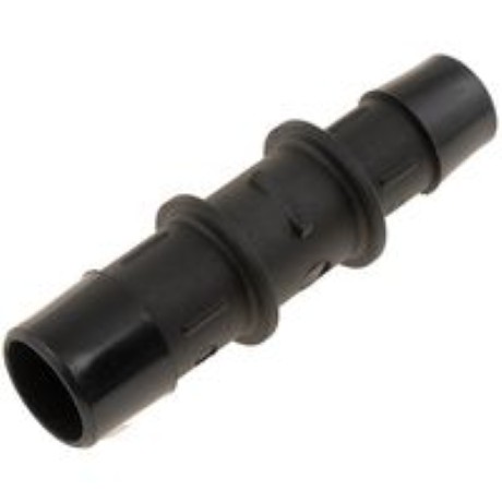

guys,
if you want to save the valve, (even though it is useless anyway), you can buy a splicer for two different sized hoses at Autozone, Advance auto, O'Reilly's , like the one below:
