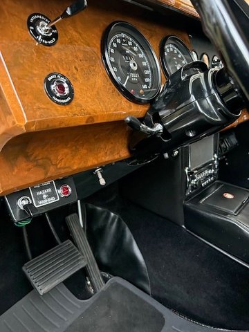

yes, far left of the wood panel in LHD cars, at the bottom edge of the panel with two screws.
Not sure but I think the hazard switch started in 1967 for USA cars. I have seen 1966 MK-2 and S type without it.

My Canadian market 1966 Mk2 3.8 has the hazard switch panel as Jose describes, left side, below the dash panel.

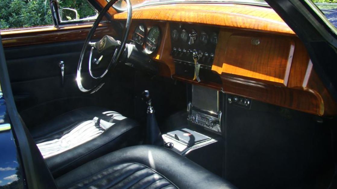

My 340 has it to the right of the main switch control panel.
Left hand drive car has it located on the passenger side. Like this for mine.

Here is a photo from my 1966 Mk 2 (build date: January 04, 1966) showing the original placement of the "Hazard" switch to the left of the steering wheel, LHD- another example of factory variations?

my '67 U.S.California 340 3.4l manual mk2 has it mounted under the dash to the RIGHT of center and LEFT of glovebox. like that shown in post #4. i have no reason to believe it has been moved from its original factory installed location.
both locations make it appear to be an afterthought. although i suspect it was a federally mandated import requirement and was dealt with as economically as possible.
truth is that when i first noticed it, i assumed it was added on by a previous owner that valued safety above all else. ha
