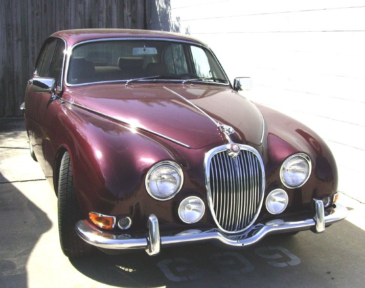

here's mine, a 1965 S type, I paid the price and I'm still having fun.
Attached Thumbnails How far gone is too far Gone (MK2)-jaguar-s-type-jose.jpg

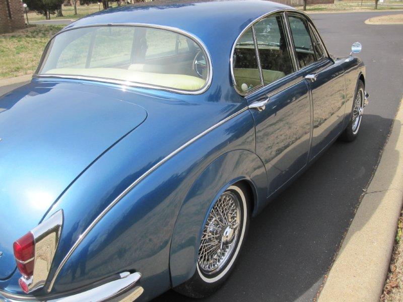

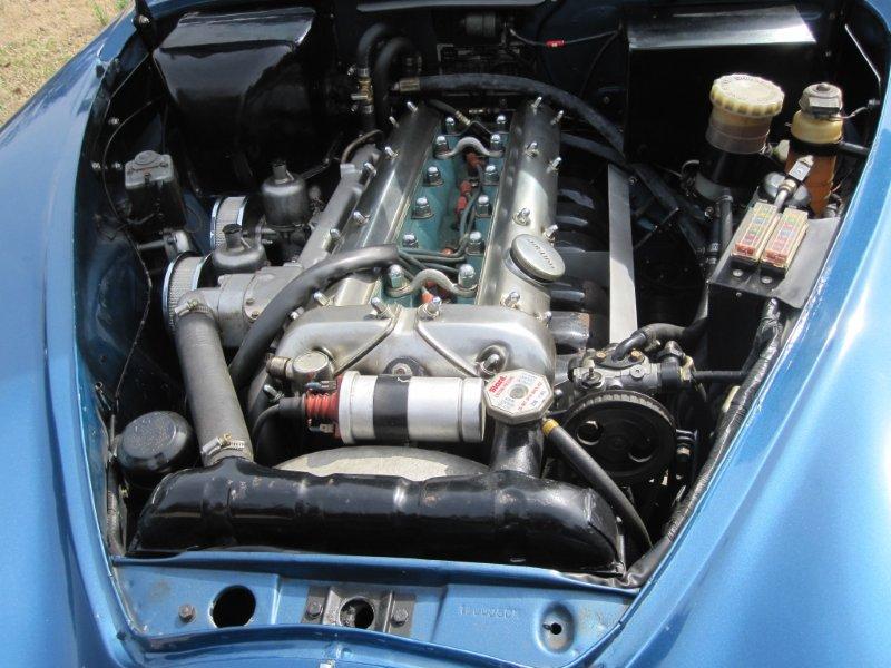

here's a 1965 MK-2 selling for $40k, air conditioned, flawless interior and wood, improved steering system and manual transmission, many improvements for driveability, total restoration, includes many spare parts, concours winner.
Attached Thumbnails How far gone is too far Gone (MK2)-65-mk2-3.jpg   How far gone is too far Gone (MK2)-65-mk2-5.jpg   How far gone is too far Gone (MK2)-65-mk2-1.jpg

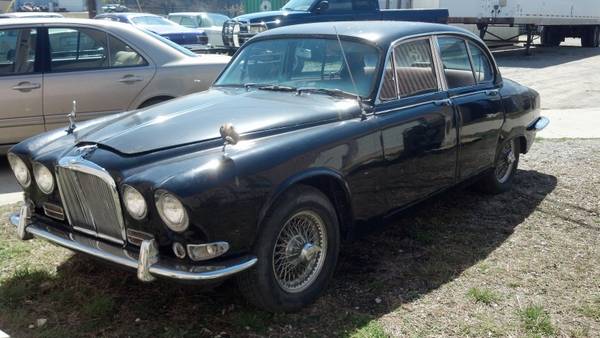

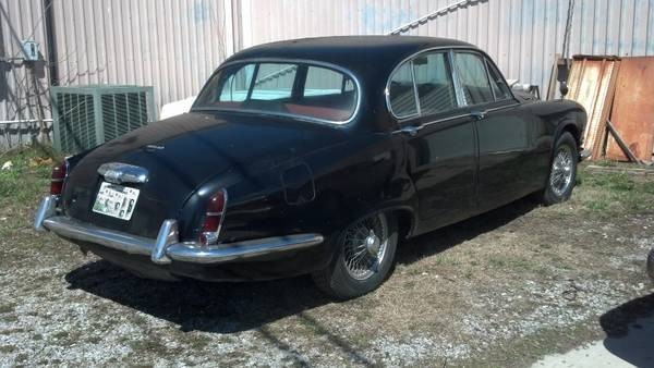

what about a Jaguar 420 ? the rarest of Jaguars, only made for 2 years.
here's one with a Chevy 8 cylinder and modern transmission, a running project car that you can drive while refurbishing it and for sale for less than $4 thousand USD.
Attached Thumbnails How far gone is too far Gone (MK2)-1967-jaguar-420-.jpg   How far gone is too far Gone (MK2)-1967-jaguar-420-b.jpg   How far gone is too far Gone (MK2)-1967-jaguar-420-c.jpg
