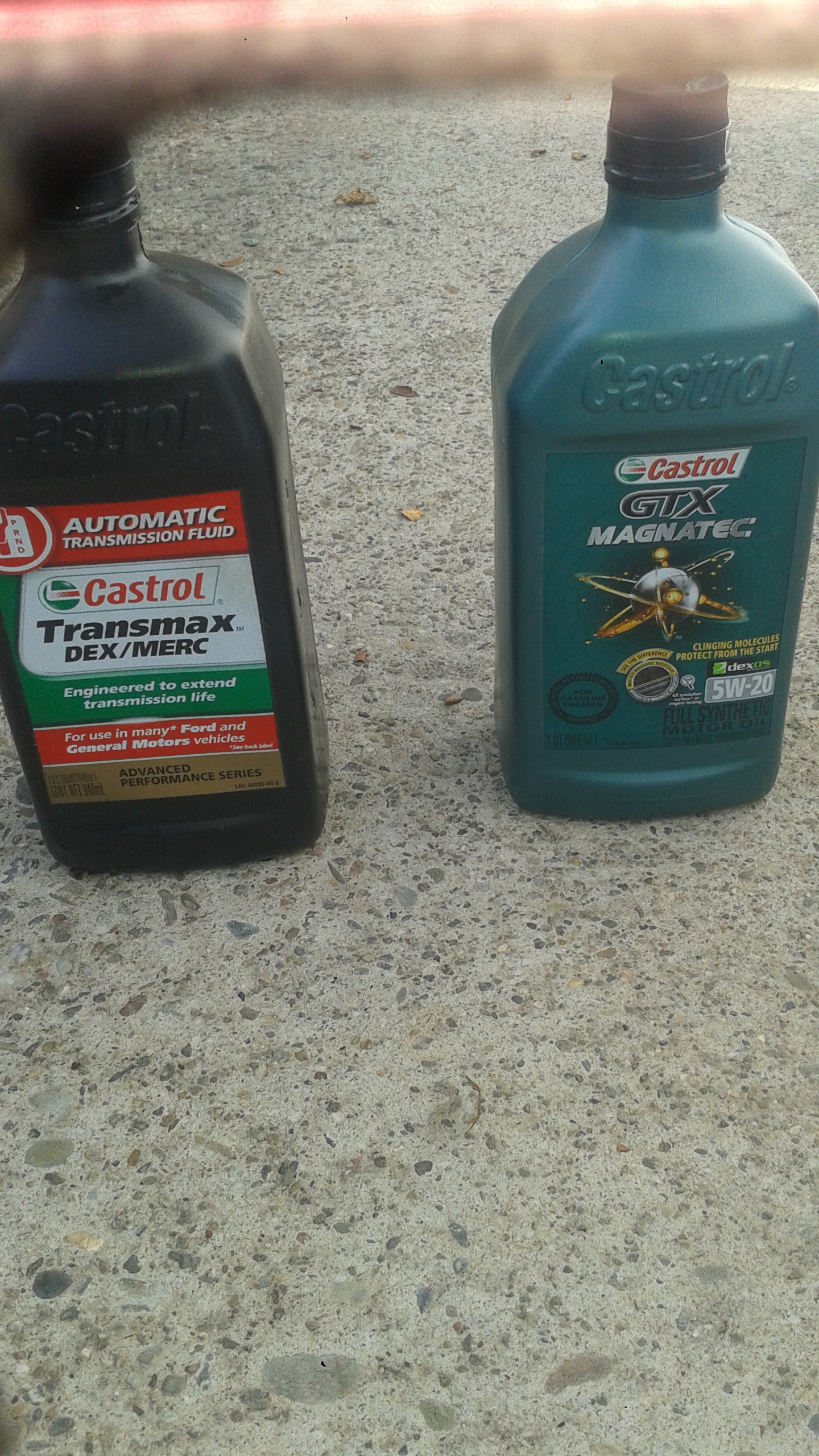

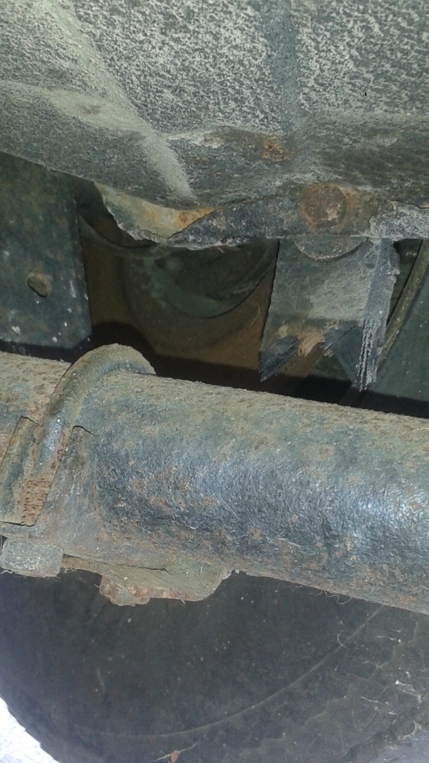

Now before the car is taken to the next phase -- actually taking it out on a public road more than 200 feet --- it is prudent to finish off some basic maintenance on the car.
It was idling okay, but would occasionally stall as it got to higher RPMs. It took awhile, but eventually it was able to maintain higher RPMs when the accelerator was depressed as time went on with a the longer idle. I suspect since it was sitting for such a long time without having been run, it took a bit to clear out build up and just to get everything moving again. But even a neighbor noted the engine sounded strong, loud, and smooth.
When the car started to move into drive, it stalled and continued to do that for a bit, It took constant restarts to get it all going again, but it started easily and took more time idling. When it did start to move, everything seem stiff: steering, brakes, etc. Again I suspect the lack of use is probably the cause.
When the car finally did start to go forward, it seemed like a lot of exhaust came out. It went away, but was odd and a bit scary to see. But it did move forward, went into a cul-de-sac, and back into the driveway.
REQUEST: Please share your perspectives on these points and the other maintenance actions I'm considering ( pics below ):
A) There's oil leaking on the exhaust manifold. So I suspect a valve cover gasket got old and cracked. Hence the leak. I'll replace both sides. But what is the proper procedure?
B) Here's the Transmission fluid and oil I'm using -> Castrol. acceptable? Any respective addidtives to either oil or tranny fluid?

C) A composite brace that holds up the exhaust pipe rotted off. Buy a new one? Repair? Improvise?

If your car has the BW35 unit, it seems the choice of ATF is crucial.
Here is some advice I "lifted" from the Rover P6 forum, as the 3500 Rover in auto form uses the same tranny:
"These gearboxes have some unexpected characteristics liable to catch out the unprepared home mechanic. This article attempts to talk you through some of them.
To start with, the fluid level checking procedure is stated incorrectly in several places in the Rover Factory manual and the workshop manuals. The correct level check is as set out here, drawn from the experience of experts and from the Borg Warner manuals.
First drive the car sufficiently for the transmission fluid to be hot, say 15 minutes. Make sure the gearbox has spent time in all three forward gears and in reverse immediately prior to halting the car, and also run the selector through all gear positions immediately after bringing the car to a stand with the engine still running. This is to make sure that the torque converter and all passages in the valve block, along with the clutch servos are full of transmission fluid. They otherwise drain back into the gearbox sump and give a false reading. Do not switch the engine off. You should then dip the gearbox immediately with the engine running at idle, and top it up to the “hot” level on the dip stick.
The correct fluid level is crucial to gearbox behaviour, having a high or low fluid level will cause harsh, late or early changes and a harsh drive take up.
When topping up the gearbox fluid, you MUST use the correct fluid – ATF-G or Ford spec M2C-33G. Other fluids sold for modern automatics are normally Dextron based and destroy the integrity of the clutch and band friction linings. The gearbox will almost certainly fail after only a couple of thousand miles with Dextron instead of the correct fluid".
I am of the opinion the Castrol fluid you are using (if its Dextron) should be drained/flushed out, lest damage be caused.

I use Castrol GTX motor oil in my older cars. I am a believer that frequent changes is more important than the oil as most modern oils are good. I do include a quart of Valvoline racing oil (same viscosity) in with each oil change as it adds a little ZDDP anti-wear additive.
Looks like your broken exhaust bracket is a simple bolt on fix. You can get that bracket from SNG Barratt.
