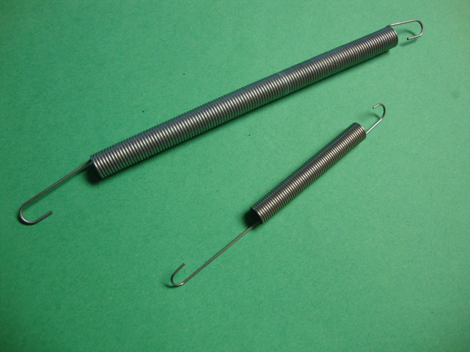

The 2 throttle return springs are very light on these cars & might need replacement. Does the car have a CR of 9 to 1 with 9 to 1 pistons & a slight head shave? What Octane of fuel did you use? If Idle is high and Octane is borderline you can suffer run on. You have got to get the idle to settle below 1000RPM. Max 700RPM. That Wiki article on "dieseling is pathetic".

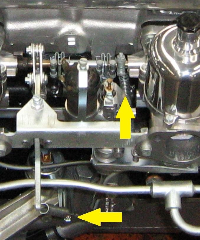

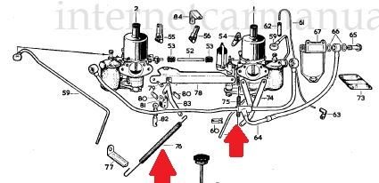

It would be extremely difficult to muddle the throttle springs. They vary considerably in length. Short top location, long bottom to oil filter housing bracket. Getting these cars to settle to proper idle requires every point of the linkage to be nice & free. My 8 to 1 CR engine will run on if it does not settle to correct idle speed. I won't use the language used by a colleague, criticising the linkage on the Register.
On no account use stronger springs. You will increase carb wear.
