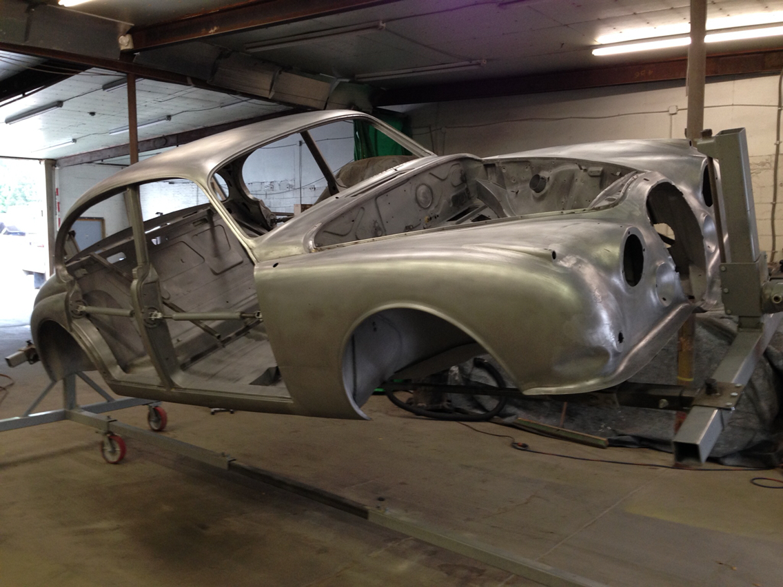

I know how lucky I was to start with this MK2 every time I look at this thread. You are a very brave man.
