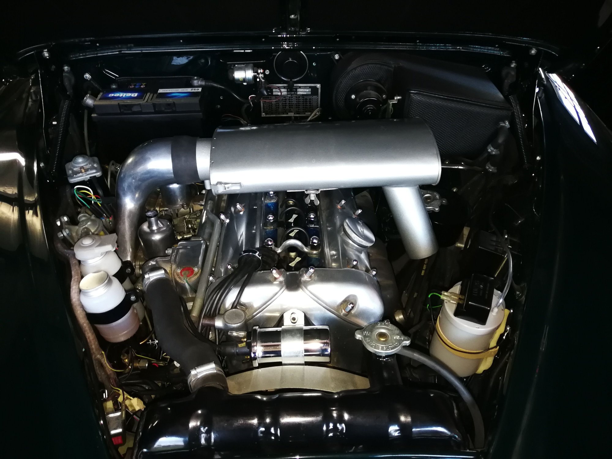

Yes ~ I hate those non original look alloy radiators (made in China). I wanted the original look but double the cooling capacity. My engine is kept up to temperature by the thermostat in our hot conditions. Northhampton Radiators makes an exact replica of the original but far better core & all Brass.

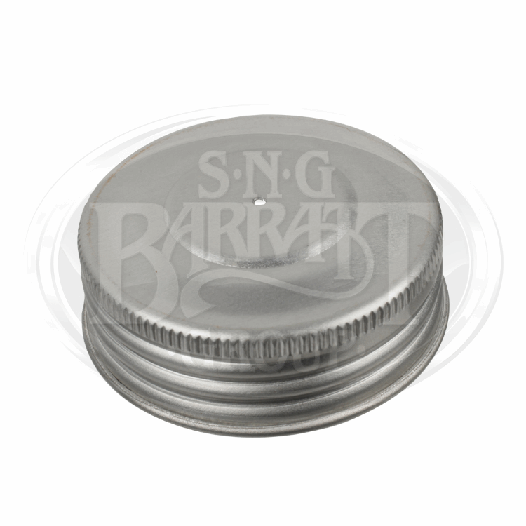

Work still in progress at this time & many corrections made after this. Even the clutch fluid reservoir lid is now correct.

e.g. corrected to this which is now available.

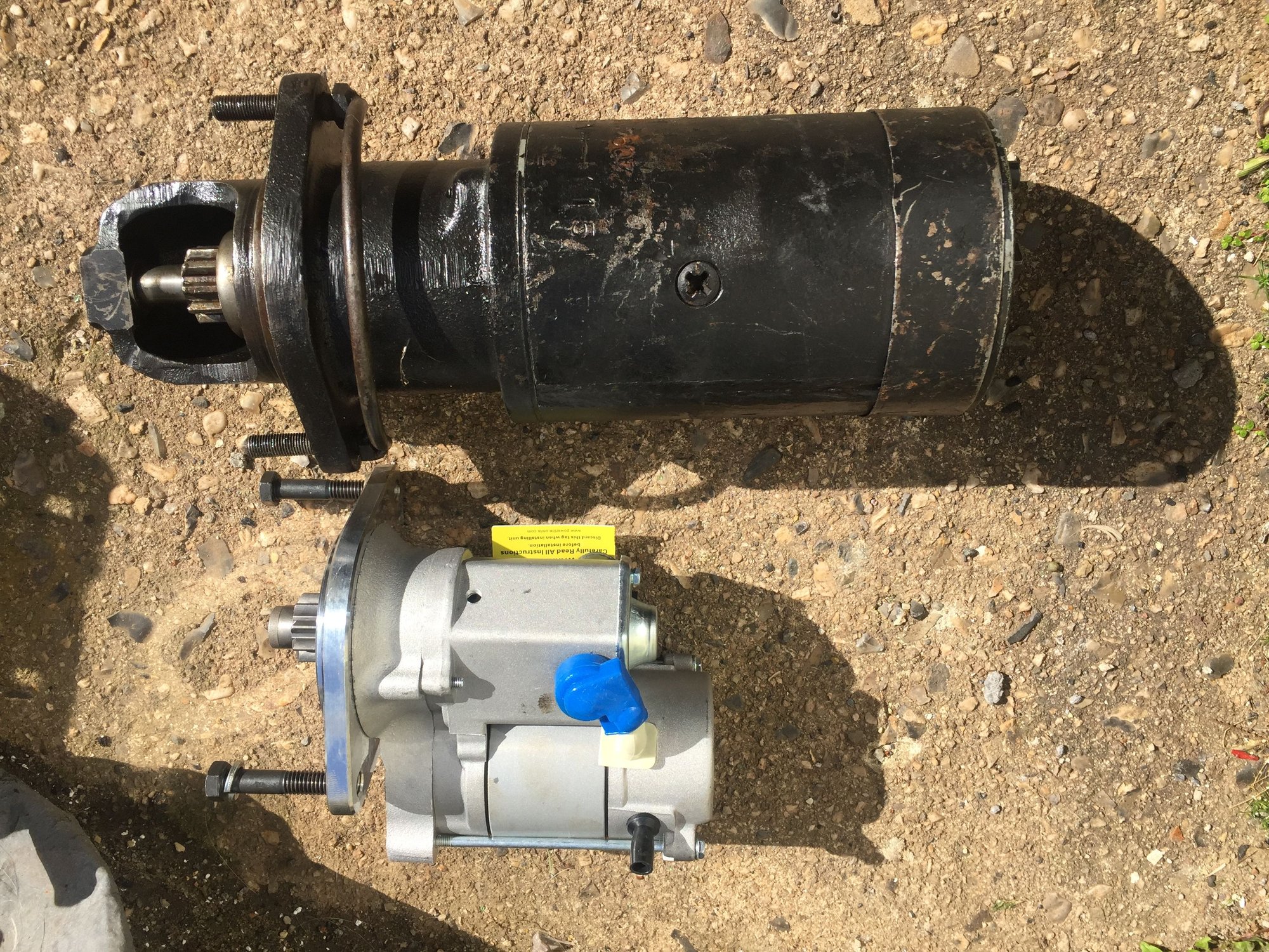

Getting back to the starter motor and to add to the confusion, Martin Robey, in contrast to SNG Barratt, lists a different part number for the upgraded, high torque starter for the 2.4. And several suppliers list the 'slim line' upgrade at about the same price as the non-slimline (wideline?).
Glyn - your engine bay! I don't imagine the S type at its first motor show could have looked as good. Is one of the spark plug leads the wrong side of the tube from the engine breather?

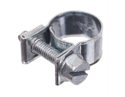

LOL. The rubber breather elbow hose was not connected at the time. I was waiting for NOS correct Jaguar clamps still in their Jaguar Bag from the US. None of mine passed the smell test.
They are this style of clamp.

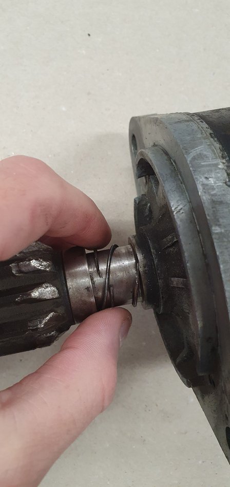

That is indeed the same block as mine and you can see that it doesn't fit because like the 3.4, with the 2.4 there is no space above where the extra sticking out part of the new starter would fit.
I think I am going to fix the old starter. I think when the spring is replaced that the gear will pull back.
Is this theory right or is the spring not responsible for putting back the starter gear so that it doesn't stick inside the gear on the motor?
When cleaning the spring I noticed that a part of the spring was broken off, hiding under some cap.
If I replace this spring then the problem would be fixed right?

I knew the 2.4 block was shorter than the 3.4/3.8 but did not realise how significantly shorter it was.
As for the spring I gave mine to a friend to repair a couple of times before I went to the new high torque starter so I have no idea how it actually works. I still have the old one in the garage which I would willing let you have but it is for the Auto gear box so will not fit your car. Different design.

Looking at the lucas information for the different starters the manual transmission starter is significantly different to the automatic one.
If the motor spins well then the first thing to do is check that the bendix is not all gummed up, I usually clean them with petrol to start with and finish off with thinners so as not to leave any oil residue that might attract dust/grit.
The teeth on the OP's starter look well past their prime, i'm not sure how you get the end off that type but you need to be careful as the spring probably has some considerable pressure in it. On minis which were similar we had a special tool to compress the big spring so we could take the end off. If the OP does want to try cleaning it and can't get the pinon off then I would at least make sure that any burrs were removed from the teeth in case its causing it to catch and stick in.
For future information the pinion on the automatic starter can be dismantled without any special tools.

i've just reread the first post and the implication is that the problem was that the bendix simply wasn't disengaging properly. that's usually not too hard to fix once the starter has been removed.
looks like the bendix pulls INTO the housing when activated rather than being thrown outward like that on those that i'm familiar with. in any event, IME, they are all returned to their resting places via spring pressure. if the problem IS related to the bendix not disengaging properly, then, ya, it's probably the broken spring. should be easy enough to fix i would think.

If you are considering putting the original starter back in, I urge you to take it to a workshop as S Type owner suggested.
Apart from the broken spring repair they could also replace the bearings, skim the commutator, fit new brushes etc.
Then you should have a good reliable starter for much less than the proposed expensive replacement.

I have been to more hassle then I imagined it would be and I am not sure what problems that the original starter will bring with the high pressure spring.
Although I think that the small spring causes the gear to get stuck into the engine and the starter motor doesn't have the power to turn the engine on.
Can I somehow replace the old spring without taking the starter apart?
Thats very kind of you Cass that you are willing to let me have it but that one isn't going to fit unfortunately.
Your right Homer that the gears look a bit messed up but I don't think that it needs to be replaced yet. When it's time to replace these I can better take the gearbox off and replace the starter gear inside the engine as well.
To be honest I am not ready to take that extra mile since I kind have no room for the car to stay that long

rob_mi
Just get the starter motor into proper workshop for overhaul.
Bite the bullet and spend the money as I suspect you may not have the expertise to repair it.
My apologies if this sounds offensive but there are times when our enthuasim is just not enough to make an effective repair.
