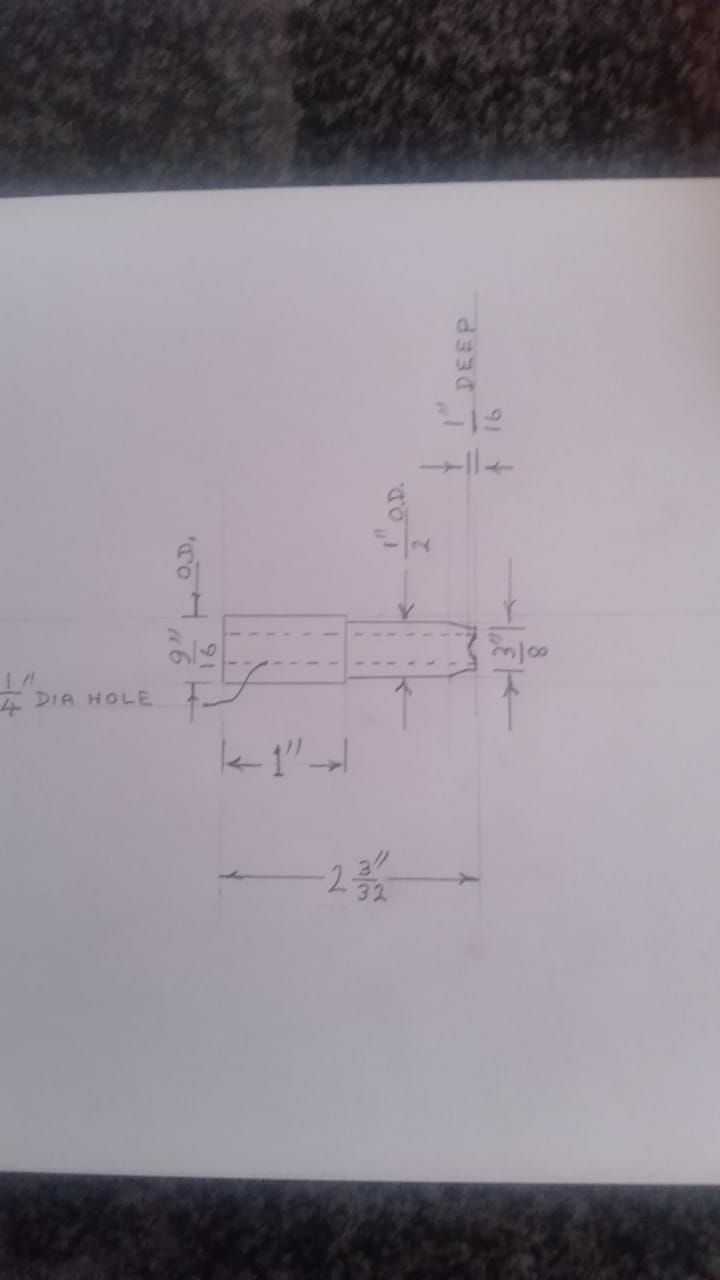

The most likely answer is the spigot on the end of the trans shaft was left off. Check the parts manual and look for the part --what you describe fits this perfectly. You will need to remove the trans and replace this---it directs the pressure to the converter so lock up in direct may be obtained! Don't ask how we know!

Thank you for the speedy response to my two previous e-mails. From enquiries that I have made, I believe that some modification or replacement had possibly been made to the oil transfer tube currently fitted to the automatic transmission of my Jaguar. My request is whether you could trace a drawing with specified sizes of this component. The parts section of the Jaguar Heritage DVD, JHM 1117 that I possess does not provide sizes on drawings, or fault finding. Local transmission service providers are not able to help me either. (Johannesburg, South Africa.)
The reference numbers of my car, 1964 Jaguar 3.8 MK2:
Engine No. LC9741-8
Transmission DG-250-MJ
Serial No. JBC 18316
Tube in end of Main Shaft for Oil Transfer (J.20-392)
Do the workshop manuals that you list include fault finding and repair methods for the automatic transmission of the model/type described above?
We have again separated the transmission box and torque converter, then removed the transfer tube to be photographed and made a drawing with actual measured sizes. We also checked to ensure that the tube provided a firm fit through the “o”ring at the centre of direct drive clutch. (Photo and drawing attached).
Is there a way that we/your Enthusiasts Forum can determine if this part is of correct size to be expected to operate as necessary?
Should we try enlarging the 1/16” hollow at the narrow end of of the tube to allow more transmission fluid to pass through?
Your input is appreciated. Our testing effort has thus far not provided success.
