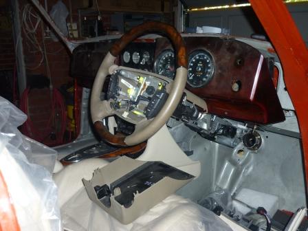

A long time ago that I don't pass on this topic, and it is with pleasure that I found some similar projects. Primaz, Is that your car ahead? I can't wait to see the pictures.
Always looking for the ideal engine, I advance the body work these days. I'll start the chassis before I really look at the engine. So for you I should be able to mount the gear end of the s-type on my mk2?
I am really impressed with the work done in the cockpit.
