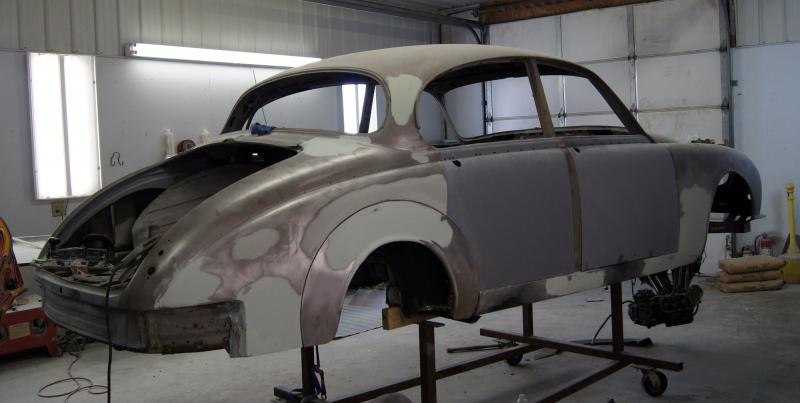

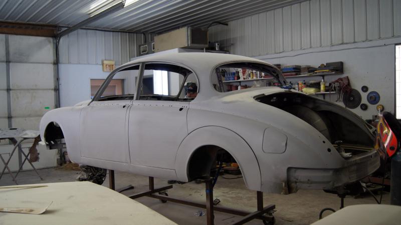

I still am a couple months aways from completion and will post more pics later but I am taking pictures thru this process....

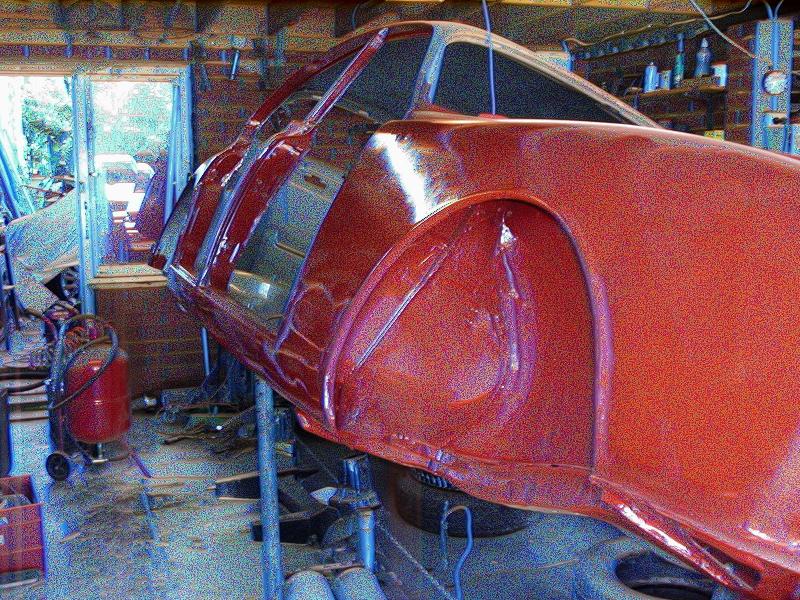

I slowly started bodywork, i want to refine the mk2's drawing by remove bumper (front and rear), erasing all chromiums..

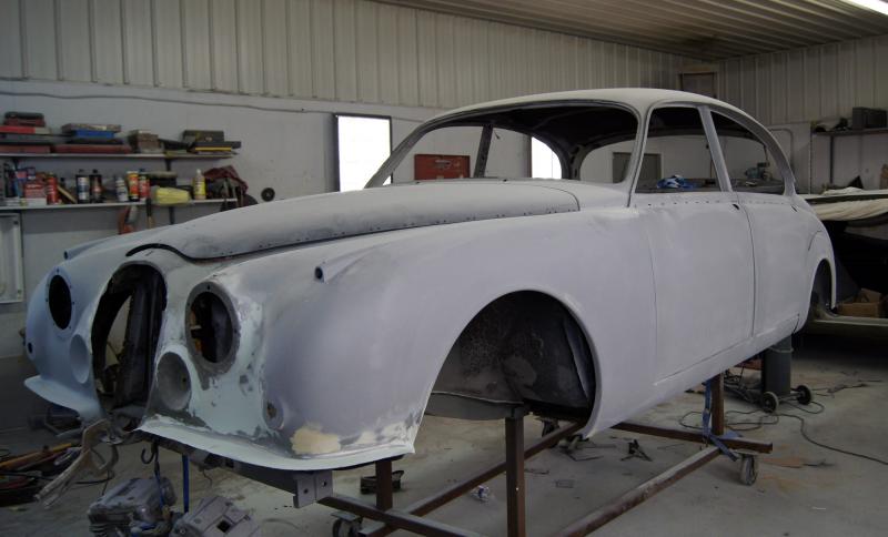

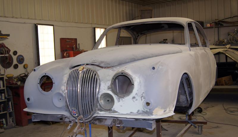

We should be moving along with the engine mount later this month and I will post pictures to show you that it will easily fit a V8 with no changes at all to your stock hood.

We are hoping to get the Jag ready for painting the undercarriage in January so we hope to have pics to post as the engine has to be mounted temporarily to ensure we have all things ready as well as the interior welding for the new seats before the car can go to the body shop for the undercarriage painting, etc.
I am impressed at how far you are stripping the car, that is a large amount of work but I am sure you will be so happy when it is done! I was fortunate to find a 3.8s that does not need any real body work. You might also want to do the same thing I am doing to prevent rust which is I am stripping the entire bottom undercarriage to bare metal then painting the Por-15 metal prep paint then their chasis black paint. That will ensure your Jaguar will never rust again. If your car has rust I recommend to get it bead blasted to take out every minute rust so you can repair it properly then apply the Por-15. We are using that also on all the inner wheel wells and engine compartment.
