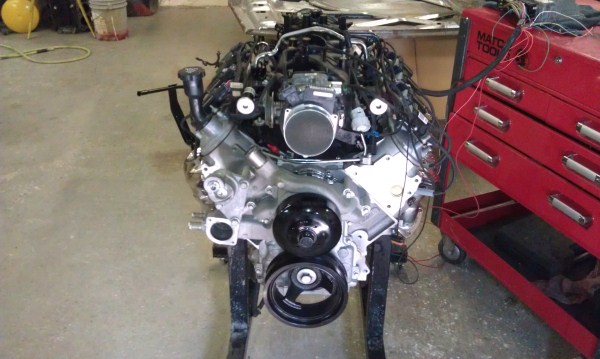

I just pulled my motor and transmission, getting ready to inspect and prepare it for new body.
Attached Thumbnails Jaguar MKII Engine swap-20120308_155439.jpg   Jaguar MKII Engine swap-20120307_184454.jpg

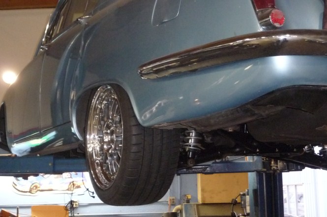

Here are some pictures of the 17" x 8.5" rims running 245 diameter tires on my 3.8s. It does clear but to give it more room I am having the fenders rolled. That eliminates that sharp lip and will look clean and stock yet give you increased clearances. It is funny that so few Jag owners even attempt to do simple custom offset rims/tires when it can make such a huge difference in the handling performance.
Attached Thumbnails Jaguar MKII Engine swap-p1070563.jpg   Jaguar MKII Engine swap-p1070564.jpg
Way to go Mish! I know how much work that is and am glad to see it progress further.

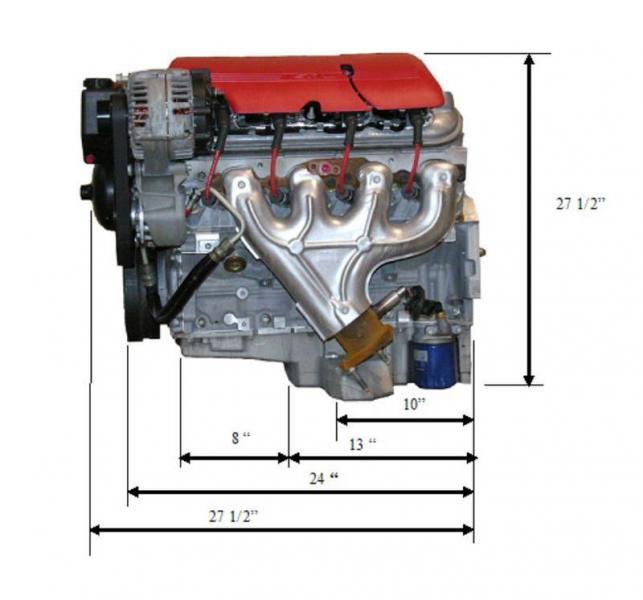

Hello to all
If you go to the MWS site (MWS International) it has all the wheel sizes they can be fitted to the different models. It also has the wheel sizes fitted to the beacham jag, plus an explanation of inset,outset and spacing.
Couple of pics showing ls1 engine size. (these were obtained from the ls1 tech site)
Hope this helps.
Glenn
Attached Thumbnails Jaguar MKII Engine swap-chevy_ls1_measurements_side.jpg   Jaguar MKII Engine swap-corvette%2520ls1%2520dimensions.jpg

Originally Posted by glennd
Hello to all
Hope this helps.
Glenn
Glenn, I went to that link and that is a cool guide but it is just for stock rim/tire sizes as the widest tire they show is a mere 205. Anyone interested in the right offset for stuffing a 17" x 8.5" 245 tire go to my posting on Beefing up the rear suspension - https://www.jaguarforums.com/forum/m...g-tires-63437/

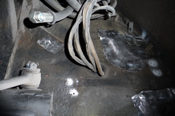

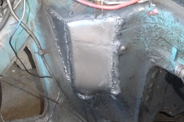

Default Pictures of getting the engine bay ready for paint...
The only bad part of my Jaguar was the previous owner really hacked up the engine bay so we are spending a lot of time to weld up all the unecessary holes, sand them smooth, seal and prep them for paint so you will never see any clues that there was an issue before. When you see the amount of welds and we still have some more minor ones to go before we paint you can get an idea of bad it was before.
We still have a lot more welding to do, a lot more sanding and grinding of the welds, and sealing before we are ready to paint but it is looking so much cleaner.
Attached Thumbnails Jaguar MKII Engine swap-p1080050.jpg   Jaguar MKII Engine swap-p1080053.jpg   Jaguar MKII Engine swap-p1080059.jpg   Jaguar MKII Engine swap-p1080060.jpg   Jaguar MKII Engine swap-p1080061.jpg

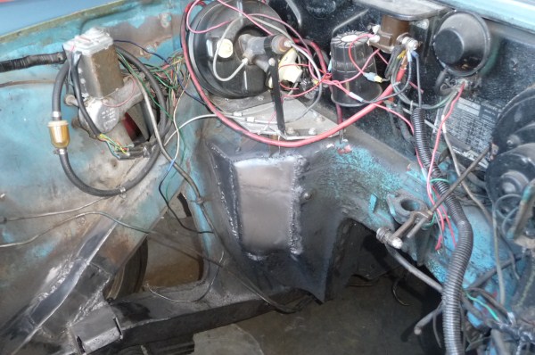

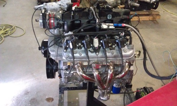

Default Modifcations to give room for the LS1 GM V8
The General Motors modern aluminum block aluminum head fuel injected motor is a great power plant with stock form already getting 300-350 HP. My LS1 has a mild cam, upgraded computer harness/programming, headers, and mild tweaks that bumps it to 450 HP yet still will get great fuel economy.
This 5.3 liter motor did take some modifications to get it to fit. Here are some pictures of the passanger firewall that needed to be cut and modified. Once we finish grinding the welds, sealing it and then painting you will never know anything was cut or modified. Also neglible leg room was sacraficed as there is plenty of room for a tall person to have great leg room.
Attached Thumbnails Jaguar MKII Engine swap-p1080009.jpg   Jaguar MKII Engine swap-p1080010.jpg   Jaguar MKII Engine swap-new_engine2.jpg   Jaguar MKII Engine swap-new_engine3.jpg

Default Engine bay getting closer...
The engine bay had plates welded so that they are flush and look like there wer no holes cut. It is a rather slow process as the grinders, etc. can only do so much then the rest is all hand sanding, etc. Most areas are ground smooth with a small amount of filler to give it a new seemless look. We should be able to move to the rolling of the fender wells soon. There we had to fabricate our own fender roller in order to keep the factory curvature but that was not too hard.
