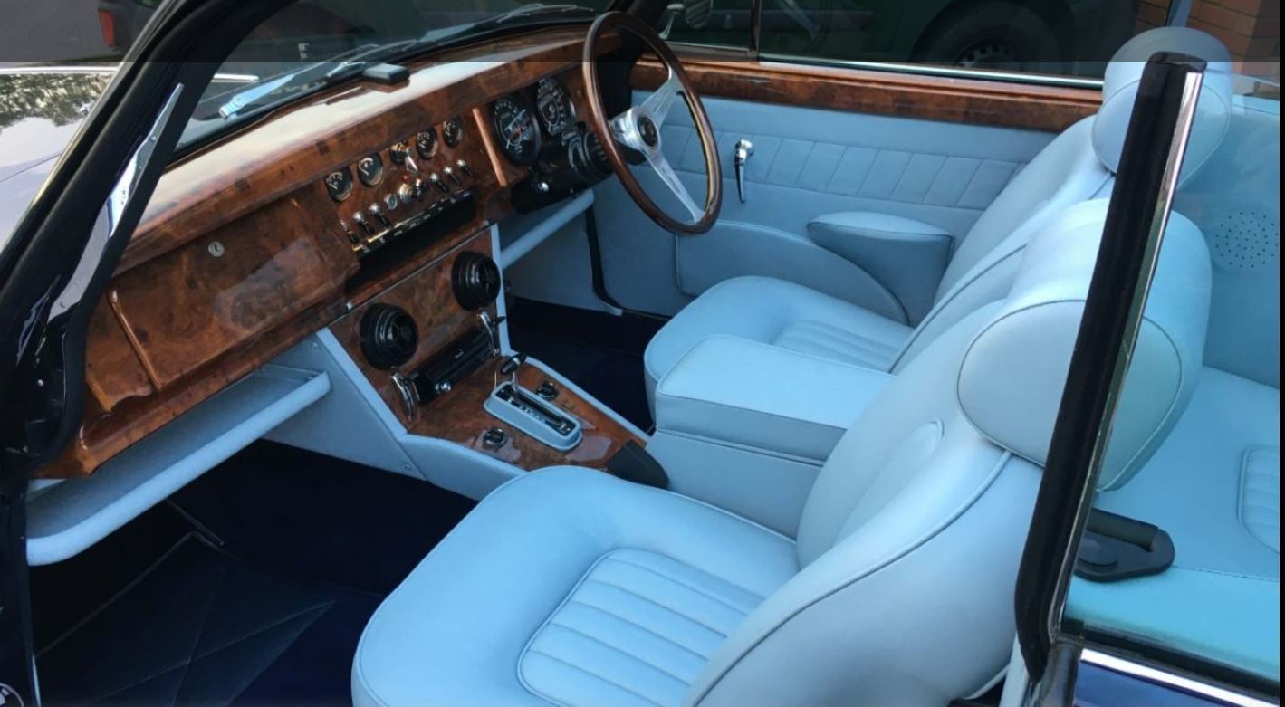

XJ-6 center console or "floor" shifter,
is this what you saw? Then the car probably has a BW65 or BW66 transmission, even a GM 400 R is possible using the same shifter.

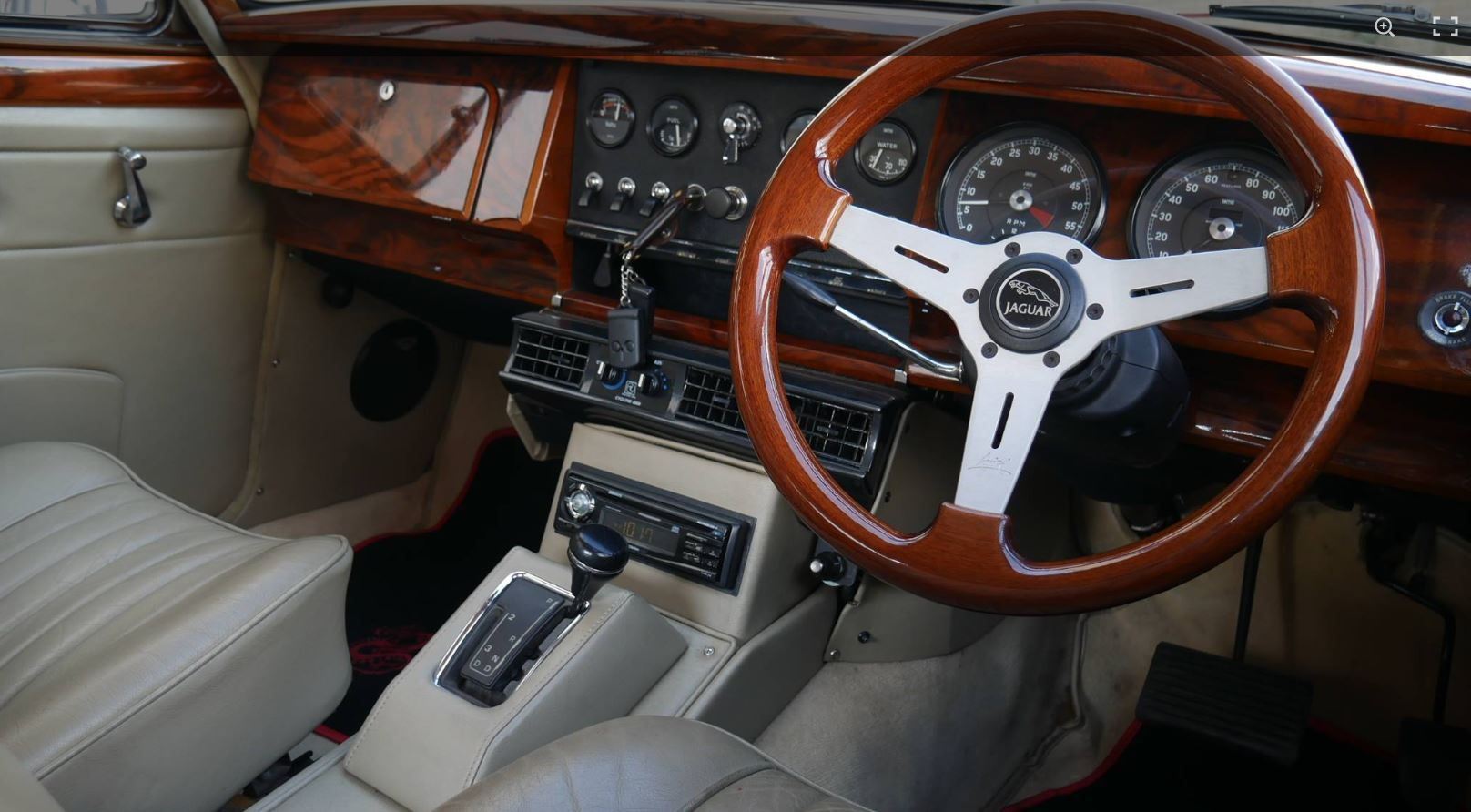

Appears that the center console was also modified. The console is shorter. No heat vents at the end as well as looks much taller than original. I believe Vicarage also used a console mounted gear selector but as I recall it sat on an unmodified console. Could anyone post a Vicarage modified MK 2 with this selector? Thanks.

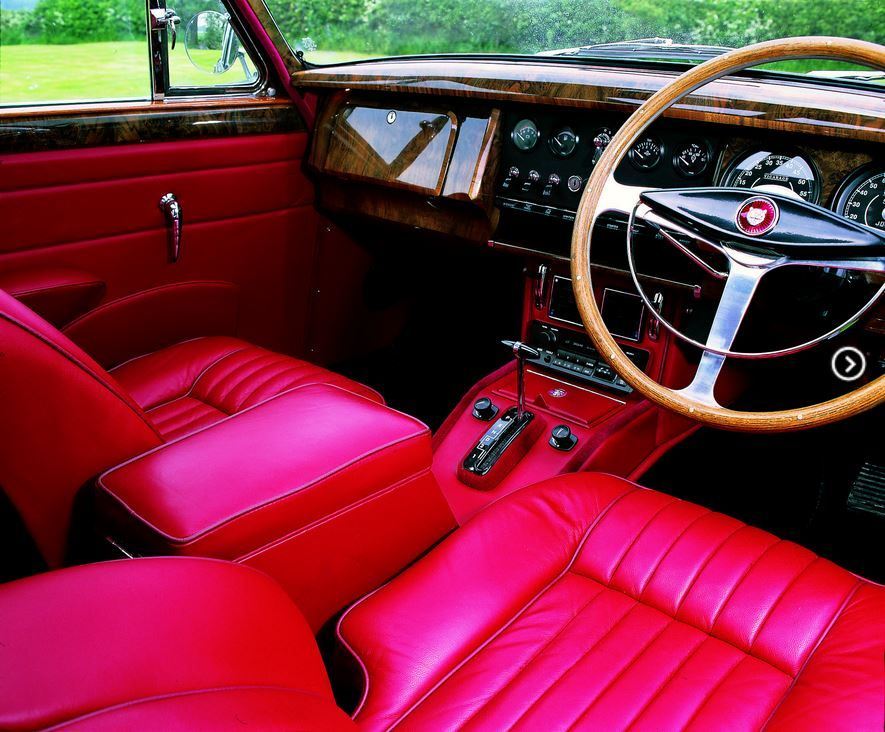

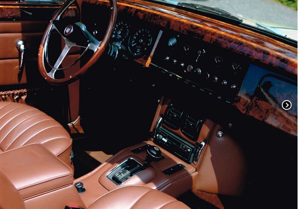

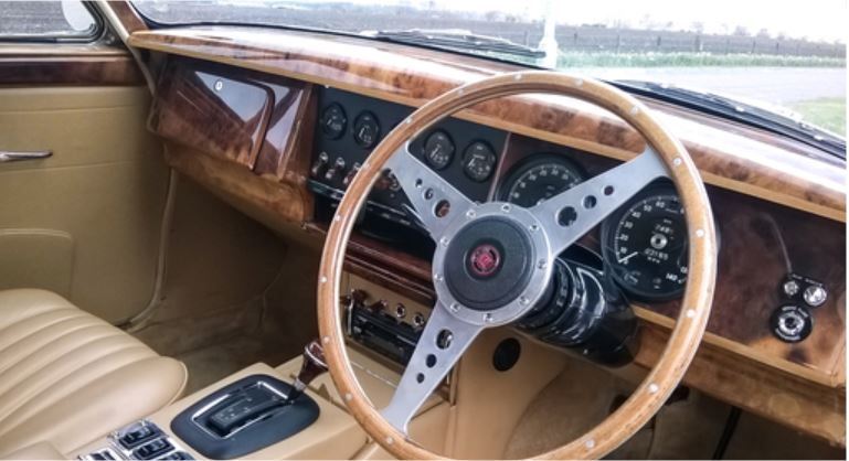

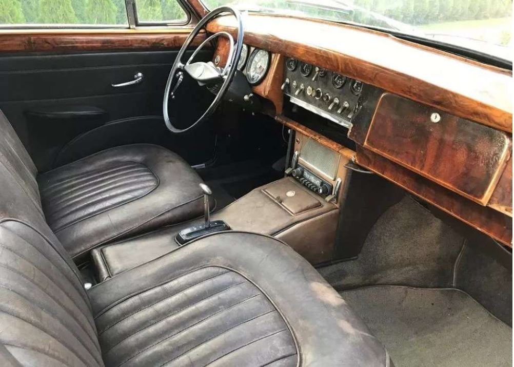

Most Vicarage cars are manual.
These are the best pics I have of Vicarage auto consoles.

I think the pictures above show a Series 3 XJ-6 automatic shifter normally used with the BW66 automatic transmission and a XJ-40 automatic shifter used with the Getrag ZF automatic transmission that has a Manual "Sports" setting. I have no clue what Vicarage ever did.
