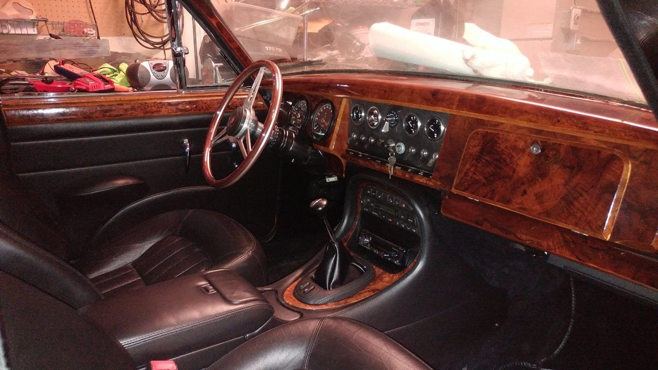

The conversion to a floor-shift is 100% do-able, and may not even be that hard if prior experience is any guide. My only reason for asking about a DG250 shifter specifically is that A) It would have the correct shift gate and B) It would likely be a "period" piece - if it existed.
Since it doesn't though, and assuming I do the swap at all, I'll very likely try use a cable-operated Lokar shifter, as with the picture below (you'll need to just imagine a stock console) The advantage is that if done properly, the interior will simply look like a standard interior, with a manual. Closer inspection will reveal it to be an automatic obviously, and to my knowledge Lokar does not make a shift-gate that will match, but I expect there is some adjustment in the shift positions and a lot of flexibility in mounting solutions when using a cable - so its a potential solution. Several other classic American cars also used the PNDLR gate and so another option would be to marry the shift gate linkages (hidden by the console) to a standard jaguar shift handle, and assuming space or a cable link to the transmission, voila.
Still - I'll probably just leave it alone, lol.

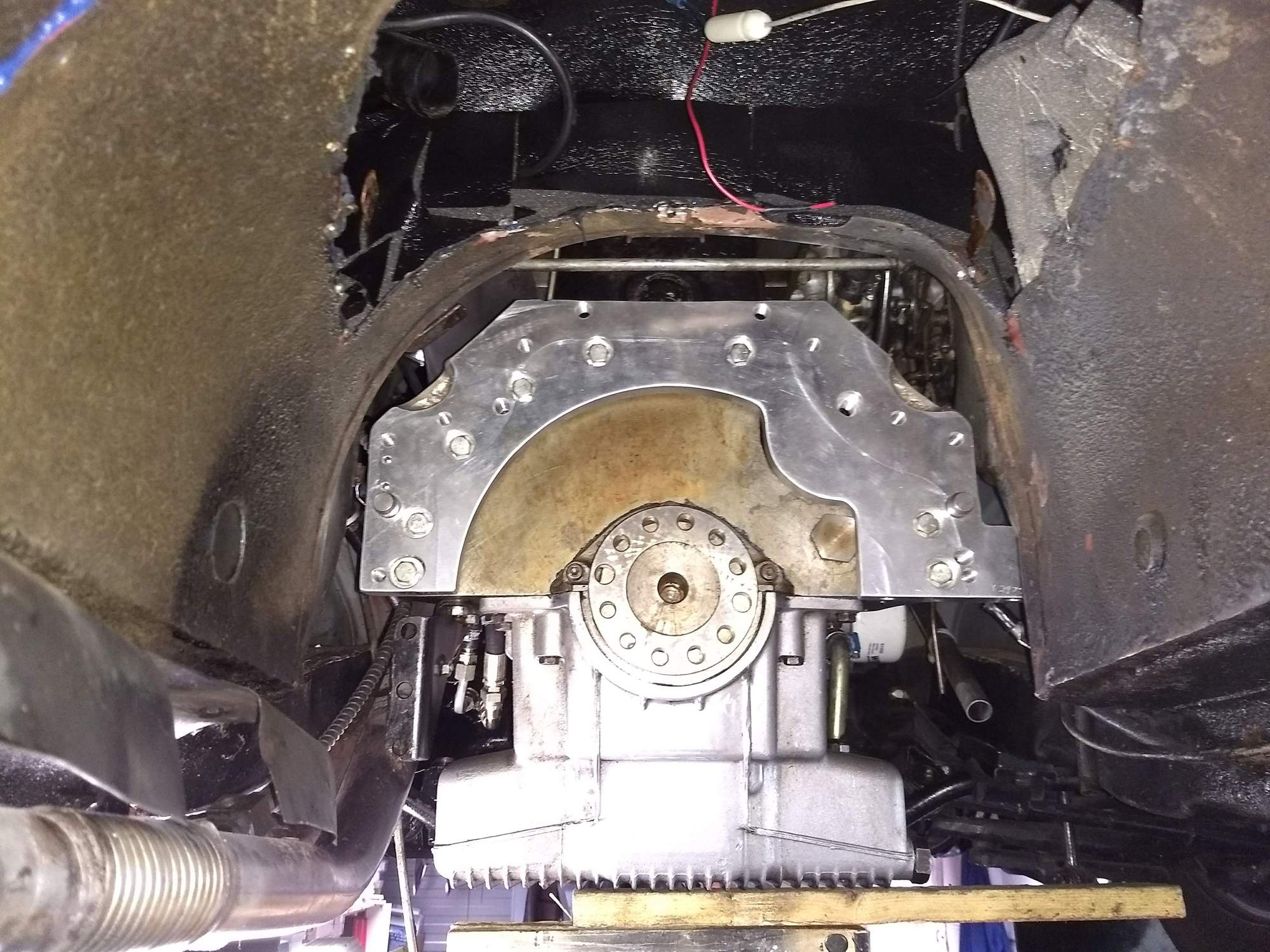

You can install a t700R4 with the engine in place, I have done it that way.
You need to cut a hole in the tunnel. ( but did that 15 Years ago to replace a defect torq converter of the DG250 )
adaptorPlace installed
I still have a DG250 in my XK140FHC.

Wow. John's Cars website seems sure it can be done in 15 hours, and the only modification is a slight dent in the tunnel for the angle speedo drive. Do you think this would have been possible if your tunnel had been intact?
Old Jun 16, 2020 | 08:16 AM
jaguar38s's Avatar
Joined: Jan 2011
Posts: 137
Likes: 25
From: The Netherlands
Took me longer than 15 Hours, more about 30. But I took it easy.
With the tunnel intact looks difficult to me, How do you expect to reach the upper bolts of the bell housing?
I did not use the angle drive, instead I made 2 cm hole to the side of the tunnel using a grommet, and the speedo cable is going under the floormats to the dash.
