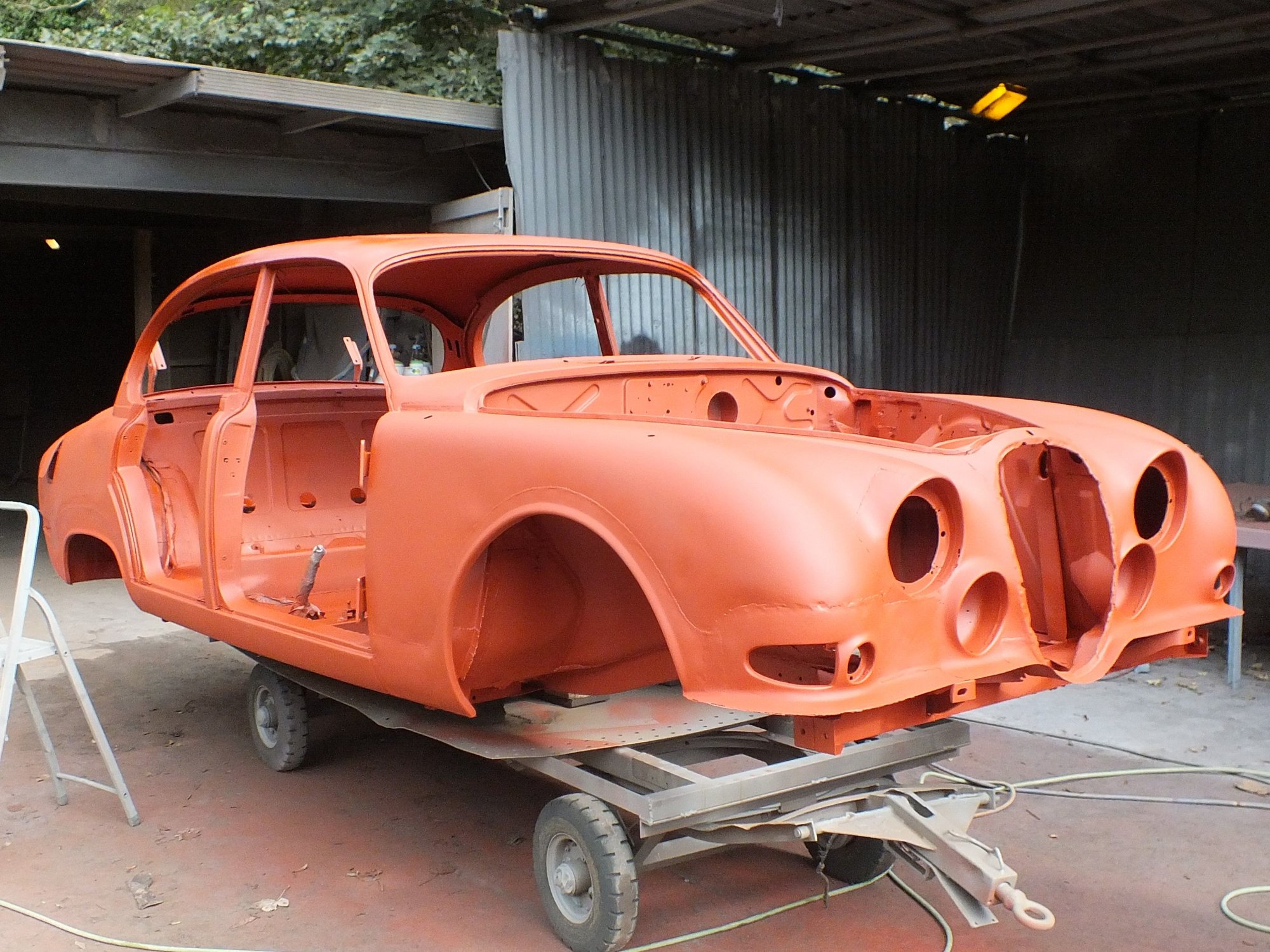

I had mine grit blasted and as said there were bits everywhere but I managed to clear most of them out over a day with an air gun.
When I went to the blasters they asked me if I was sure that they go ahead and then preceded to tell me a story of a friend of mine who was rebuilding a Messerschmitt Tiger four wheeler. They asked him the same question and he gave them the go ahead but when he returned they handed him the body back in three parts which had previously been held together with filler and rust. Tim finished the Messerschmitt fitting all new floor and body panels to perfection as he always does and had a really sound car. Without the grit blasting another restorer might have built a death machine just waiting to break in to three.
Shell waiting to go in to the blasters.
Shell after blasting with a red oxide paint protection to be transported back to the workshop.
