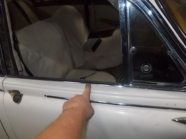

I have a very late Mk 2 that I am in the process of restoring. The car is weeks away from heading out for paint and I have a few open items to take care of before the car is painted.
My biggest issue is the chrome bead that sits on top of the door, just in front of the glass, on all four doors. Very late in the Mk2 production run, this bead was changed from a clip-on decorative bead to a screw-on bead assembly that also holds the rubber window squeegee/seal. It is a much more complex piece than the earlier cars and it appears to be the same as the 420 and (probably) the 240 and 340 models. The part numbers for the earlier and much more common style are BD17093,4,5,6 and the part numbers for the later style are BD25962,3,4,5.
- Does anyone know where I can find the later style pieces? I have the originals but the chrome is very bad and the RH-F piece is mangled. I have looked everywhere. Any place that claims to have them (SNG, XKs, Welsh, etc) actually substitutes the earlier parts. I would rather use the correct parts if I can find them but I am about to give up.
- Assuming that I cannot find the correct parts, does anyone know if there is any difference in the doors? Obviously the bead mounting holes will be different but wondering about the shape of the doors in that area.
- Also assuming that I cannot find the correct parts, does anyone have an extra door, without the chrome in place, that they would be willing to take some measurements from? I will probably have to drill the holes in the top of the door for the earlier trim but I don't know where, how many or how big the holes should be.

Those Chrome trims that hold the weather strip (moleskin) against the glass are no longer made & are rare as rocking horse you know what. Your best bet is to rechrome yours as I had to on my S Type & locate a few undamaged ones. They are location specific. You are going to have to find a replacement for your mangled one or find someone to repair it. People frequently damage them being careless taking frames out or glass out of doors. If you decide to go to the older style trim you are going to have to find a way to attach an external whisker strip on each opening/winding glass. Older Mk2's had a whisker strip inner & outer. Late Mk2's like yours, S Types & 420 had inner whisker strip & outer rubber moleskin/wiper.

I think the S-type and the 420 had the later trims, (I actually bought new ones from a Jaguar main agent in the 80s). Doors are the same for this part. They are made of brass, so can be replated, therefore try to find used ones off any of these models or the 240/340 that also had them.The later trims with the seal are far better at keeping water out of the doors, the old ones just let it pour in like Niagara Falls !

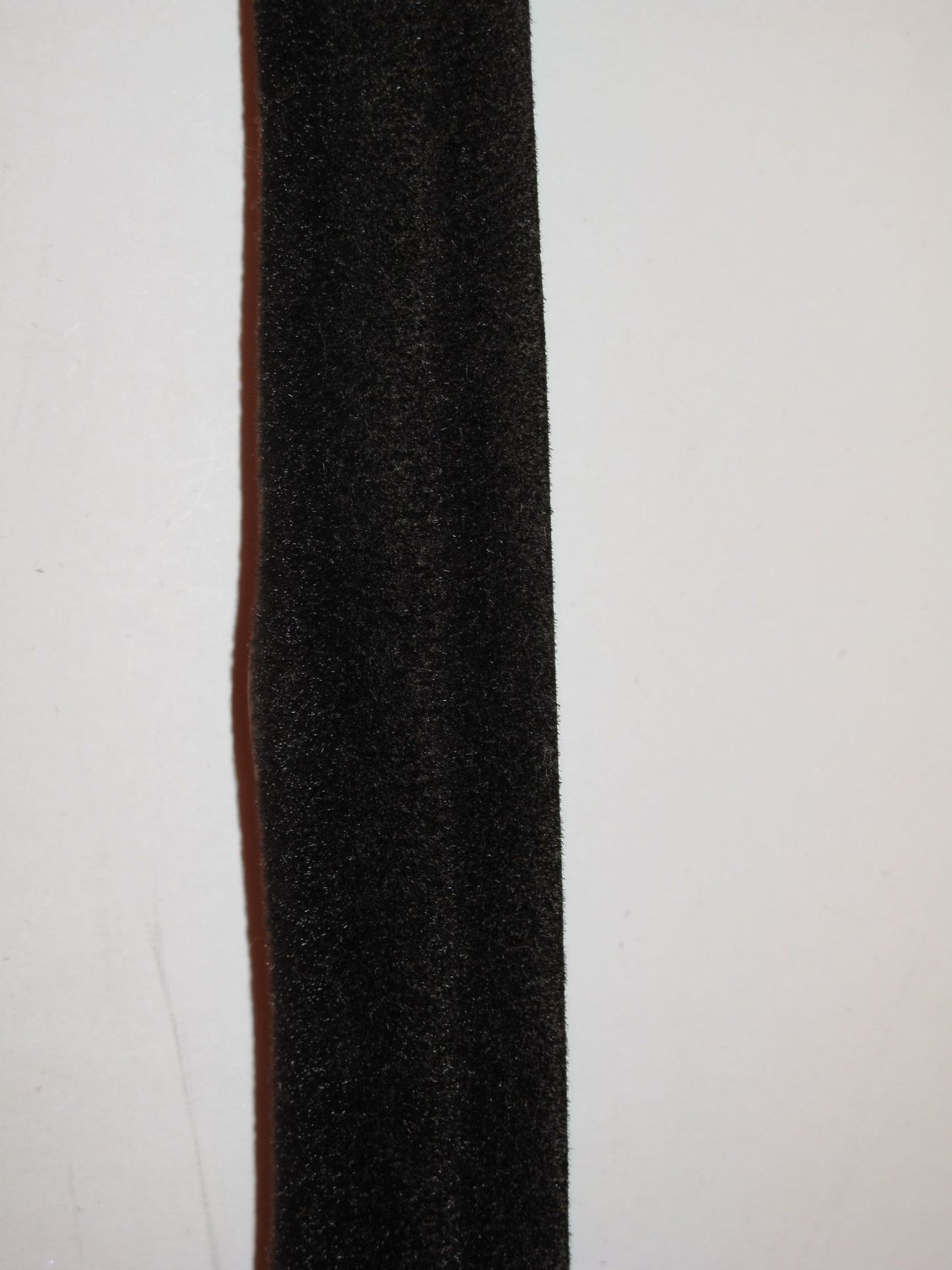

This is what I used from Barratts. Perfect fit & virtually identical to original removed. Also listed by David Manners.
Cross section.
Pull into slot in chrome beading with lots of soapy water or any rubber safe lubricant. Some stretching will occur. Allow to shrink for a few days until final trimming to length of beading.
BTW ~ If ordering from Barratts quote P/N. Half their staff don't know they have it off the roll or at all.

May 10, 2019 | 06:57 AM
Where did you get yours from? That profile I show is a snip of the actual material Barratts supplied me. As others have said if the profile is wrong it's a real battle to get the tongue into the slot in the beading.
We just slowly worked it into the slot patiently by hand. Soapy water, Vaseline or rubber grease will help. It's never going to be an easy job.
