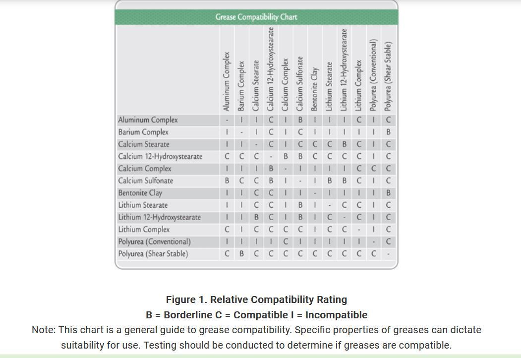

Jeff is spot on with his entire post. However if you find a sloppy mess in a wheel bearing it could be due to incompatible greases having been placed/mixed in that hub.
Never mix grease types when topping up a hub. Rather clean the bearing & hub & regrease completely. As an example a Calcium Complex grease is completely incompatible with straight lithium greases & will create a runny slop in the hub. Straight Lithium Stearate & 12-Hydroxystearate greases are the most common general purpose greases in an NLGI No 2 penetration on the planet.
