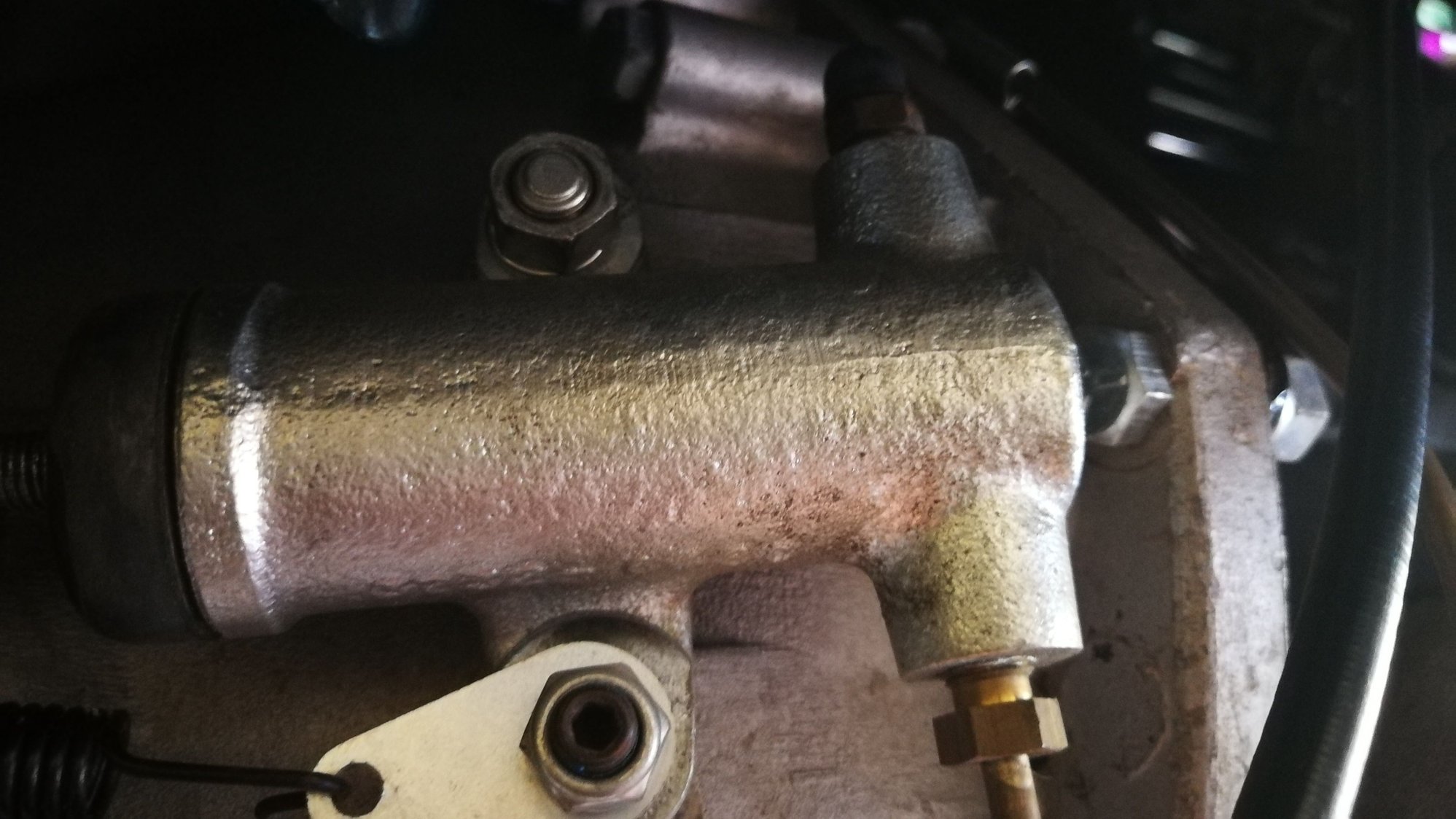

As Peter says if all is correct these cars have a beautiful clutch action. I am most impressed with my 9.5 Diaphragm unit (Genuine Borg & Beck). Just never ride the clutch as they have carbon thrust bearings & ensure correct adjustment. (dependent on slave cylinder fitted). I have gone belt & bracers with mine. The self adjusting slave cylinder & external spring to increase thrust bearing life. The slave cylinder is stainles sleeved as are all brake calipers & master cylinders.
