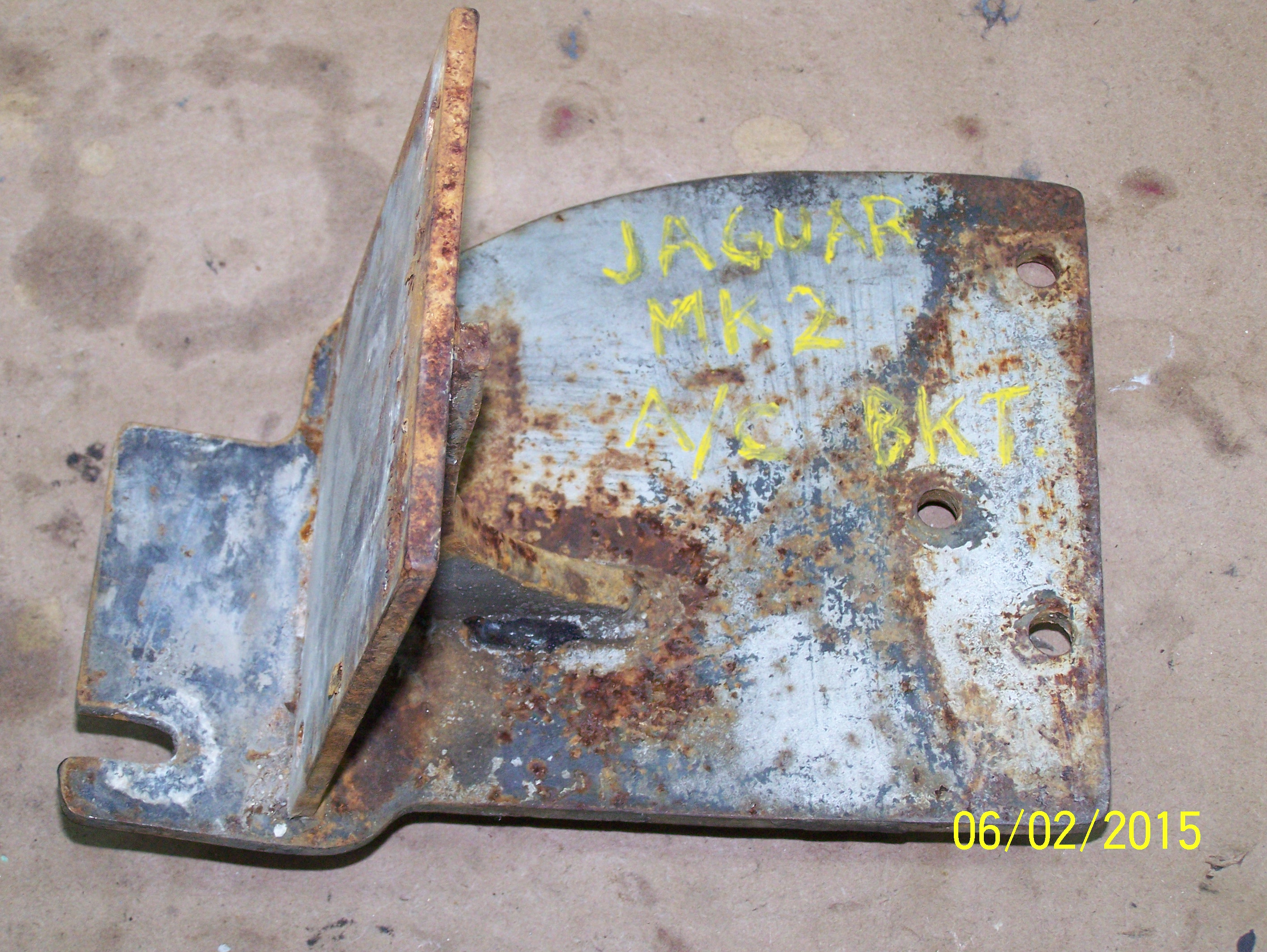

I posted the a/c parts that I have from a 1964 MK-2 brought to USA from Hong Kong. (RHD car).
check the Member's Marketplace page. (Classifieds).
the brackets are massive, the YORK compressor has the double-V pulley, there are two separate brackets or "supports", as well as a Condenser that was mounted behind the grille. I do not know if these are factory brackets.

I have purchased an original after market bracket originally used on a MK2.
It fits and with the addition of a readily available york to sanden mounting bracket all fits fine.
Bob
