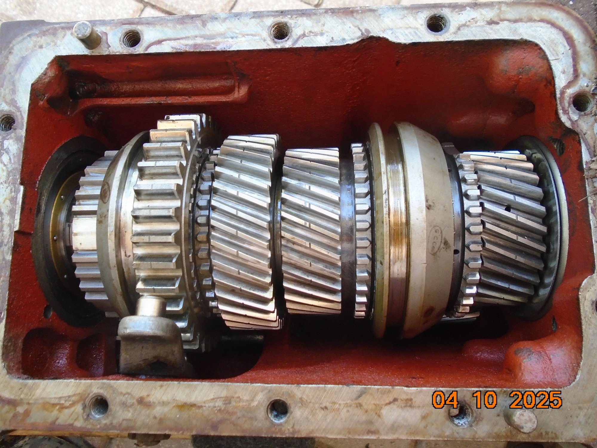

Thought I would share a photo of the close ratio Moss box recently purchased. The inside shows how pristine this box is, as if it was never used or was rebuilt many many years ago.
We will still go through it in the next few months before going in the car.
