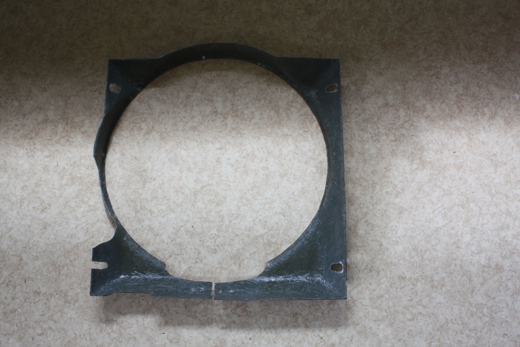

Thanks Jose. A V12 must be one hell of a tight fit in a MK2 - and I thought I had problems with getting rid of heat - lol !! I'm hoping to post better news regarding my car tomorrow, after fitting the new shroud as
suggested by Jon (fingers crossed).

absolutely, a shroud is a no-brainer.
otherwise, heat can be solved Search the forum for member Primaz and his lumped V8 S type. He solved the heat soak problem.

Good luck! I have recently fit one of those shrouds. Hopefully it never needs to be removed again.

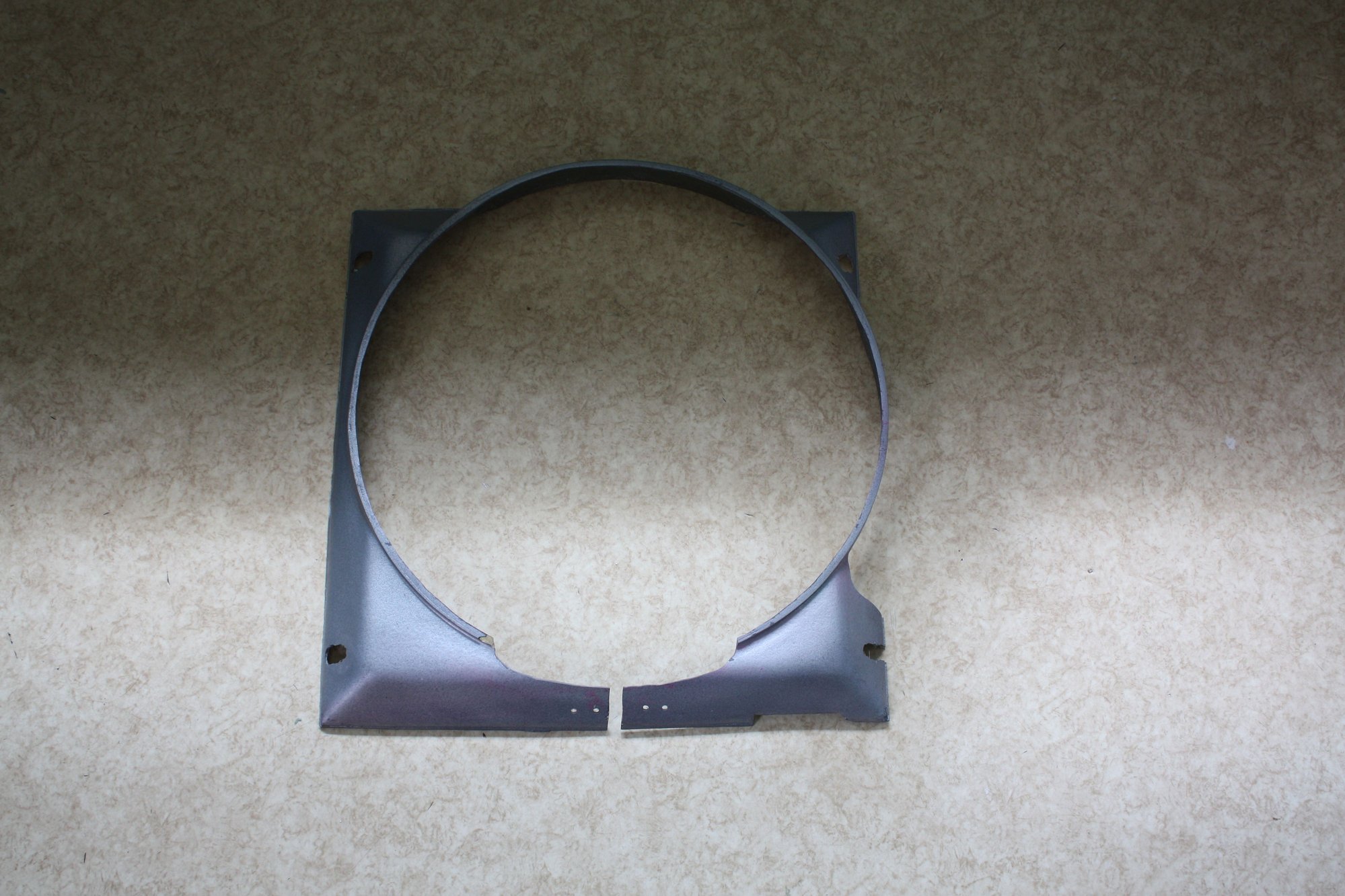

in the S type the shroud is fastened with 4 bolts, one in each corner of the radiator. Not the easiest to fit, but not a monumental job. It just takes patience. The shroud is made of fiberglass, very delicate, but if it cracks, you fix it with fiberglass strips and resin.

Thank you both for your comments about the shroud - it took me 6 hours in the end to fit it !! Main problem was that the brake servo (aftermarket one) protruded further into the engine bay than the origional, which necessitated using a Dremel to file an indent in the right-hand side. Also the lower edge required cutting back where it met the bottom pulley (in addition to elongating the mounting holes). Most of the time was taken up fitting, marking for cutting, removing & cutting & then trial fitting again. There's not a lot of room between the radiator and the water pump/fan, so I removed the fan firstly. It helped in removal/replacement to cut the shroud at the bottom centre. When all done I the used a piece of plastic to join both side (small BA nuts/bolts). PLease see attached photos. I ran out of time in the end so can't yet report as to whether this exercise has cured my overheating problem - should be done tomorrow (fingers crossed).
I couldn't get mine to line up at all after a lot of struggling, largely due to the stock brake servo! let alone an aftermarket one. I gave up in the end and started trying to remove it deciding to go with no shroud. Then I couldn't get the thing to come out! During that struggle somehow though it finally slotted into place so I hurriedly attached it!!!!

I know exactly what you mean regarding removal. Mine is now in place (following about 10-12 removal & refittings). I started the car up today, checked the ignition timing (as I removed the dizzy and thermostat housing as well). That went OK but when I tried to adjust the carb mixtures the rearmost one (HD8s) started to leak fuel and the adjusting screw went sloppy. I think the jet diaphragm may have split as, when I removed the dashpot, fuel poured from the jet - so that's my weekend sorted !! Carbs off in the morning and off to David Manners before 1pm with a a new shopping list. Oh, the joys of classic cars - lol !!!!
