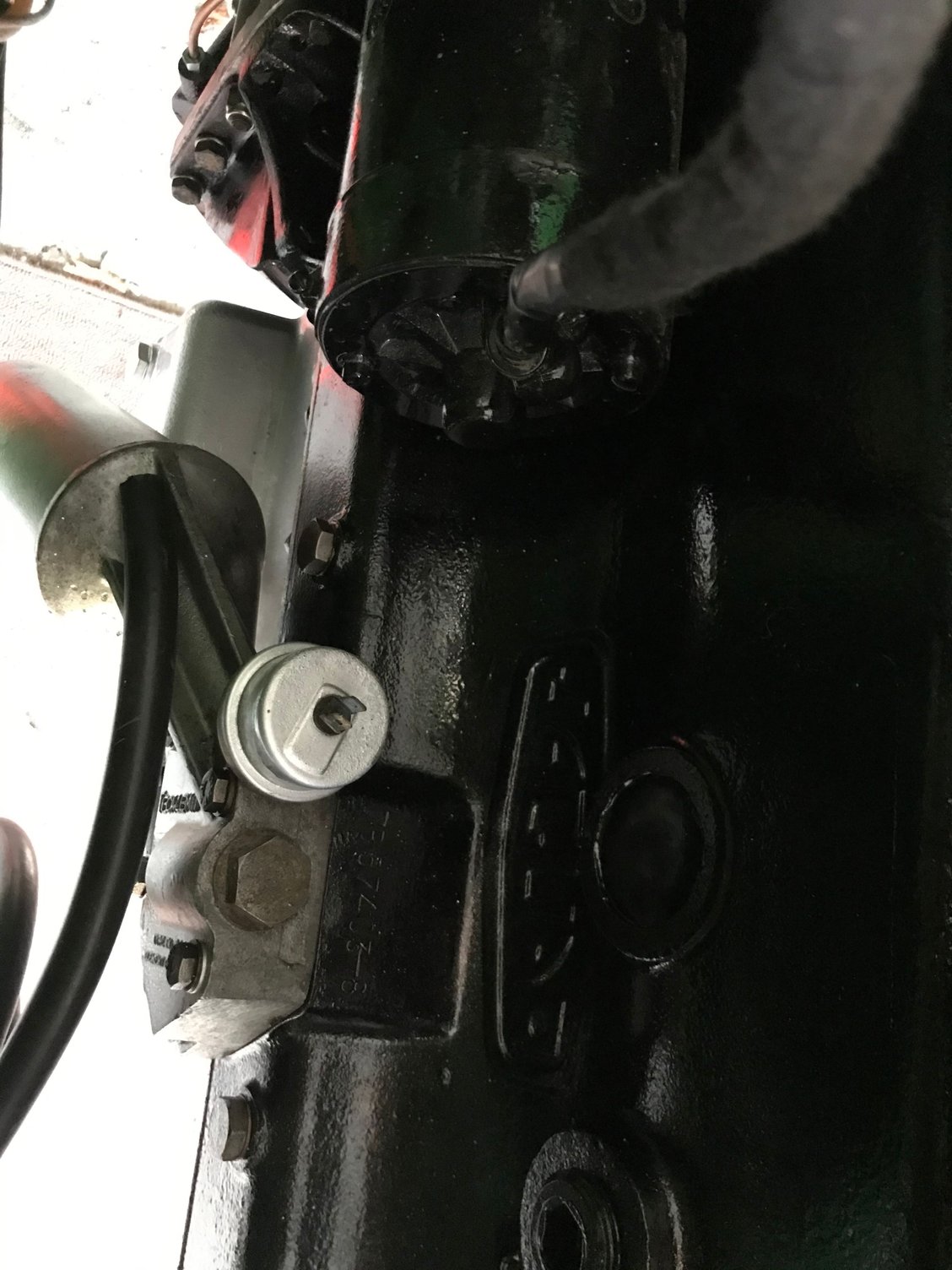

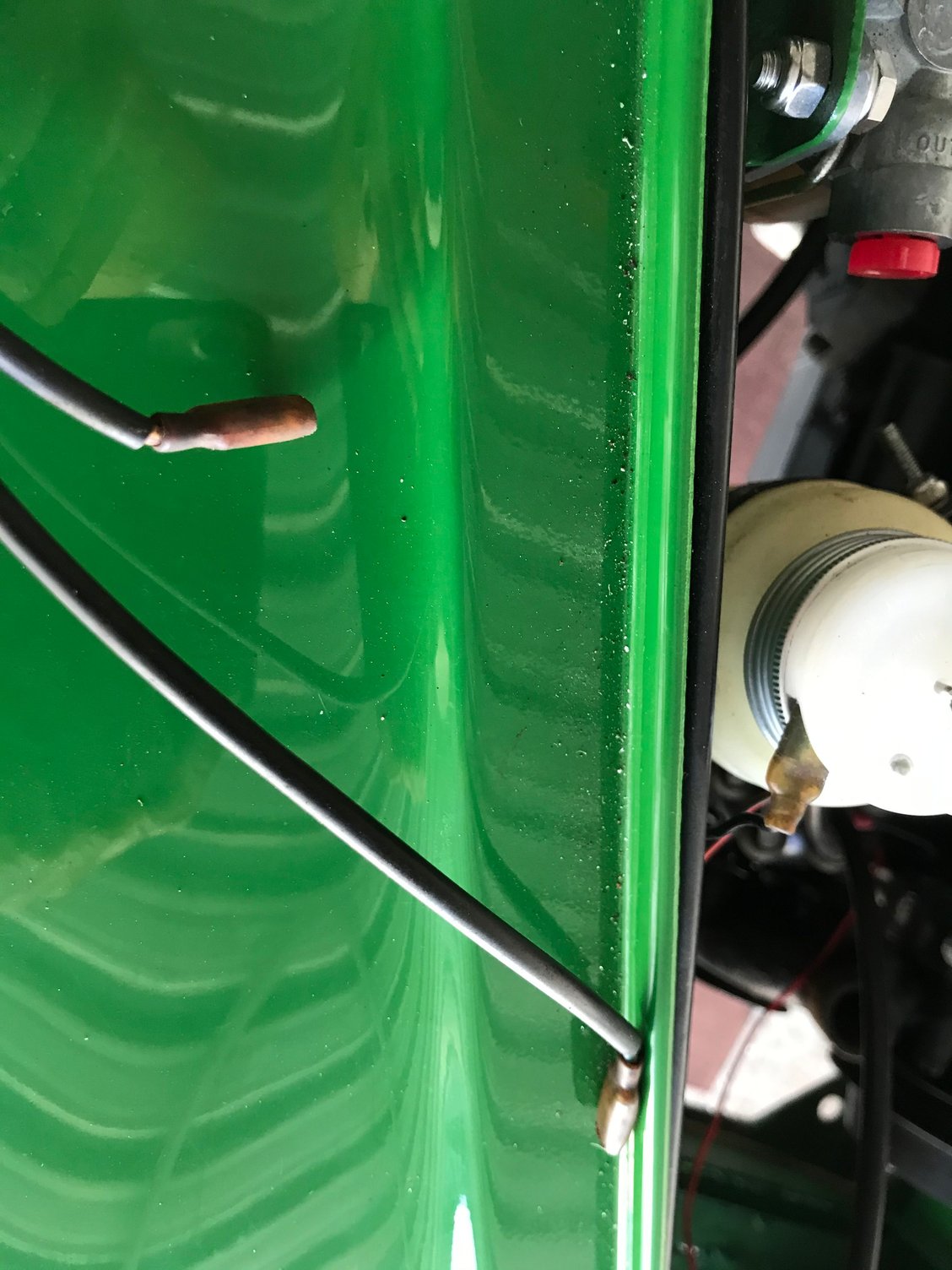

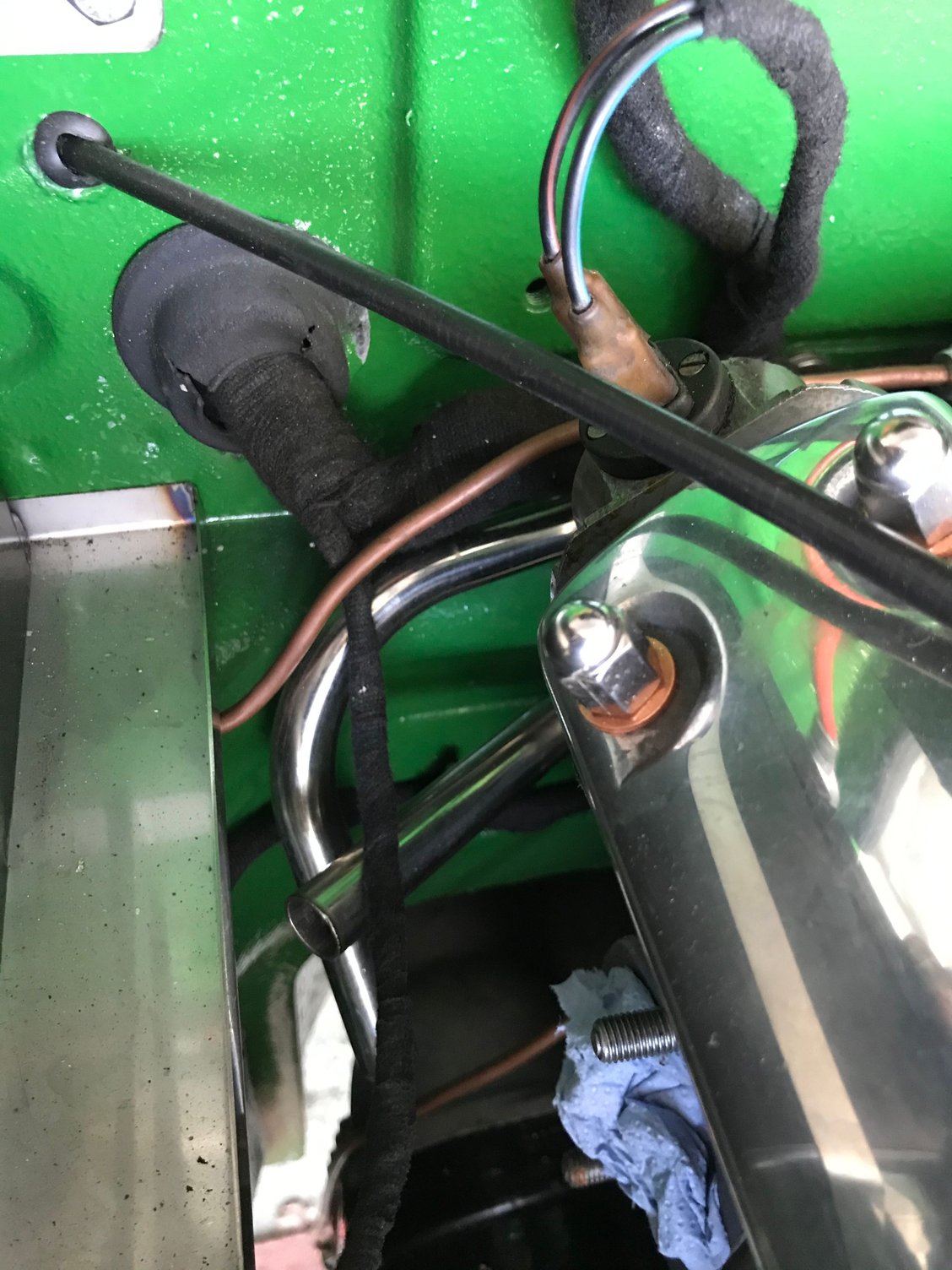

Can anyone tell me where these wires go, one is white/brown trace the other is Green/blue trace, I've two wires missing for the oil pressure switch could these be the ones ? (They are different lengths and seem too long) Also do I have the wire for the rev counter the right way round? Thanks in advance

The tacho generator is a self contained alternating current (AC)device which does not have any polarity, therefore it doesn't matter if it is connected either way.
The white/brown wire goes to the oil pressure sender unit.
The green/blue wire goes to the water/coolant sender unit.
