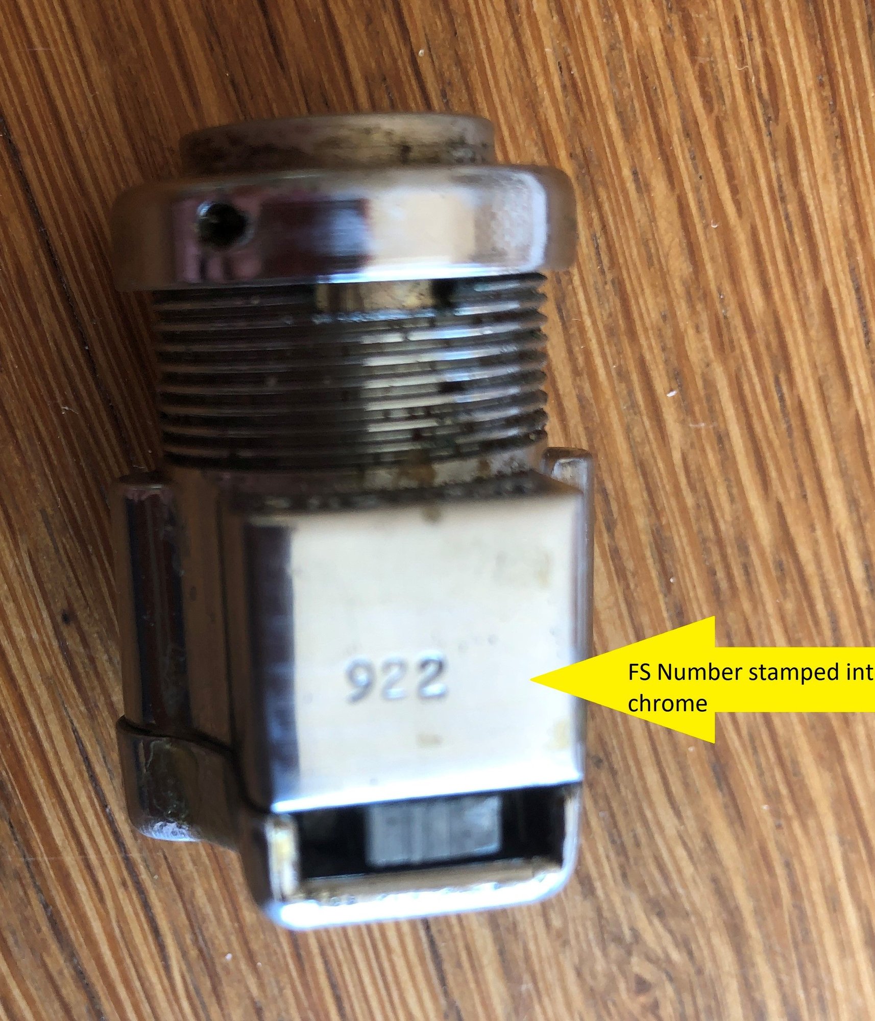

All the locks have the FS code stamped into them. On the S Type glove box if you turn the ring around the lock it will unscrew. The lock will push into the hole in the glove box door and you can pull the door down and retrieve the lock. The FS number is stamped into the back of the lock as per the attached photo and as you has said the glove box and boot should be the same FS number.
Once you have the FS number go to this web site https://www.replacementkeys.co.uk/un...hoC4BEQAvD_BwE type in your FS Number pay for as many keys as you want and they will arrive within two days. I have used this company many times and they are superb.

Cass: THANK YOU VERY MUCH! That did the trick. Not only did I get the lock out of the glovebox door, I found a key inside that works both the trunk and glove box.. I usually hang out around the Austin Healey Experience Forum, but I'll probably be haunting this one too, getting the old girl going.
