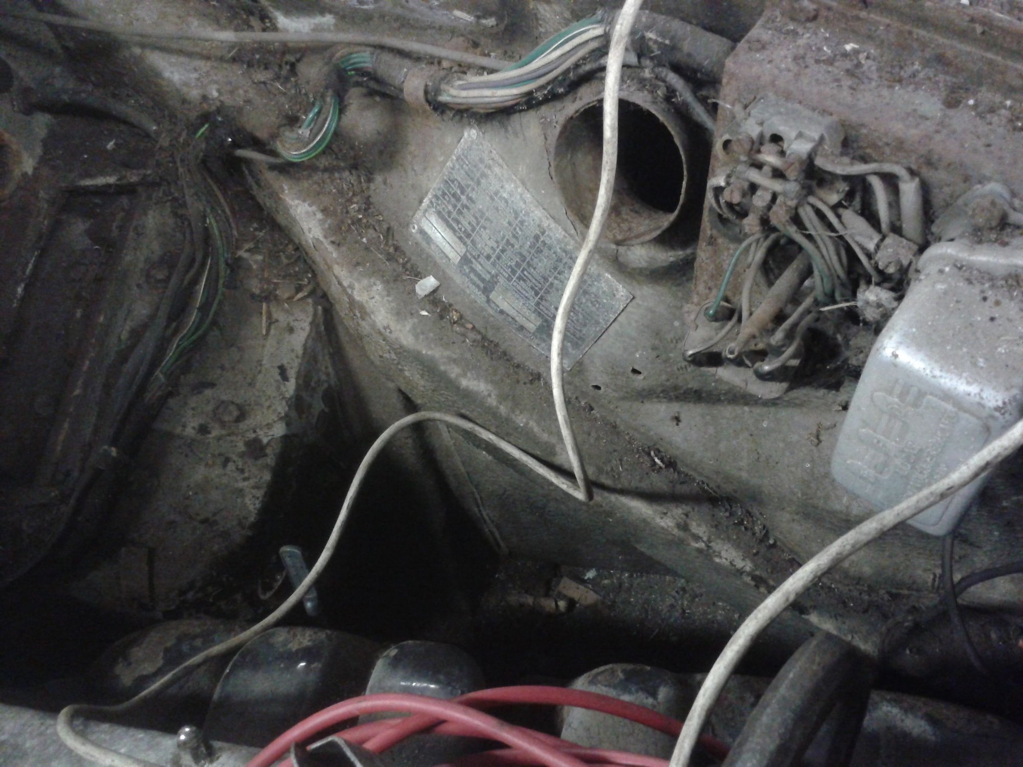

Hi All,
Im new here!
I'm in the process of restoring a 1962 MK 2 3.8 It came to me in lots of bits and I need to know where things go. Could someone be so kind as to send me some photos of their pride and joy Under the bonnet ( especially the wiring. and where the brake pipes should be routed ) Under the wheel arches ( I dont know where the servo expansion tank is supposed to be located ) and anything else that may be useful
Thanks in advance
Ray

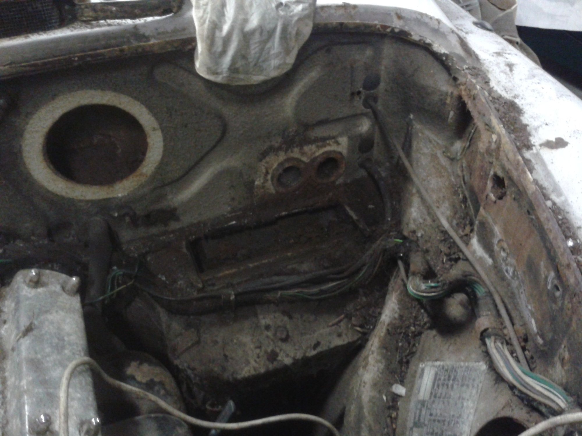

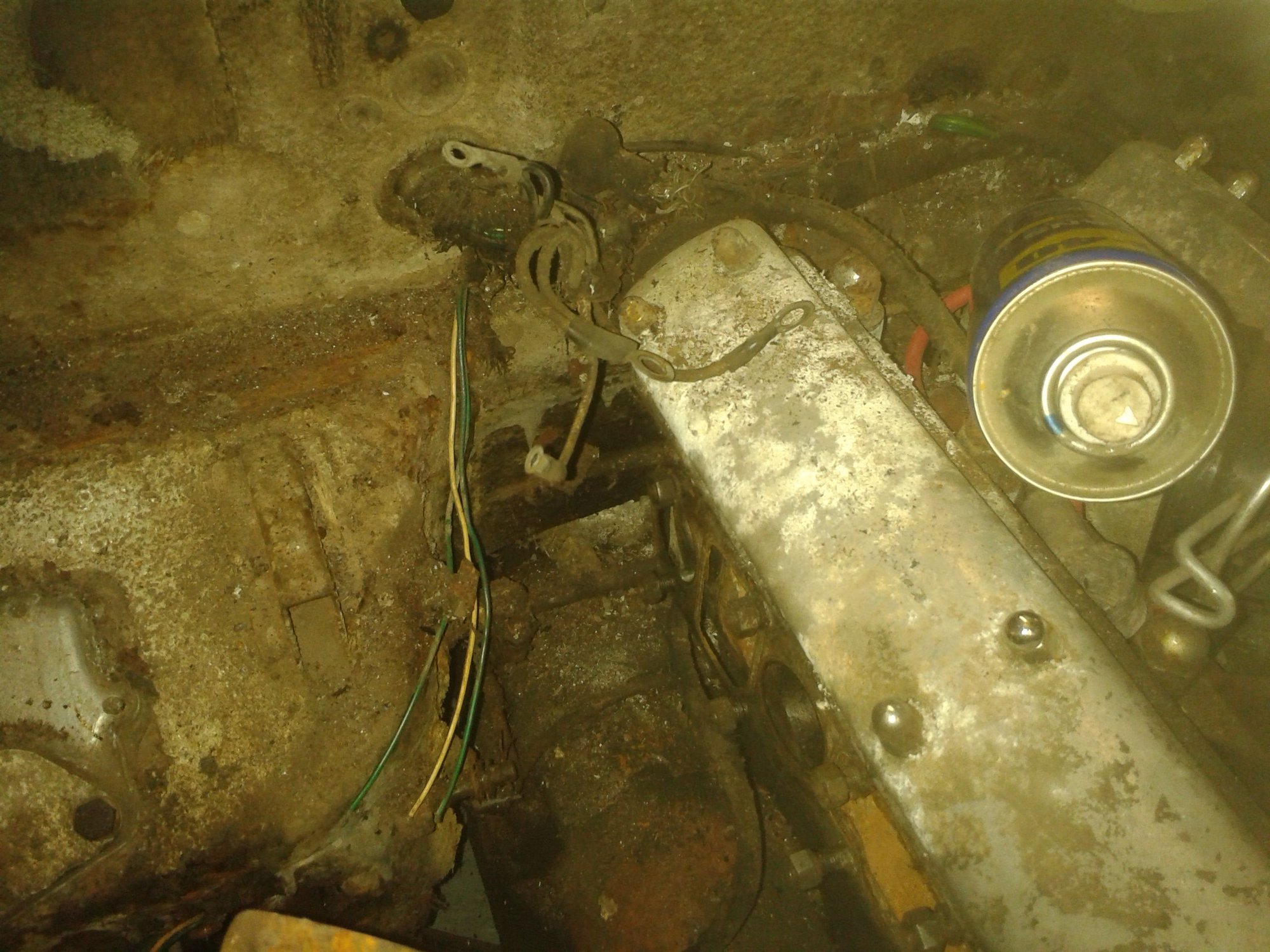

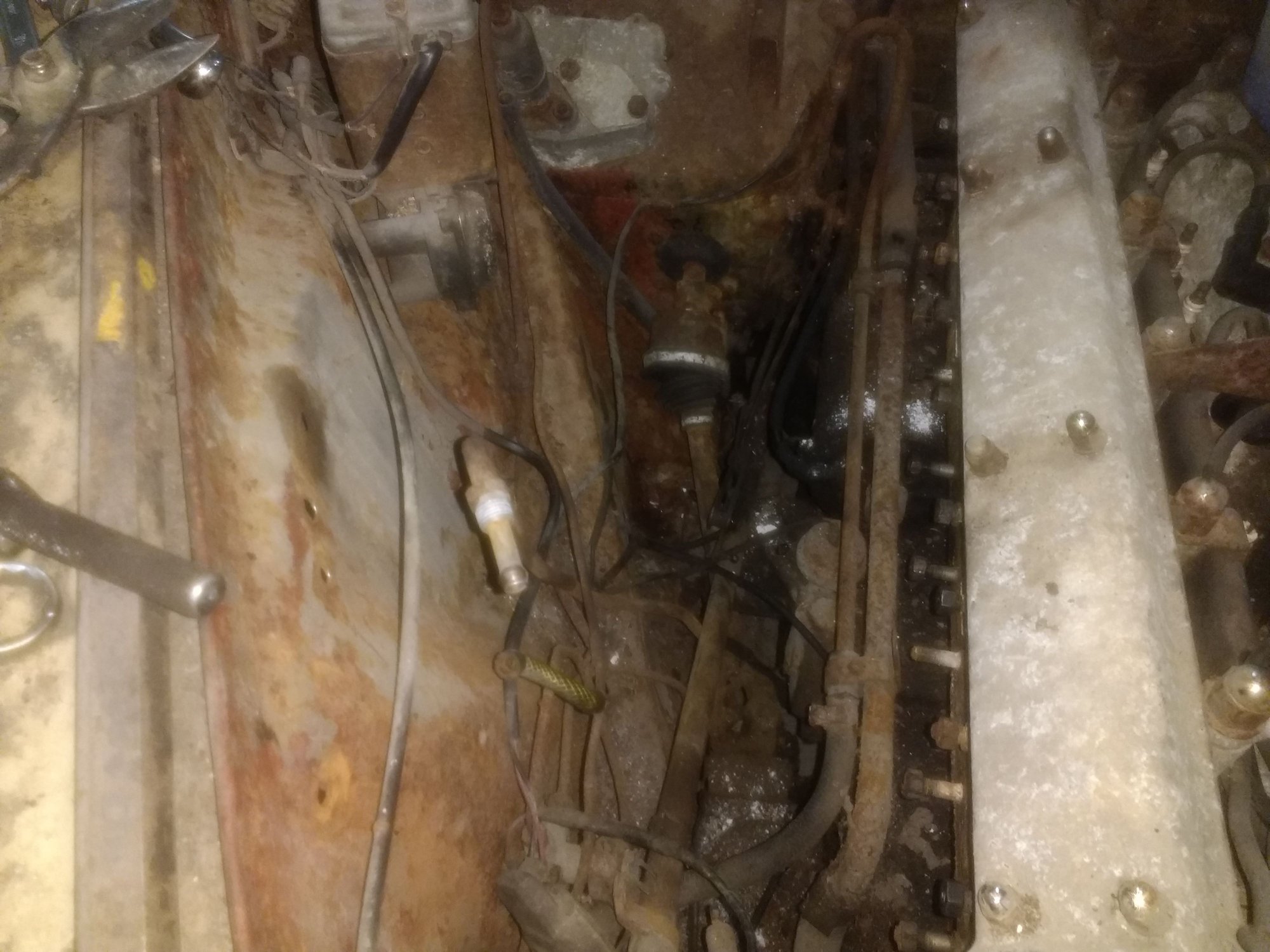

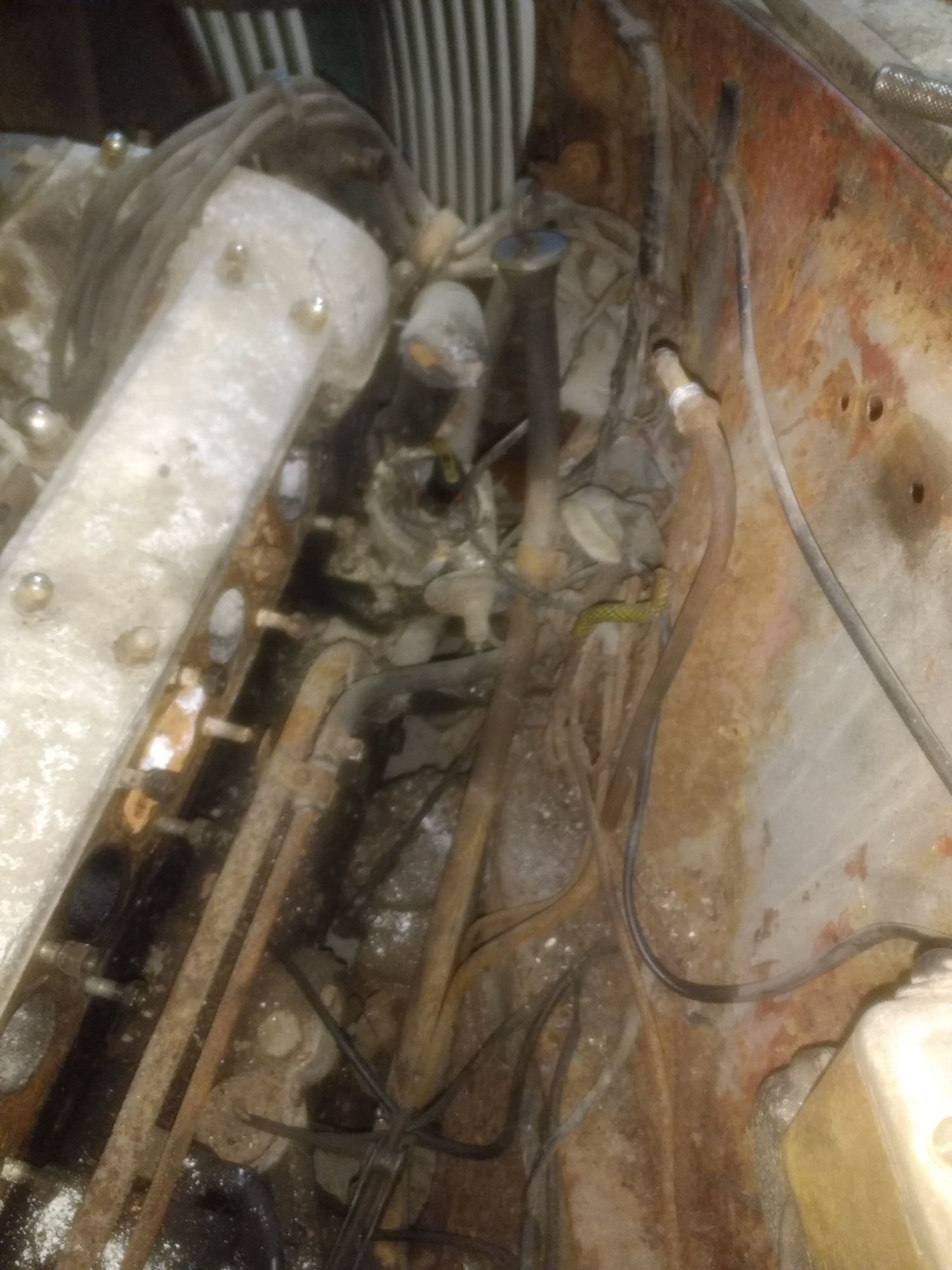

These were some stripdown photos of a 1959 MK2 3.8 Auto
Old Oct 20, 2020 | 03:49 PM
Homersimpson's Avatar
Joined: Apr 2016
Posts: 661
Likes: 342
From: Worcestershire

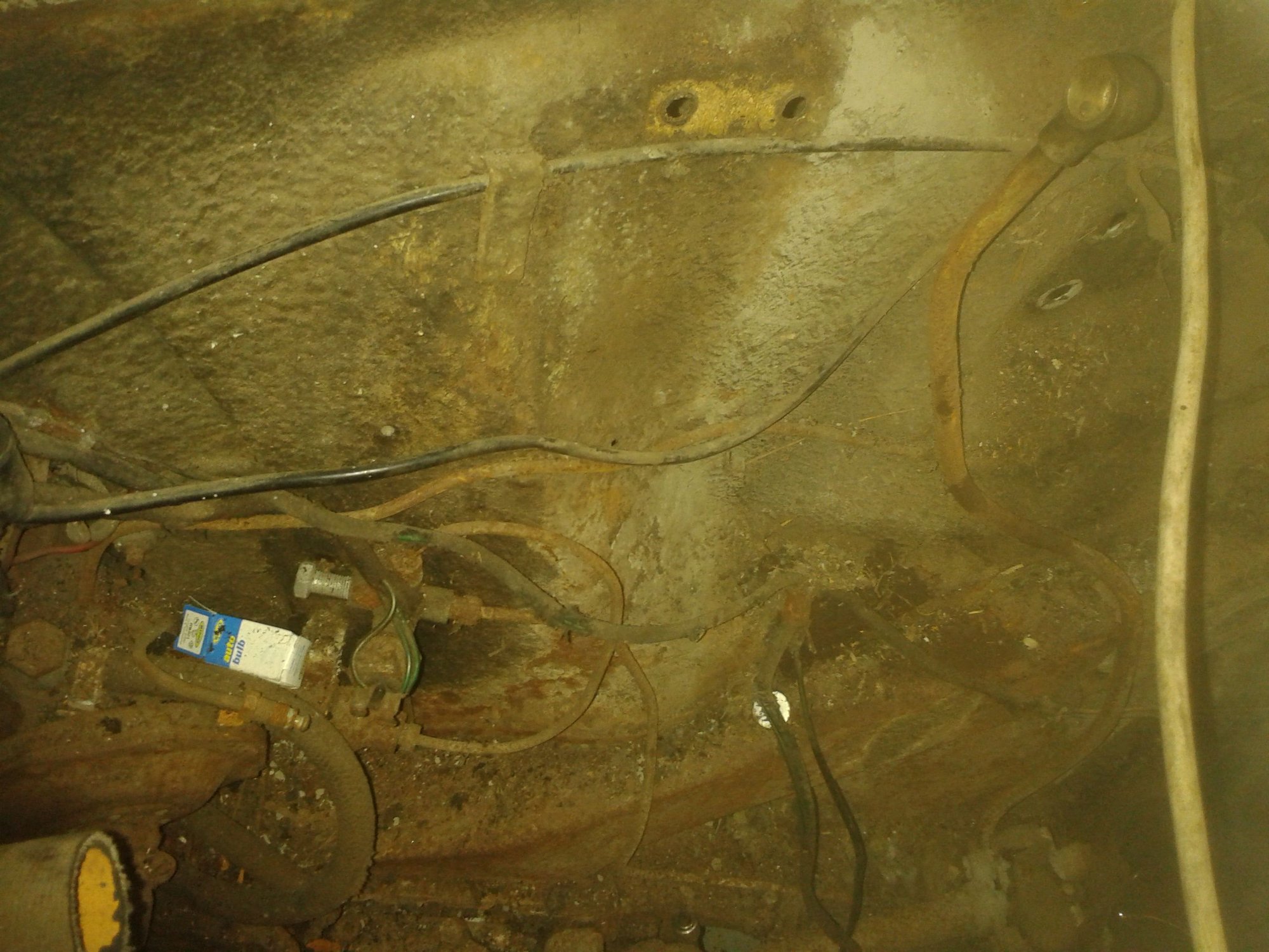

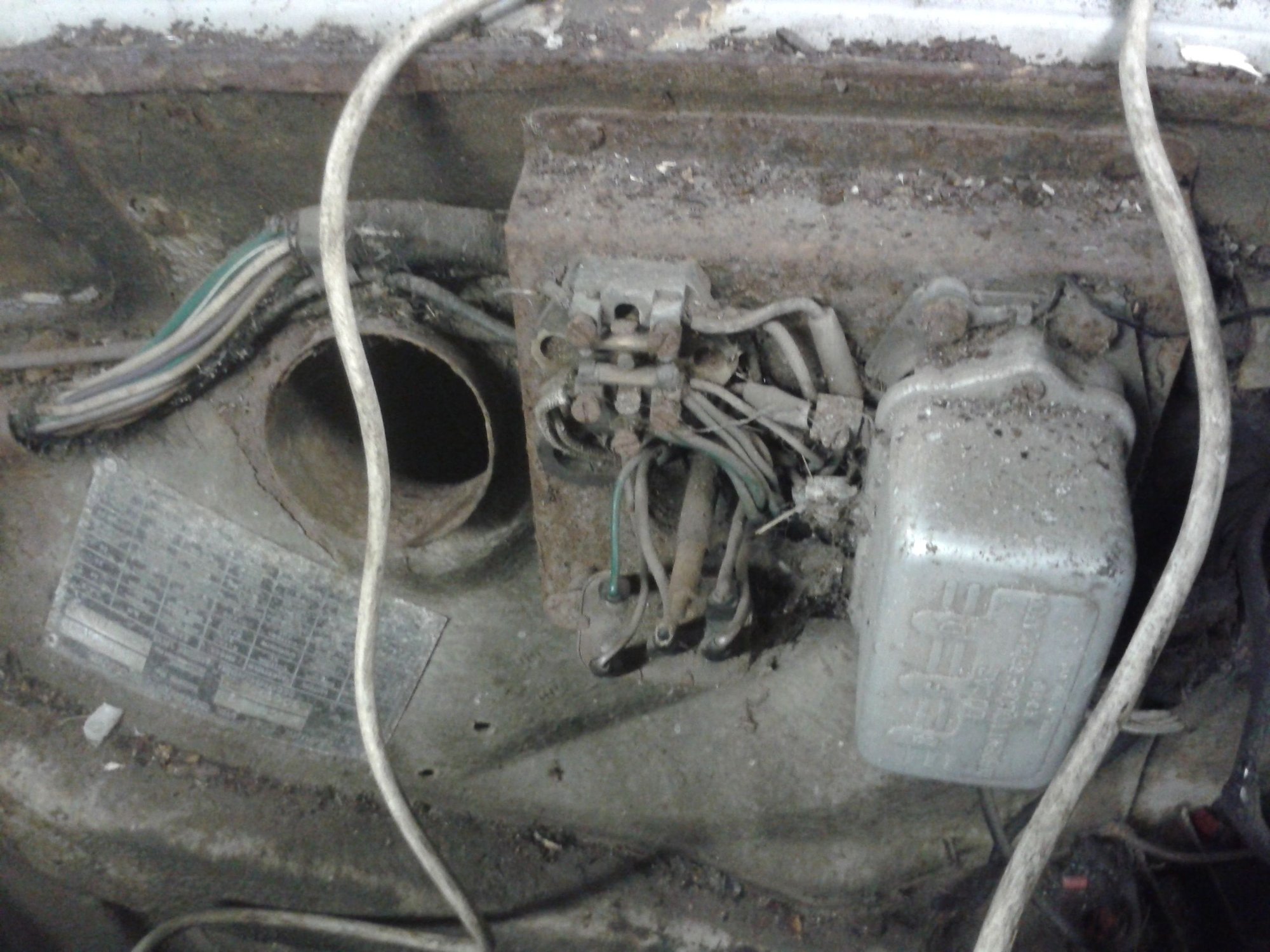

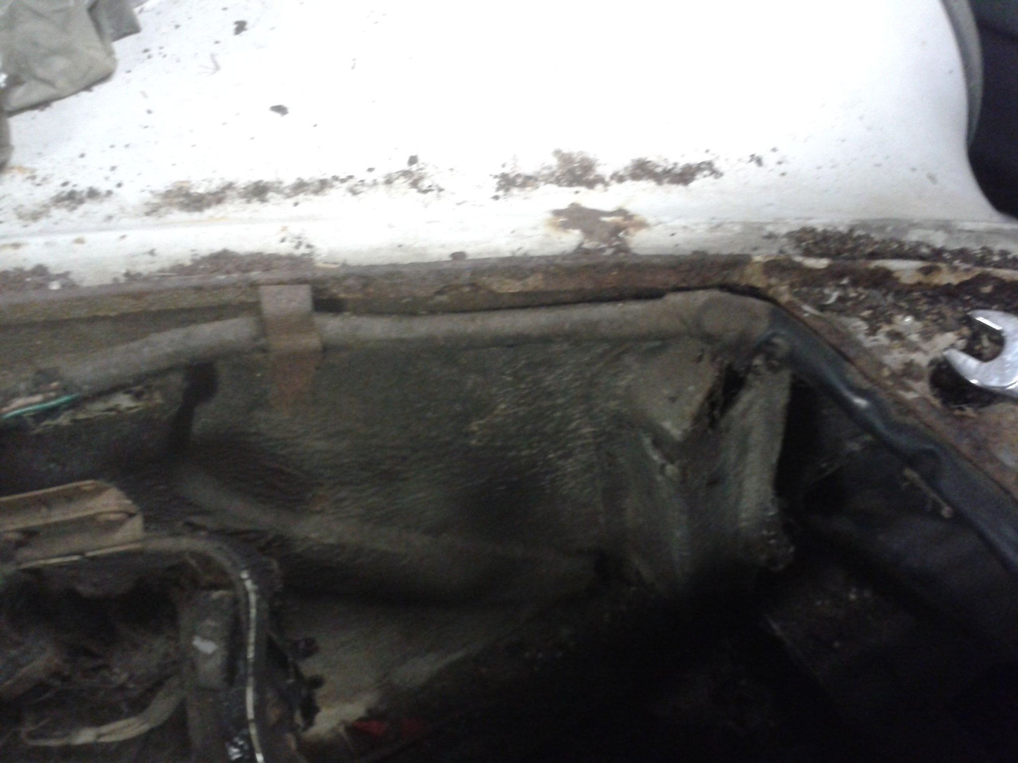

This is a 1967 MK2 2.4 Auto.
Old Oct 20, 2020 | 03:53 PM
Joined: Apr 2016
Posts: 661
Likes: 342

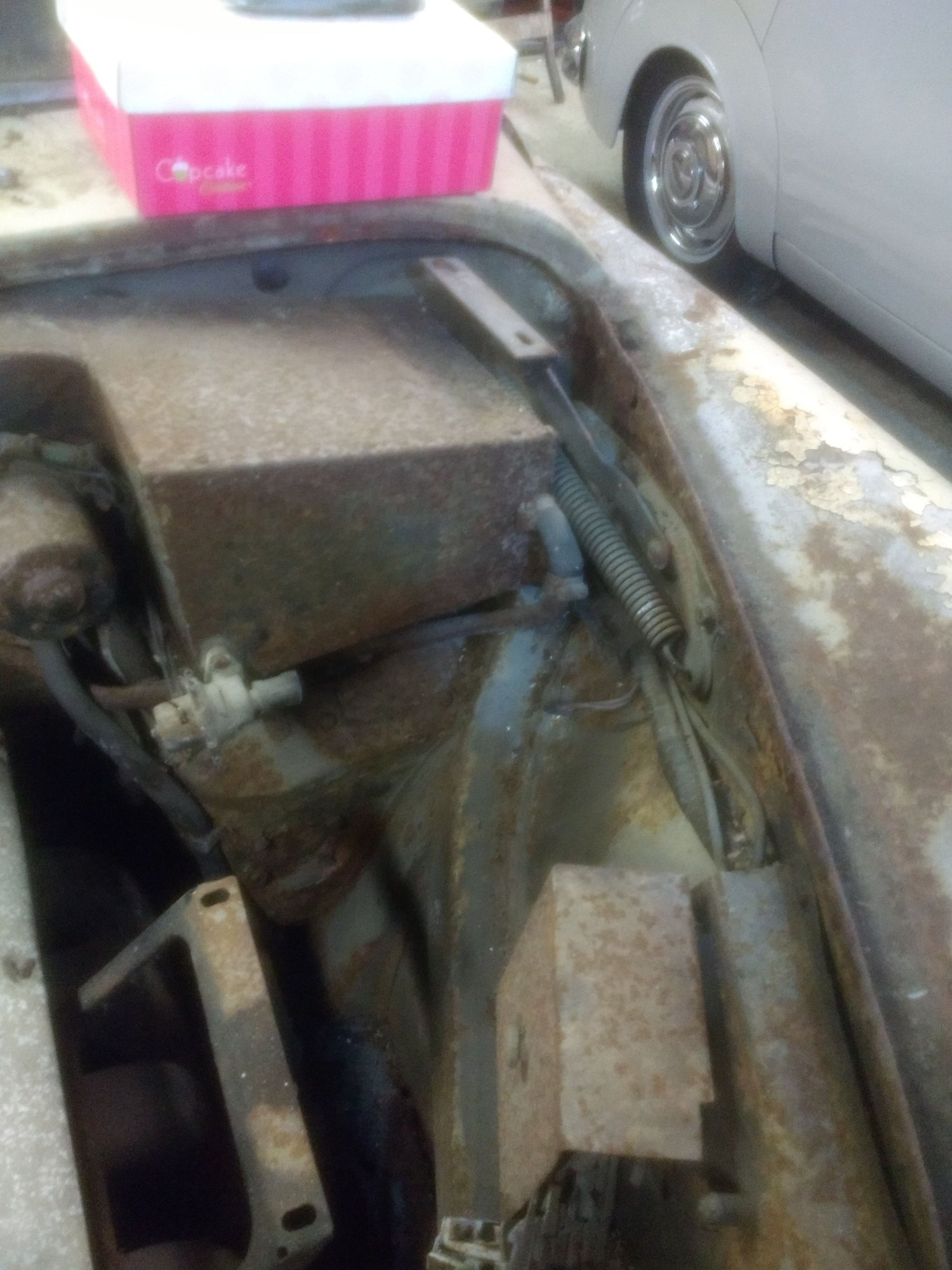

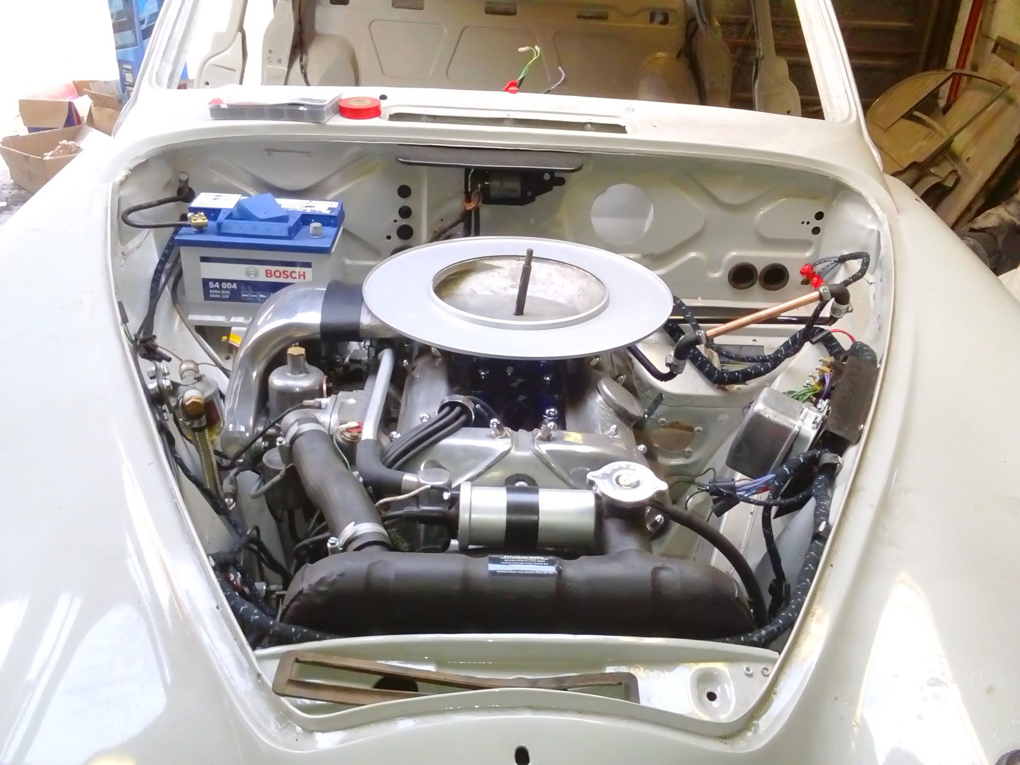

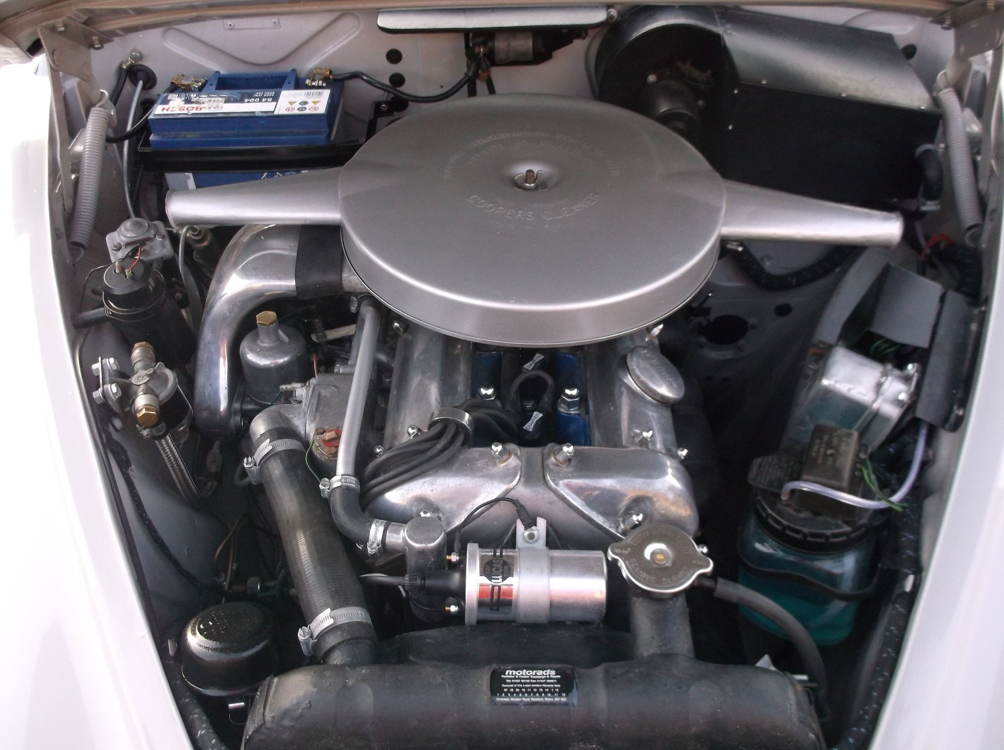

This is the 1959 3.8 Auto under the bonnet. If you need anything specific let me know. I don't have any photos of the vacuum tank under the wing but its under the drivers side (RHD) and bolts to the front crossmember and sticks up behind the lights.

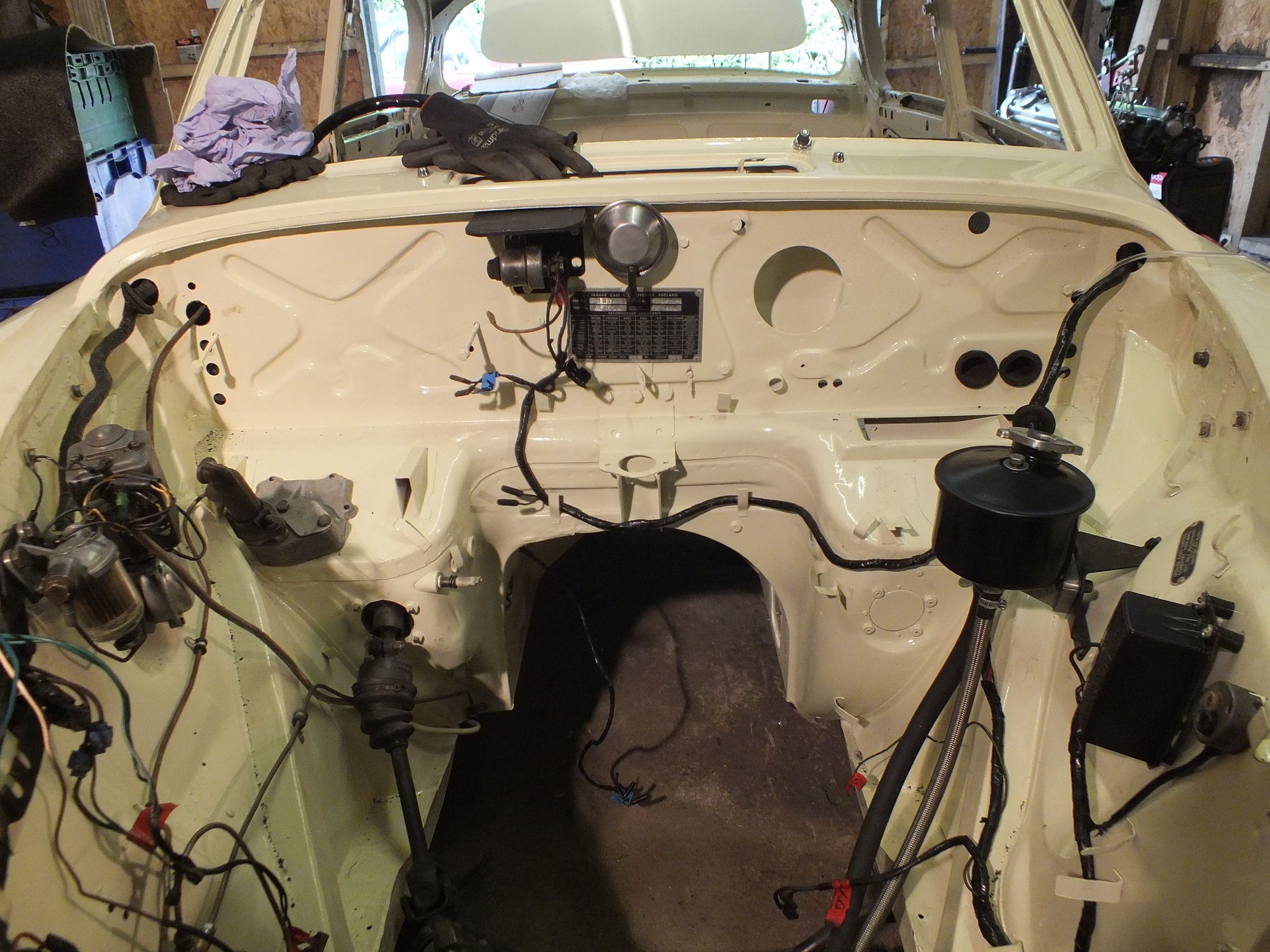

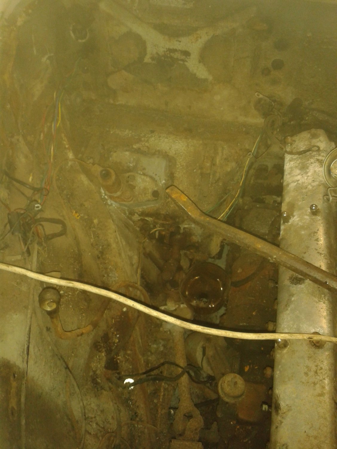

I don't know if these will help but they are photos of my 1968 S TYpe engine bay just prior to dropping the engine in so it shows where all the bits are and where I ran the brake pipes and wiring loom. All the routing was based on photos I took during my strip down but they might be different to the Mk2 set up.

The Mk2 wiring harness has different routing to S Type. e.g. runs across in front of the top tank of the radiator.
