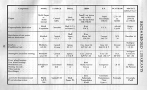

Attached is a scan of my 1965 3.4 and 3.8 'S' Models Operating, Maintenance and Service Manual (Recommended Lubricants, page 52). Note the Duckham and Regent (Caltex/Texaco) 20-50 engine oil recommendations, also included is another image of the Preferred recommendation by 'Penrite Oils' for the ((my words,) "original and best") Jaguar S Type.
P.S. I have run another Penrite product, Penrite HPR30 20W 60 in my 1972 Norton Commando, my 1982 Triumph Bonneville and my 1967 BSA B44 Victor Roadster for some years now with excellent results. NOTE! All old tech flat tappet engines!
With the greatest of respect newer thinking. I'm a Tribologist from a Supermajor oilco. 1972 Manual for 1965 3.4 or 3.8 S Type. So called "Classic" oils are rubbish as explained above. Jaguar from day one of the XK engine have never recommended anything over an SAE 40 engine oil in tropical conditions and an SAE 30 in summer. Penrite has been wrong for years.
