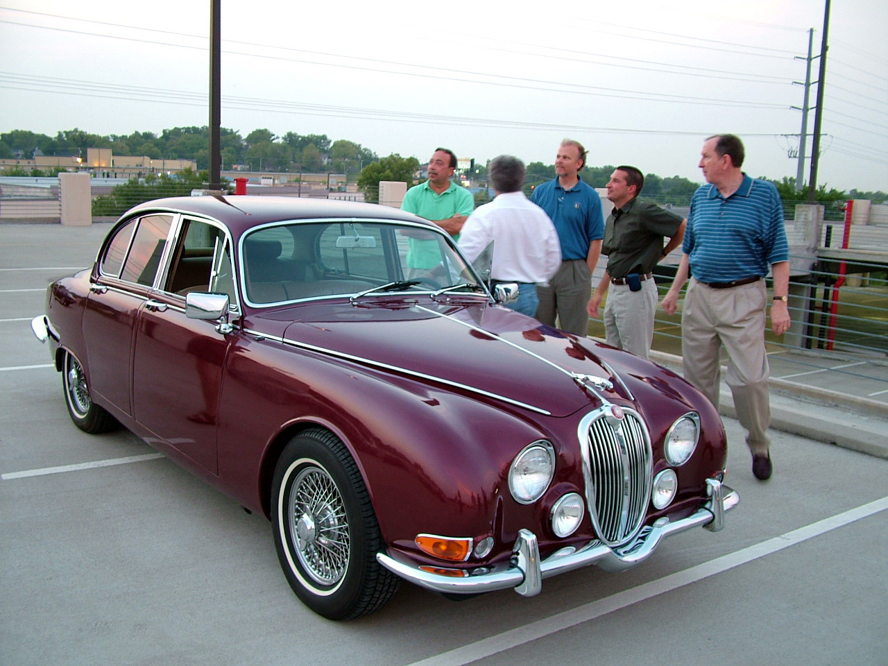

I understand Ted,
I'm sort of in the middle, I like a classic car with SOME modern conveniences like power mirrors, a nice sounding radio, a power antenna, a smaller steering wheel, but otherwise as original as possible.
this is my S type in the picture.

Nice looking car. Did you restore it yourself? Some day mine might look as good (I hope).

Ted,
the car is unrestored, other than a respray in 1984, and the improvements I have made like electric door mirrors, seat headrests, modern Jaguar radio, the paint is still excellent. No rust, no body damage, a Black Plate California car, owned by a famous California artist painter, Eugenia (Gene) Baker McComas (1886 - 1982), whose paintings are in the San Francisco and Monterey museums of art. She took very good care of her Jaguar.
