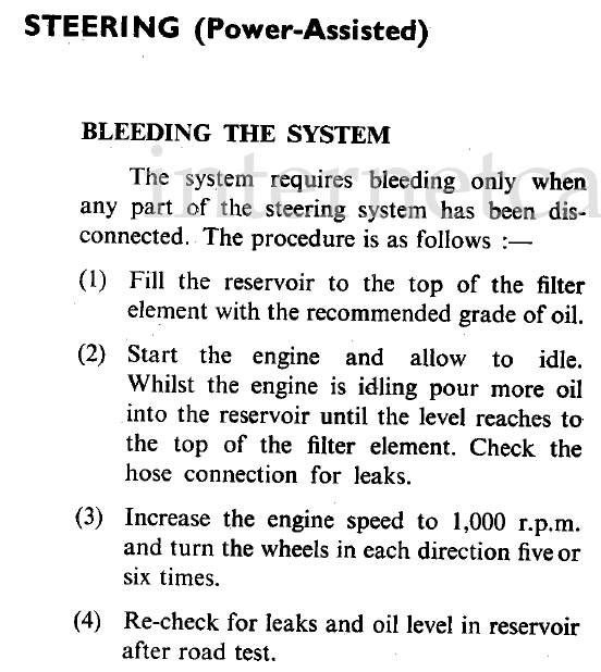

Here we go. Different model:

Felix ~ Do not overfill the reservoir. Fluid level should just cover the filter once system is bled.
