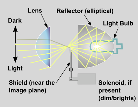

I have researched 7" LED headlights and think the Vision X 7" LED is one of the best. They have been one of the top choices in many reviews. I am running them on my Jaguar 3.8s and they look great, and they provide a great light output for safe driving. I have been very happy with them and now installed them on my 240Z cars as well.
https://blog.betterautomotivelightin...adlight-review
That was long before Wipac hit the market with the above projectors which are new right now. Half the lights available make the car look like a Noddy car. Like BiX the real trick is in the Lens and it's precise focus on the burner in the case of BiX or LED.
Light source would have been better wording than light bulb. Shield is the mandated dipping shield for ultra bright lights such as BiX or HILEDs. Remember it dips from the bottom because we are running through a lens that inverts things.
