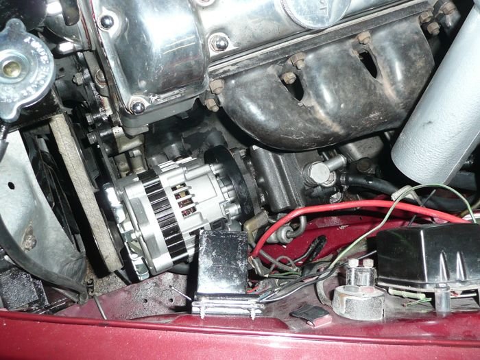

Another "fix" to Jose's problem is to fit an alternator in place of the generator. Just make sure the alternator has a built in regulator.
I did this relatively simple modification to a couple of Mk1 and MK2 cars.
a 50-amp alternator is capable of punching out 600watts right down to idle speeds which is more than enough to hold the lights on full bright.
I know it is not original (don't tell Glyn!) but it does beat the frustration of fading lights and battery discharge in traffic.
However, this may not be possible if you have a power steering pump driven through the generator.
Sure it is! Just takes a bit more fabrication.

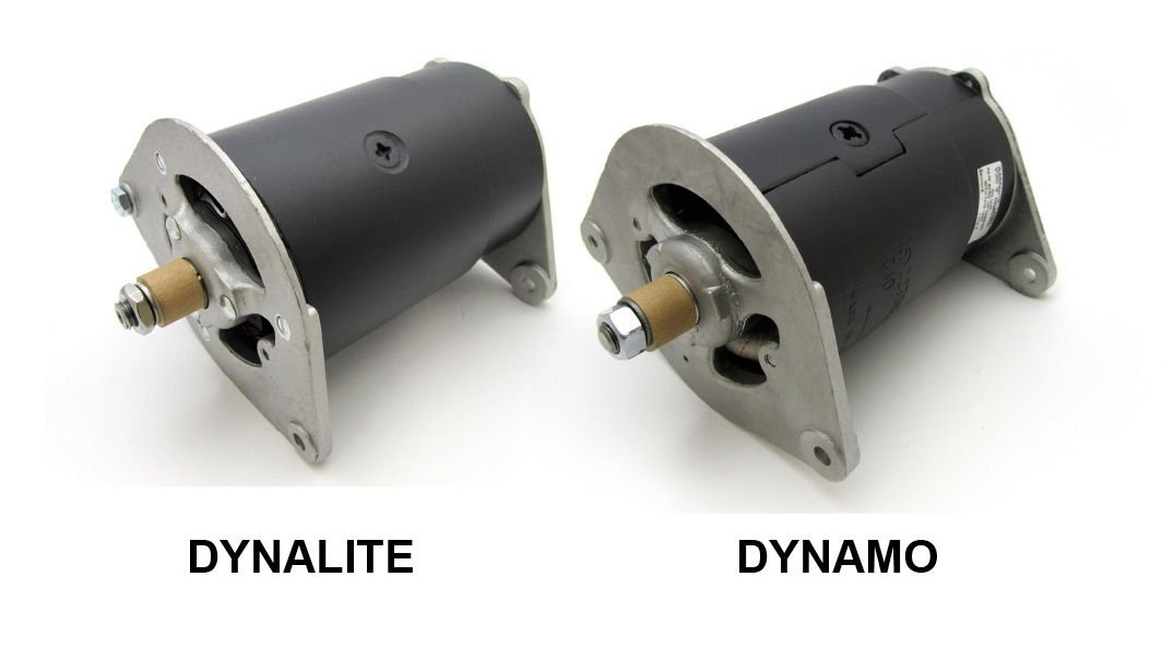

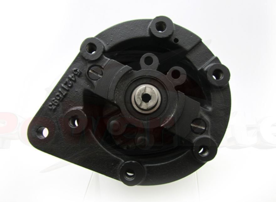

You can have an identical looking alternator Bill with PAS pump driven off the rear. No issue there. There are a number of manufacturers. No fabrication required.
On a new car their are 3 deal breakers for me: Park Distance Control/Parktronic back & front (Don't need rearward facing cameras). Bi-Xenon or High Intensity LED headlights & Navigation. All the rest of the crap like Lane Assist, Distronic etc. are just nice to haves.
Dynalite Alternator with PAS pump drive: (Most Lucas Dynamos/Generators don't even have the split casing).
PAS pump drive at rear.
