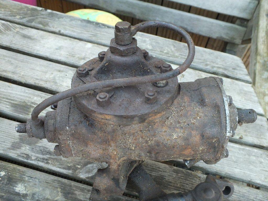

If I'm correct I have the Burman power steering box. It worked fine but leaked. How tough is it to re seal? Is there anyone in the states that can do it?

Yes that is the Burman not sure if type 1 or type 2. That depends on the age of the car and a subtle difference in the piping I thing some one said.
I have the Marles Adwest which was on the later cars and was very easy to work on with only three or four moving parts and Nylon bearings. But I have been told and it has been discussed on this forum many times that the Burman is a Bitch to work on and has a hundred moving parts most of which are loose ball bearings which go everywhere when stripped. You also have two sizes of ball bearing which lie alternatively on the same ring just to complicate it further. I am in the UK but there will be someone on here who has a source to rebuild it for you in the states.

That is a Type 2 & should have HALE cast/stamped on one side of it with torsion bar & quill valve. It is correct for your car. Barratts sell rebuild/seal kits. Someone local I'm sure can guide you to a re-builder.
