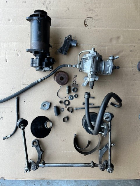

I'm building a 1962 3.8 Mk2 Race Car. I have removed a complete BURMAN power steering system replacing with a manual steering system and EZ power steering system.
I have pics but don't seem able to upload I'm located in East Tennessee, where are you?

Sorry I'm new to this online stuff and didn't spot Paris. The last car I sold, a round tube, Ginetta G4 I sold to a French guy who was returning to Paris
The car I took this LHD Burman Power steering system from was 1961 3.8 manual with O/D, initially registered in New York.
I'm fairly certain it has never been off the car so safe to say, Mk1.
There is a picture now at my first post, it is very complete.,
