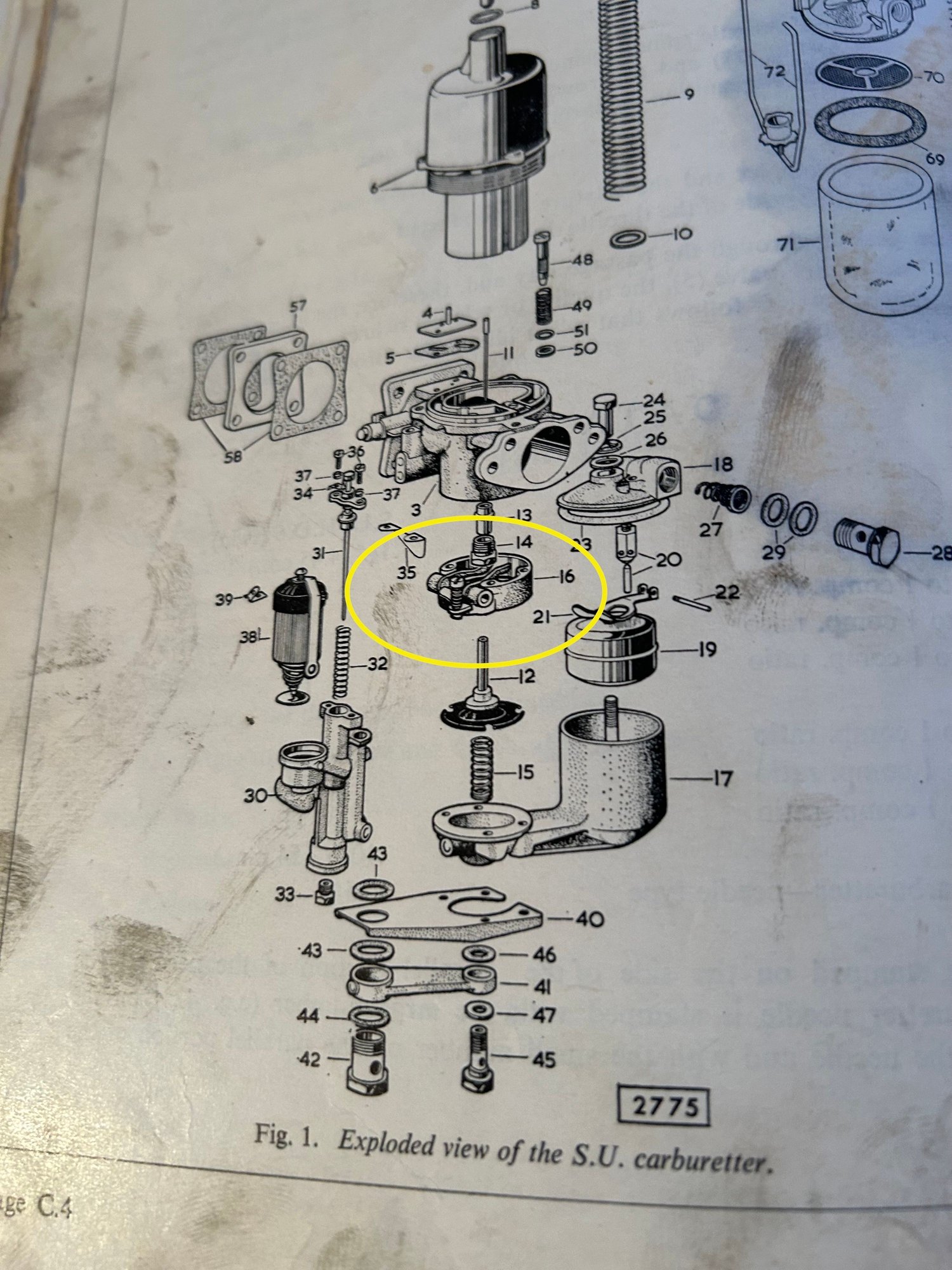

OK, so its the mixture screw I was messing with - #15 in this diagram...
Visible from the top, one on each carb...
SU HD6 Diagram
SU HD6 Diagram
So how does one adjust idle?

BTW. Do one carburetor at a time. You don't want to mix up the pistons and suction pots. They are machined to fit the carburetor they are on, they can't be swapped.
Old Apr 21, 2026 | 10:41 AM
  #73
Felixbobcat's Avatar
Joined: Sep 2022
Posts: 168
Likes: 93
From: Los Angeles CA
I believe number 15 is the idle speed screw in your diagram. I'm not seeing the air mixture screw!
Old Apr 21, 2026 | 10:51 AM
  #74
Joined: Sep 2022
Posts: 168
Likes: 93
The air mixture screw is mounted on the collar I circled. It raises and lowers the jet bearing number 13 in the picture
