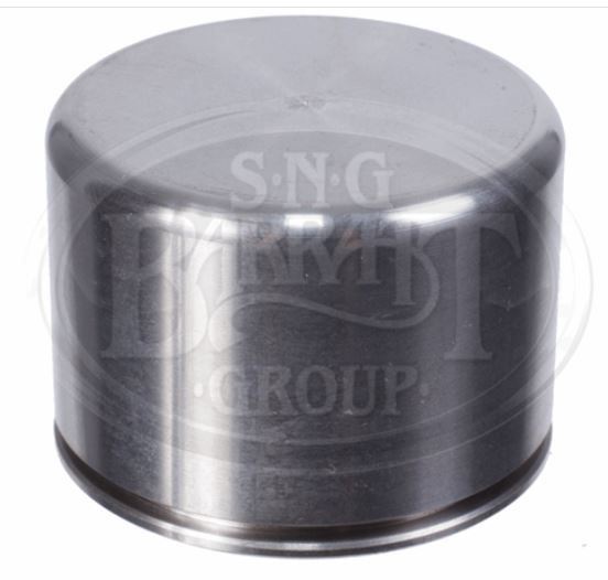

I have stripped down the rear brakes and am ordering parts. I have brake pistons which look like this, which have a central button which the pads locate on, part no10122 ;

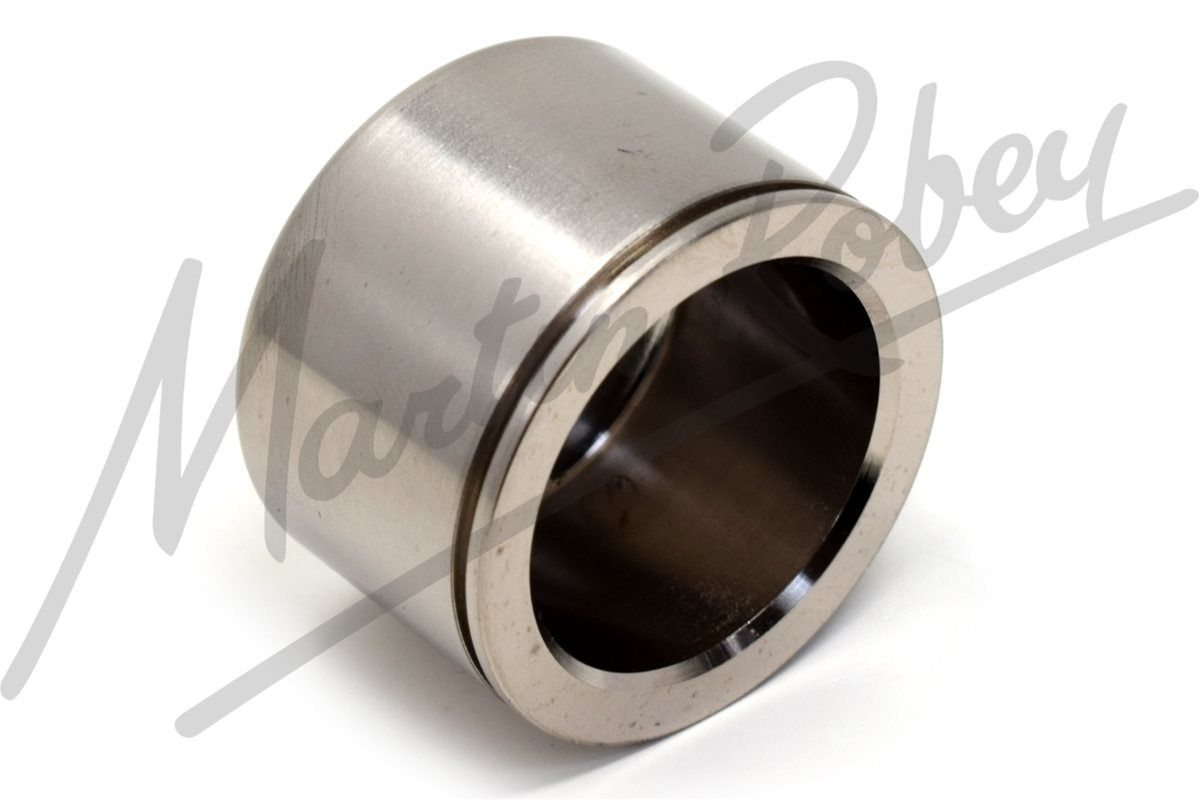

Two different replacement pistons are offered by both Martin Robey and SNG. One which looks like the one above and another 'conventional' looking one without the central button as below, part number 11372 , which is considerably cheaper.
So anybody know which one I need? Can I use the less costly one?

The one is designed to prevent caliper over return (with centre piece) They don't work which is why they have been generally deleted.
Let me attach my thread.

In certain cases with Jaguar it is done to clip the back of the pad to the piston. Also ineffective.

Over return didn't cause a problem on my Mk2 most likely because the pull back mechanism stopped working on all pistons in nineteen sixty something! I believe that Jaguar and Dunlop dropped it without any problems on the lightweight E-types without servo assistance to improve the brake action.
Ok thanks, so the conventional piston is the one I need.
Do I just pull out the central pin in the bore of the caliper?

These are fine in inner & outer. Remember sizes vary.
IIRC the hollow bore piston accommodates the pin. How are those damn pins held in there? My S Type was rid of all that stuff long ago. I have authentic Dunlop calipers but chucked the rest of that stuff out as more trouble than it was worth. Stainless lined calipers with stainless pistons.
Glynn,
Don't the hollow bore pistons go in with the hollow bit pointing out so the pin has to go?
I don't know how they're fixed in there, I'll have a look in the morning. They're not rigidly held, they wiggle around a bit so they must be in some kind of rubber mount.
Glynn,
Sorry good point. It's a while back & I did not do the job I watched while chatting. Summit did the job when stainless lining. Just pull them out while being careful with the bore. I have no pins.
