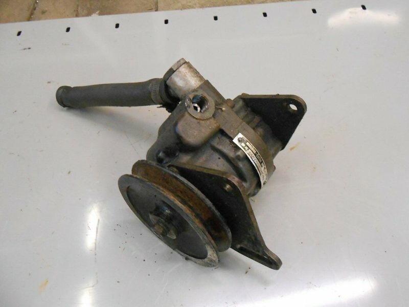

I have no idea about the Daimler, but I expect the steering boxes to the same as a Mark 2. I asked about the belts, because it's much easier to fit another type of PS pump if you can use a standard V belt pulley. I suspect the GM style off an XJ6 would work fine.
Are there there no unsed bolt holes on the side of the block that a bracket could be bolted to? Here is what a pump looks like, appears to bolt to a bracket to allow it to pivot: https://www.ebay.co.uk/itm/DAIMLER-V...-/174276244691
This looks like the same pump as a S Type or Mark 2.

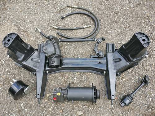

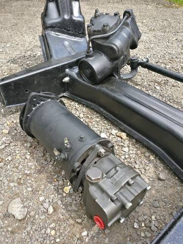

Photos from the ebay listing for future searchers:

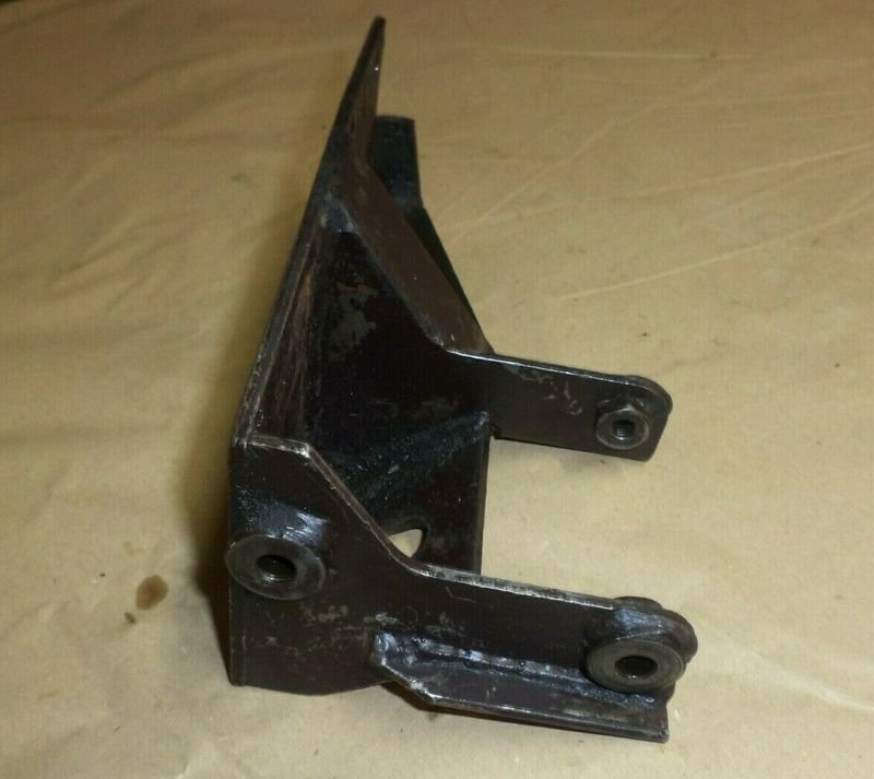

And a listing for the bracket: https://www.ebay.co.uk/itm/daimler-v...-/184516909388
From the shape, the bracket looks like part of the motor mount.

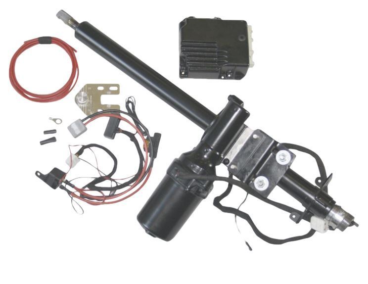

Your other option is to keep your present steering box & move to electrically assisted steering by EZ Steer. A number of people have gone that route. They are now speed & load sensitive & adjustable.
Click here.

I like the look of that EZ Steer number. That’ll probably be the route I’ll go down. It should give the modern feel I’m aiming for. Muchas Gracias

I fitted the EZ unit to my 64 Daimler about 4 years ago and to date has not given any trouble. As my car was a column auto they provided the correct column with the mounting points for the gear lever. I had to swap over the gear lever.. The biggest hassle was the need to remove a section of the bulk head reinforcement using a small angle grinder fitted with a thin cutting blade. It was necessary to remove the drivers seat. The new column fits on to the original steering box. It has made the car alot easier to drive especially when parking.

While I have not done the job I understand the "bracket/reinforcement" trimming is minor. It is not butchering the vehicle. Maybe David could post a pic.

I will give you some further information. The amount I had to cut out of the box section was a bit bigger than the electric motor shown in Glyn's photo. This is to allow the assembly to be installed using the factory mounting points the cut out is to give clearance for the motor. The EZ company did not supply any fitting instructions but did supply about 36 color photos which enabled me to see each step of the process.
When installed you can't see the unit unless toy get on your knees and look up under the dash. As I may have said before my car has oversized front tyres and to park in a shopping center was almost impossible I am 80 years young. My kit has an adjustable rheostat to alter the amount of power assist I set it in the half way position and have not altered it since. On the road it is good to drive although a higher ratio stg. box would be nice.

I have a Daimler without power steering and looked at fitting an old style system.It appears that some systems need a modified front crossmember with a depression to allow for the mechanism. I have seen such a crossmember on e-bay for £150. Alec G.
Yes. Late models fitted with Marles Bendix (Adwest) Varamatic steering. Not required with Burman Types 1 & 2 PAS boxes.
