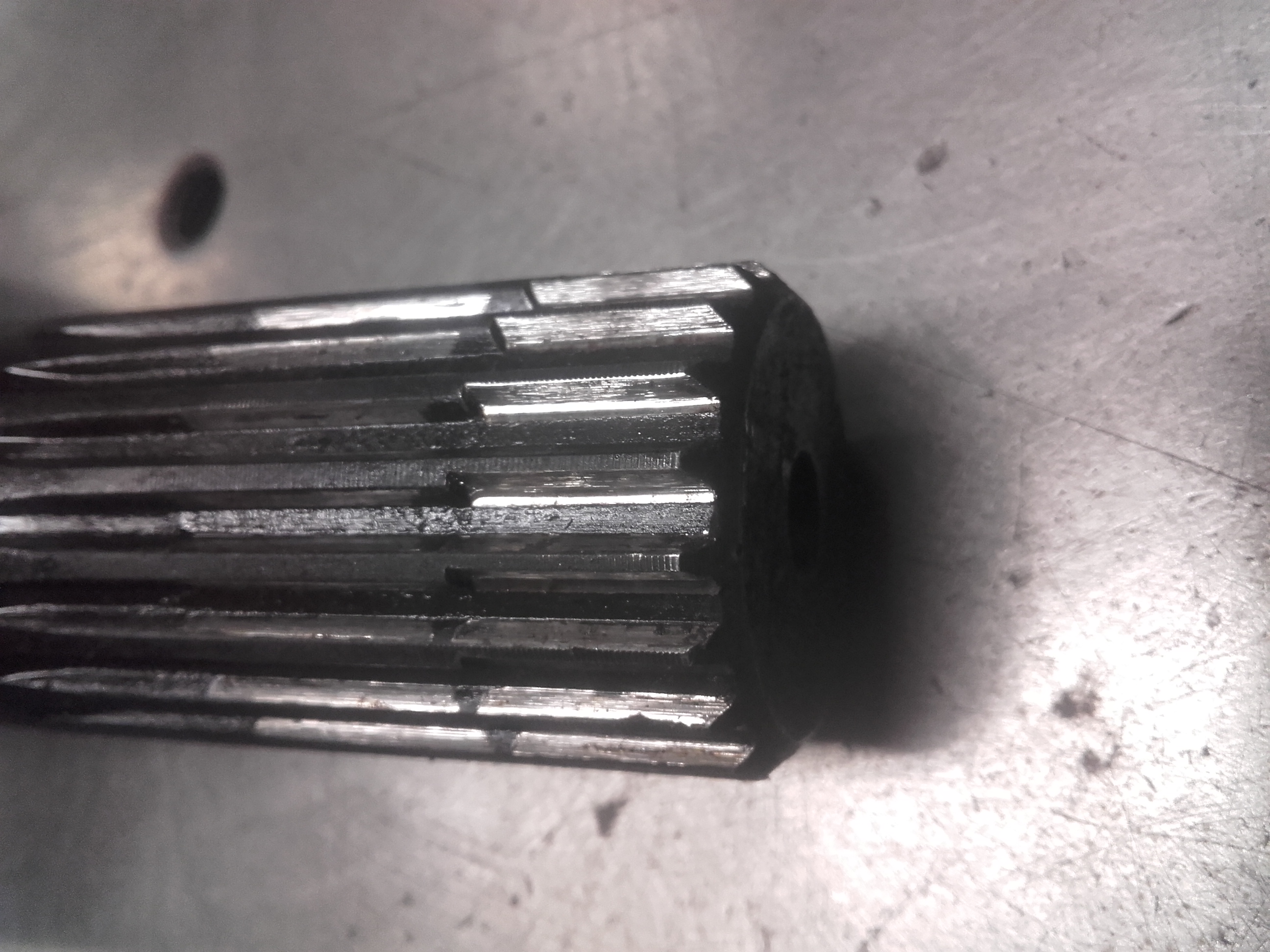

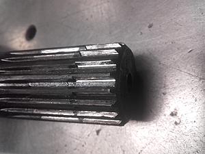

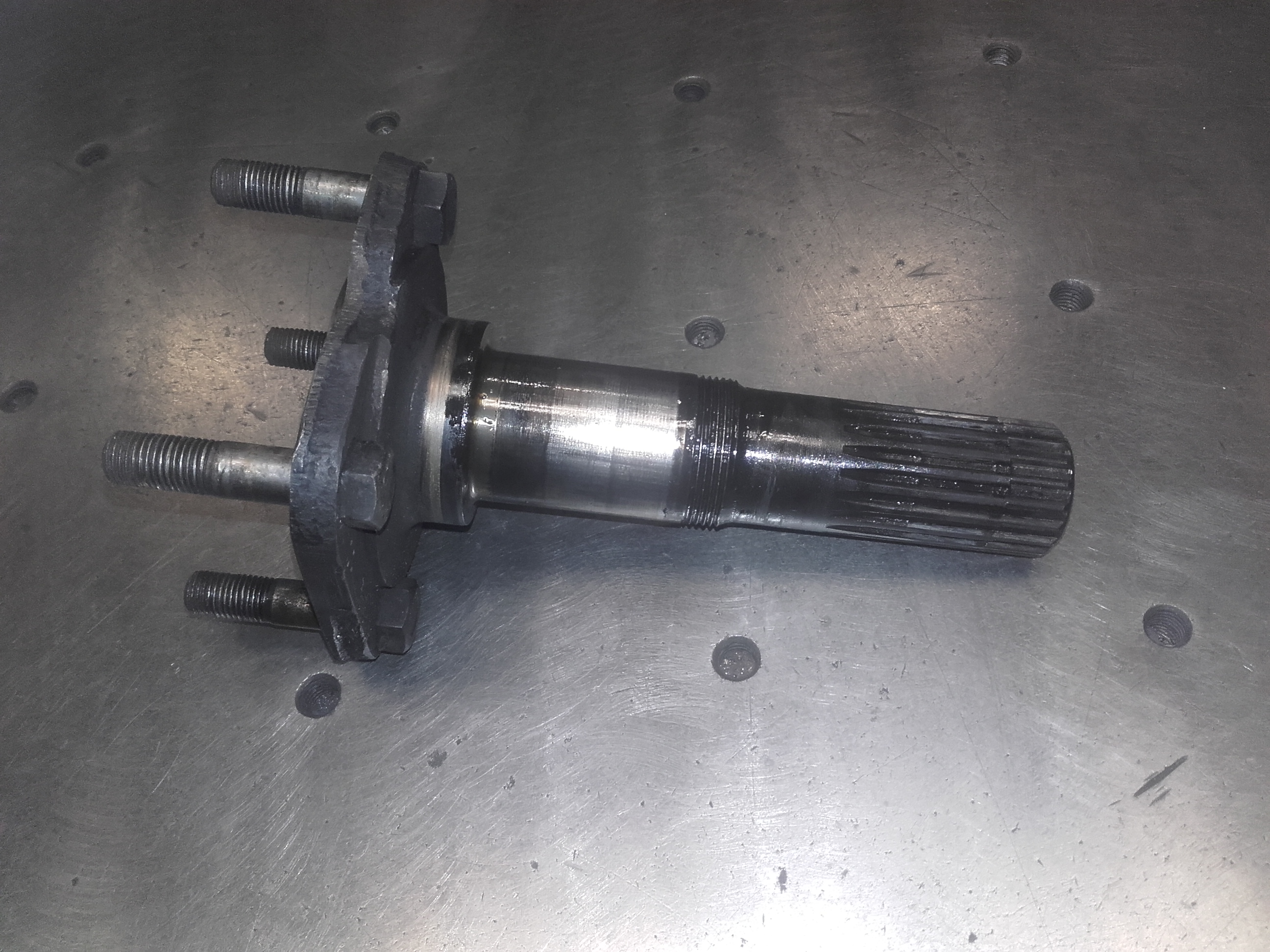

We pulled the output shafts from the differential and noticed that the splines on the left driveshaft was badly worn. Half of the thicknes of the splines was gone!
Is this a common problem? the right side looks good, I suspect the driveshaft wasn´t hardened properly
I have been looking at sngbarrat for a new driveshaft but they list it as no longer available. Ebay searches didn´t find any either.
Àny help in finding a replacement or tips how to repair it is very welcome. I would rather not weld on material and the machine new splines, it could be possible but then it would probably need to be hardened again.. lot of work with potential screw ups.

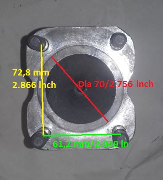

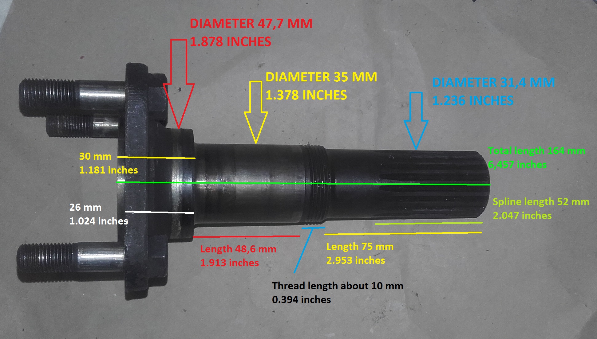

Here are some measurements on the output shaft. I hope it i enough to check if there are any major differences.
Karl
Karl
Nice work! I will have to dismantle a shaft to get the dimensions. Let me check and get back to you.
Thanks,
Ben
