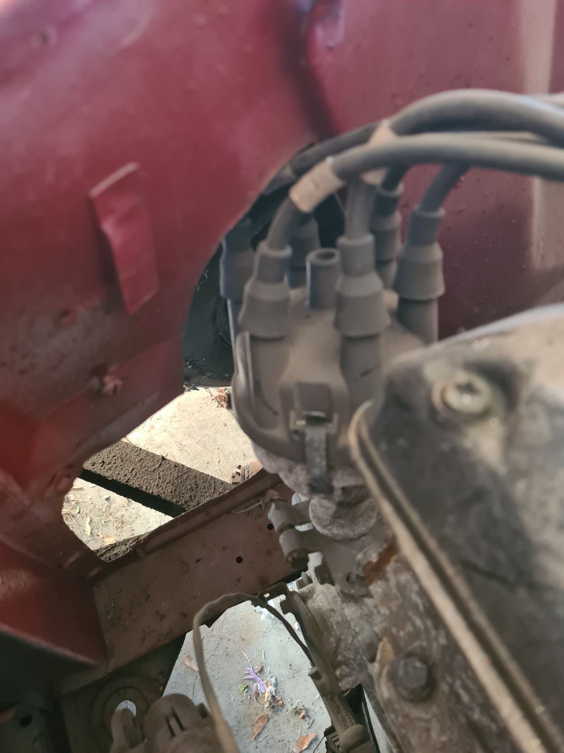

Photo of the dizzy mod that is not pleasing to me...

It's a pity so many body mods have been done already. Care to post some pics of them. People state that the AJ16 engine is a good conversion & tough as nails. It also has nice torque characteristics. Rather XK like.

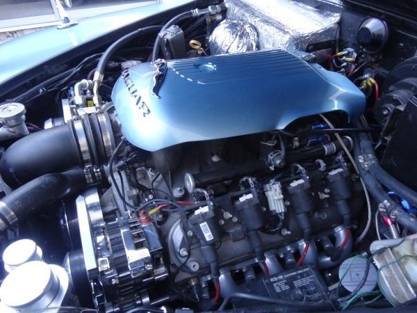

I will buck the purists as I am very happy with my restomod 3.8s. I am running a GM LS1 and would not recommend a carb V8 as most people whom want a modern restomod do NOT want a carb engine but rather a reliable fuel injected LS as they are light and reliable. Driving the 3.8s with the aluminum block LS1 to me is what the car really needed as it did not have the power it should to keep up with current cars for me. My car will go 0-60 in 4 seconds and with the wider tires and other mods the car handles much better and is a reliable daily driven sleeper. I have about 150,000 miles on her now since the car was finished about 4 years ago.
To not only match but exceed what modern cars have now, the 3.8s really needs about 400HP and the 3.8 or 4.2 just does not put out enough power. Driving it with the 400+ HP LS1 is incredible with a great smooth wide powerband. This car will haul *** and blow away most other sedans and has the cool classic look.
I will tell you it was not the easiest build but worth it. You can see my build on this forum.

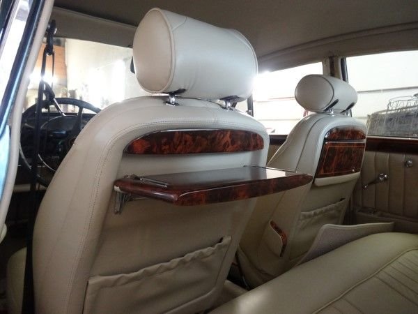

Besides the engine yes the stock 3.8s seats are very uncomfortable as they are 1960's seats with no upper back or head support. I installed the Jaguar Vadan Plas front and rear seats; the rears required sectioning to fit the fronts were not that hard other than a little fab for the seat mount.

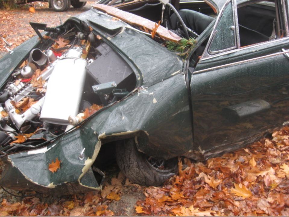

Yes ~ the OP needs to understand that if he wants to overpower the car with whatever e.g. an XKR supercharged AJ-V8 Gen III R direct-injection V8 engine having a maximum power output of 550 PS (405 kW; 542 hp) at 6,000 to 6,500 rpm and 680 N⋅m (502 lb⋅ft) of torque at 2,500 to 5,500 rpm.
Then the car's safety features require a substantial upgrade. The S Type body has no crash structure & progressive crumple zones to absorb energy. e.g. brakes (preferably with ABS), coilovers or whatever with adjustable spring rate & damping. Stiffer front torsion/anti roll bar. Fitting the rear anti roll bar that provision is already made for like the E Type & readily available for the S Type. Applying some decent castor to the front suspension. Decent correctly speed rated tyres on wider rims, a collapsible steering column. Some decent padding on the upper dash. Ballistic/pyrotechnic pretentioning seatbelts etc. etc. etc. And most importantly an impact sensor & airbags.
All doable without excessive sweat but some cost.

Yep ~ these cars don't take accidents well. Register member that fortunately survived but was severely injured. (I would not show the pic if he was deceased.) He blames the rubbers on the front sub frame letting go. Can't guarantee the veracity of that ~ sounds a bit odd to me. He left the road & went down an embankment.
