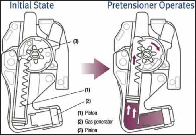

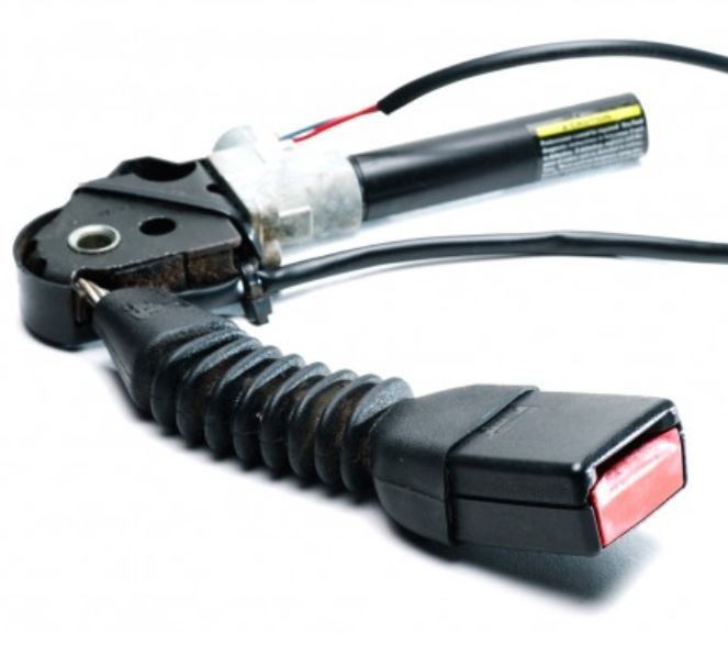

Peter ~ air bag technology & their deployment with load cells in seats etc. etc. has come a long way in the last 20 years thanks to Benz, BMW, VAG group etc.
Very basic belt pretensioner & force limiter from a humble C Class Benz. More expensive cars in the range have them hidden in the bodywork & other invisible spaces with more complex mechanisms & software. C Class is hidden between the front seats covered by the console.
In essence, You get into the car & belt up. Turn on ignition. Seat takes your body weight from load cell & belt does a check of your size by briefly tightening on you & then releasing by a known amount for comfort. You are ready to go. If the impact sensor detects preset G force it fires the pretensioner & pulls you back tightly in your seat & activates the airbags. Airbag deployment may be set at a higher limit than seatbelt pretensioning. Force is limited depending on measurements the system has recorded. Simple.
If a very light small child is seated in the passenger seat the airbag on that side won't fire & you will get a warning that the child should be seated in the rear of the vehicle suitably restrained or in an ISO car seat.
Mechanisms vary ~ basic schematic:
