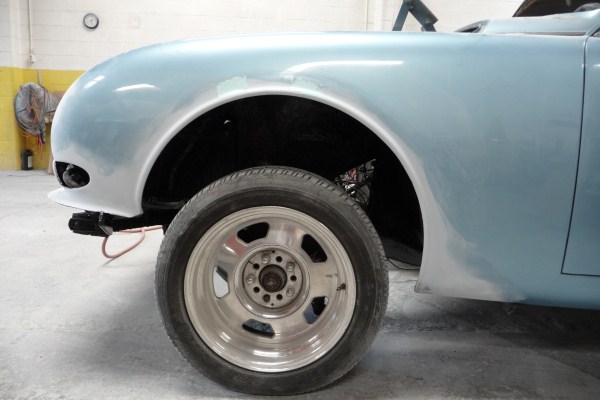

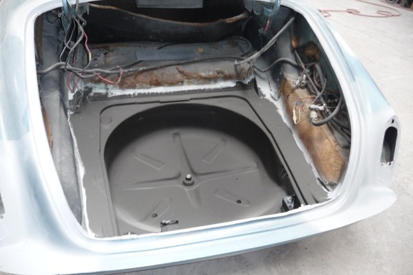

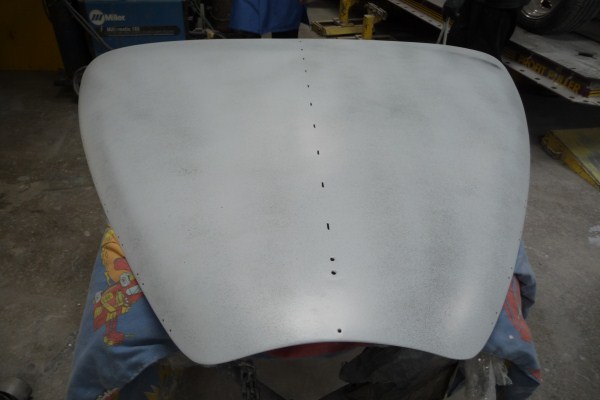

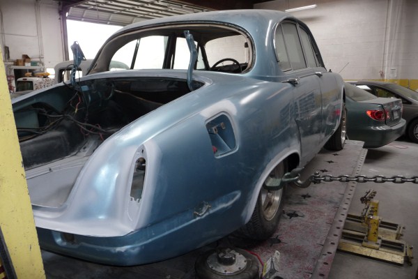

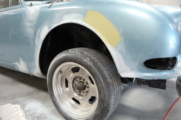

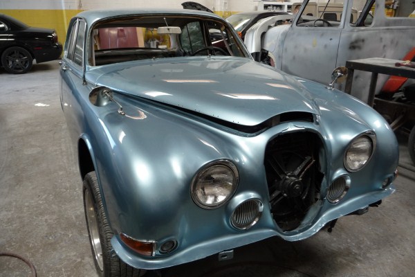

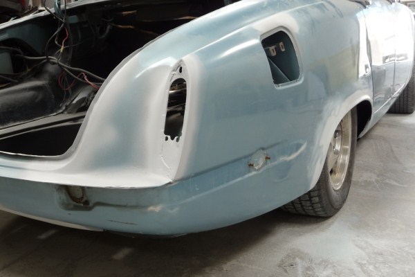

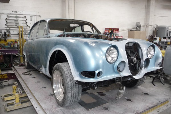

I started with what we thought was a near perfect body but we found a handful of minor repairs needed that required more time but we are close to paint! This car was almost rust free but we found a small amount under where the rear spare tire is stored.
Also the previous owner just hacked the engine bay to route lines, etc. for the previous Chevy 350. We have since sealed up every hole that is not necessary making sure to spend the time to make it look like there were nevery any holes made.
To ensure no tire rub during hard racing with the much wider 245 size tires front/rear we "rolled" the fenders. We also did some subtle pulling of the rear fenders to increase the spacing just a tad. Nobody would ever notice it but it provides plenty of clearance. These Jaguars are build like a tank as most cars that modification would be easy but these required the chains of a frame rack to pull them cleanly.
We also noticed that the car must have had a minor front end accident as the grill was pushed slightly in which prevented the perfect spacing gaps for the hood. We had to use the puller again to pull the nose out just a small amount and now it fits perfectly
The entire undercarriage has been sanded down to bare metal and everything has a POR-15 protective coating with their Metal Prep as the base coat. This will make it rustproof. We are also painting the interior floor boards and trunk with a special Quiet coating which works much like Dyna-matt but in liquid form. We are going to repaint all of these areas back to the stock light blue metalic type of paint. We will paint the engine bay black as well as the trunk. Pretty soon we will start re-instlling the new GM aluminum block/head V8!

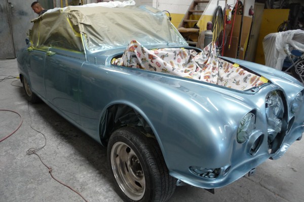

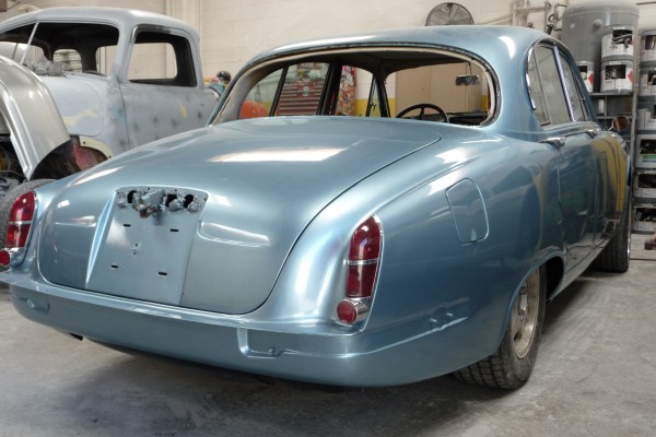

Almost there, just a little more prep work on the bottom edges of the body, a little more smoothing of the welds at the motor mounts, and a few more minor areas and we will finally be ready to shoot her with paint. I am going to paint the entire interior with the liquid version of Dyna-matt and just finished the trunk which looks good.
FYI, those cheap mags wheels are just to roll the car around as I do not want my new rims to get any overspray, etc. The rear fenders came out great as they look stock yet that subtle pulling really increased the clearance which will make fitting the large 17" x 8.5" rims with 245 size tires easy.

How about a full length shot to show off the overall lines?
So this is sort of a British flavoured hot rod Lincoln then? (the two rear quarter shots)

Not a hotrod but a sleeper as there will very little from the exterior to enable anyone to think this is not just a stock Jaguar 3.8s. I'll probably post some new pics the end of this week. This lines of this 3.8s are stock as these modifications are so minor that the only things that one can see that is slightly different will be the front seats having head-rests and the car having a wider wheels/tires. Other than that when this is car completed it will look like a stock Jaguar but underneath this stock exterior will be enough horsepower and handling to put most stock performance sedans in my rear view mirror.

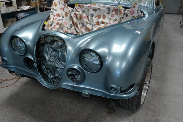

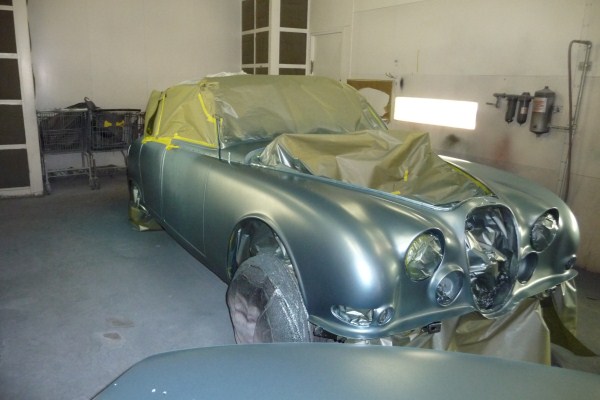

Talking First coat of paint....

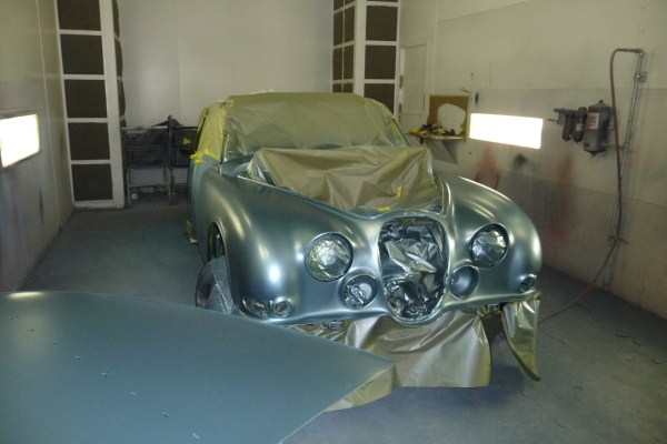

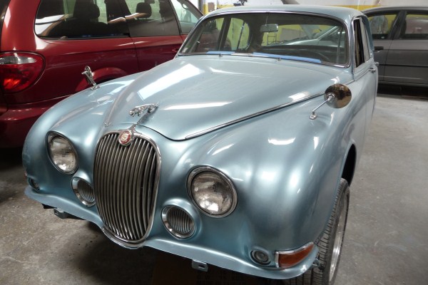

Here are shots from the first coats of paint, still a lot more painting to go but once a car recieves a coat of color it really starts to look like it is getting close to completion.
Plums - I think you can see the overall body, it is hard to get a shot as these Jaguar 3.8s's are a very long car. Anyway you can see if you compare this body to any stock body you really cannot see any noticable differences. Yet this Jaguar will be riding on 17" by 8.5" rims with 245 size tires and that kicks *** over the stock narrow 185's!
Still have to give more coats and the clear, and lastly painting the engine bay. Then color sanding, buffing so that everything looks clean and blended. Hopefully by next week all that will be done including new weatherstripping so we can start the hard work of putting all of the running gear back inside, and the last modification for front coil overs, rear "Watts Linkage", front Wilwood disc brakes, interior, etc. I pray we can get it on the street before the summer ends but it has to be complete as this will be my daily driver....

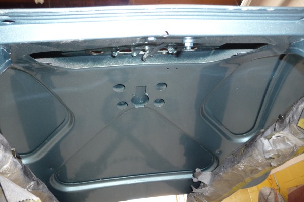

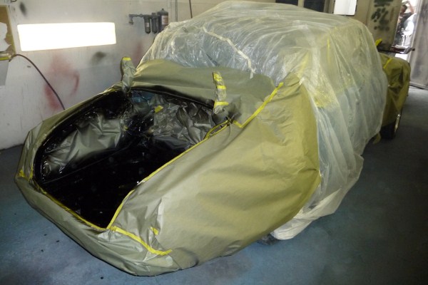

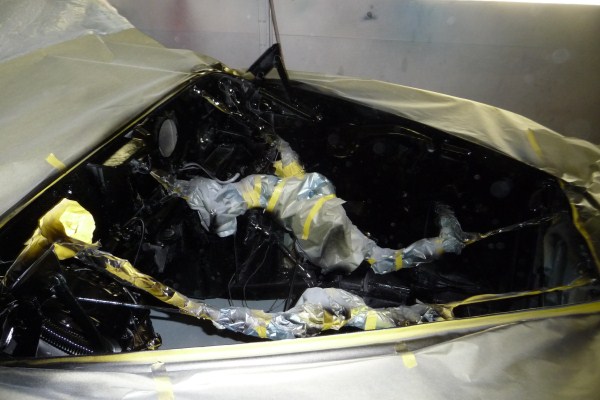

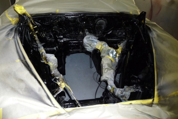

Smile Just painted the engine bay/trunk...

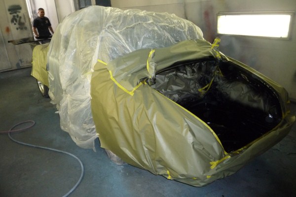

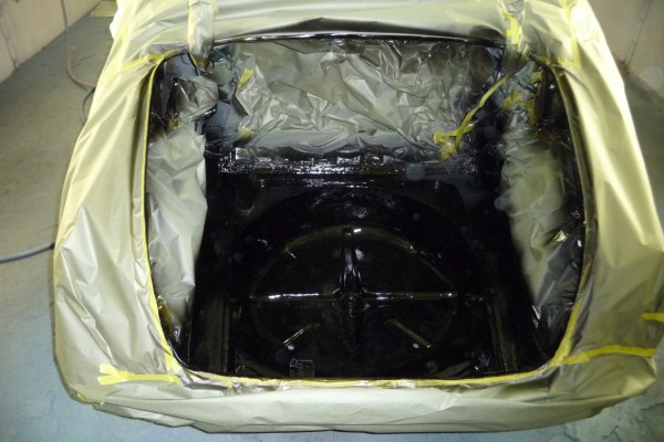

Finished the other exterior coats of paint, clear, and just painted the engine bay/trunk. Just a little more to do on the bottom sides, inner fender wells, painting the inside hood black, and then buffing the entire car's paint.

Translator, Once I take some pics after the car is buffed you should see that the color looks either the same or very close to the ones I listed here below which I believe was a factory color? I really do not care if it is a factory color or not, for me my car was that color and the quality of the body and paint was very good so I did not want to change the color or repaint it completely.
It might look like I painted the car completely but we are feathering in the paint to blend to match the roof, doors and upper fenders that did not need any body work. It was a toss up to paint it completely but this is a daily driver not a show car and I thought the old paint was still in good enough shape to blend rather than strip the whole exterior completely. My car also had the factory blue interior but I am changing that to a very light cream color to give it more contrast.
this is from Wikpedia listing it as factory opalescent silver blue paint which this and the links below seem pretty close to how my car will look like when finished.

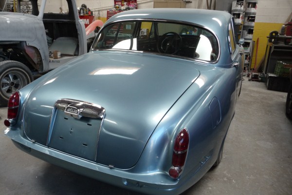

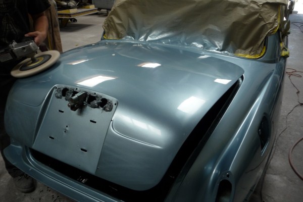

Default in the buffing process and it is looking nice
Translator, sure new paints are water based but we made sure NOT to use that type of paint and made sure to computer color match the existing paint. Here are some shots during the start of buffing and everything is looking nice. Not all of the car has been buffed yet but it clear to see that once it is all complete there will be no noticable issues to distinguish where the car was repainted versus the original paint.
Still have a lot more buffing then waxing to get the exterior paint done. Then we still have to paint the interior with the liquid version of Dynamatt and the front wheel wells but it is finally looking like a real car!

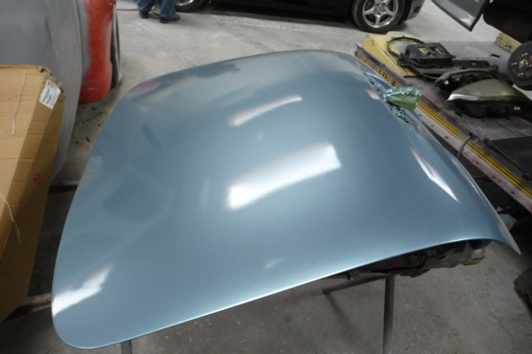

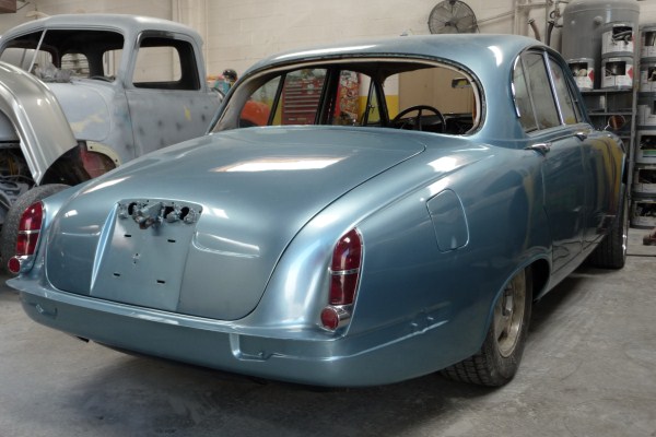

Default car is buffed...
We just finished buffing the car, now we have to take the carpet out so we can paint the liquid dynamatt paint, finish putting the trim on and painting the front wheel wells.

Old Jun 14, 2012 | 02:01 PM
It looks great. Bravo!!
Ho hum, there appears to be an interesting old truck in the background.
Do we get an added bonus as well?

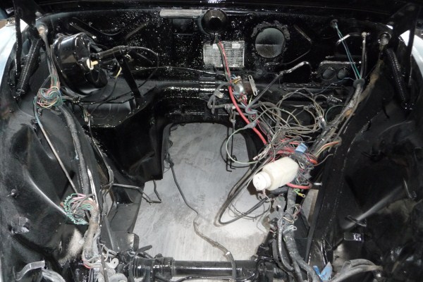

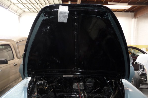

Cool engine bay painted...
That is my friends old Chevy truck...

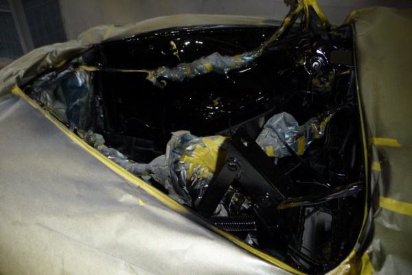

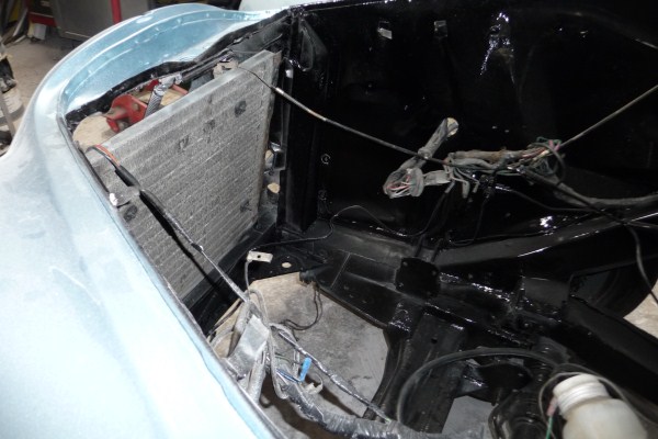

Here are some shots of the engine bay. Previously the engine bay looked like Swiss cheese as it was riddled with holes. Also we had to cut a small section of the passanger firewall for the LS1. After the welding, grinding, POR-15 paint it now looks new and clean. The new engine mounts were welded and welds smoothed so it looks like it came factory.
Just removed all of the carpets so next week the interior will be painted with the liquid dynmatt type paint. Then the front wheel wells will get a heavy under carriage coating to hide any of the welds still slightly visible after the sanding/grinding. Then the installation of the glass and we can start with the long process of the interior, drive-train, and front suspension/rear Watts linkage.

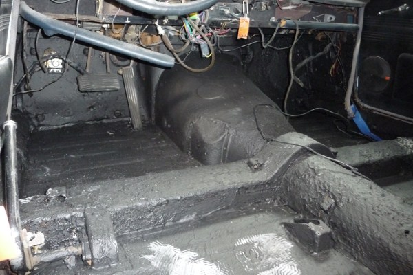

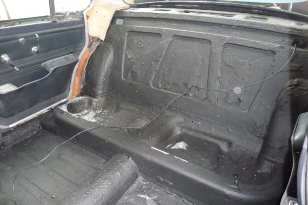

Default Interior painted...

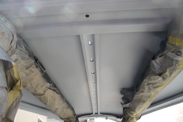

just finished the painting of the interior floors with the sound reducing liquid version of Dynamatt. Now just need to pain the front wheel wells with undercoating, put on the hood trim, install a new front windshield rubber seal, and wash and wax the car. It never goes as fast as you hope but it is looking nice.... and I cannot wait to put the car back together and really drive the car hard!
Attached Thumbnails 3.8 S Sleeper bodywork almost done!-p1090427.jpg   3.8 S Sleeper bodywork almost done!-p1090419.jpg
