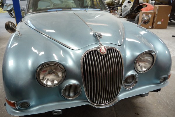

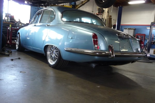

Default Bodywork Done!!!!!!
now we can start the long list of things to do in order to put the car on the street!

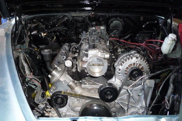

The engine and transmission are installed but with any more custom car it is often the details that slow things down. After about three different sets of headers we finally fouind a set that works without cutting etc. The new stainless exhaust pipes still needs to completed.
The front suspension has been dropped and it is being rebuilt with new bushings, adjustable coil over shocks, and Wilwood brakes. After that is done we need to finish one more modification in the rear suspension to make the Watts linkage to work, then install a new custom driveshaft, aluminum custom radiator, dual battery system, and a new AC system. Then we need to do a few mods to fit the modern Jag interior and re-install the rest of the interior.
I'll post more pics as we get closer, I hope to get the car on the street soon but I do not want to cut any corners and this has to be a reliable street car as it will be a daily driver.

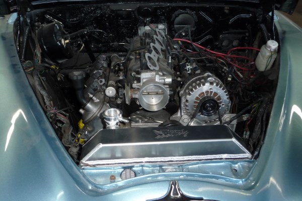

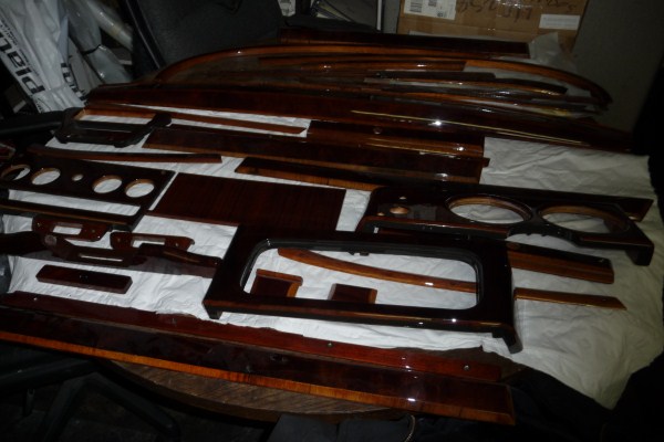

Default slowly making progress so I hope that by April it might be on the road...

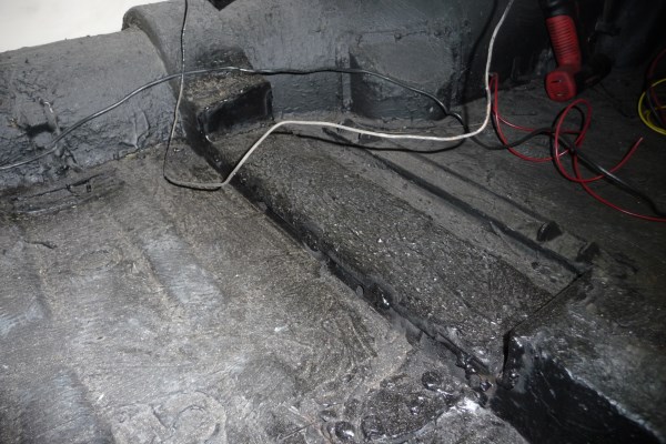

Just finished all of the wood restoration and cannot to see it installed in the car. Also mounted the custom aluminum radiator. The brakes are installed, the suspension is close but we will make some changes to the front coil overs after we get the car almost done so we can test the ride quality and get the right look for the car. The steering had to be modified a few times to clear the headers which required two universals, a common mod for rodders but just another example of the little things bogging down the build.
There is still a lot on the list before we can call it done but our goal is finishing the car around end of March and then it will likely need another month to finish the stereo and the custom electronics for my mobile office. At least things are gettng closer.
Still left:
  • modiify the front seat mounts for the electric Vaden Plas leather seats
  • set the wiring for the front seat operations
  • finish the the fuel lines and electric fuel pump set up
  • finish the computer install and wiring
  • finish all electrical to start the car, separating all accessories to a separate electrical fuse system, and the dual battery set up - seeing if we can find a way to mount the batteries under the rear seat to save room for the mobile office in the trunk
  • install custom AC system
  • install stainless radiator tube overflow
  • install new steering wheel
  • install HID headlights
  • clean and repaint front seats
  • either modifiy rear seat from the Vaden plas or reskin the stock rear seat with the Vanden plas leather
  • new leather for the door panels and headliner
  • install all the wood and dash etc.
  • order custom aluminum drive shaft
  • final the front coil overs
  • install custom stainless exhaust and muffler system
  • shake down the car and tweak suspension and engine
  • install stainless engine cover with Jaguar decals
  • install the mobile office (lazer color printer, wire binding and hole punch machine, 6000 watt inverter, usb wiring for the laptop mount, laptop mount that can provide good positioning yet easy removal for weekend use, color high speed sheet feed scanner, see if we can install a microwave and frig and still have trunk space)
  • install new stereo - separates in the doors and either four 8" or four 10" subs in the rear deck with a pop out nav unit, amplifiers either under the seats or in the trunk, alarm, extra screens along the dash storage tray so I can display several web pages at the same time)
Crossing my fingers we can finish all of this so I start using the Jag as the daily driver....

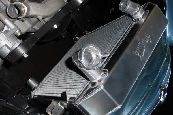

Do you have a website or a photos site like shutterfly, Flickr, or photobucket where you are keeping a collection of images? If so, I would love to look at it. I would be very interested in information and detail photos of your seat installation including floor modifications and wiring.
What was the vendor source for your aluminum radiator?

I will have to look up the vendor for the radiator and let you know. It was the same one I used for my custom Datsun street cars as they will custom make it to your needs, amount of rows, how many fins per inch, etc.

The wood I was lucky to have a friend whom used to do that type of work professionally. I had him repair the wood and do the coloring and then we used a body shop familiar with wood clear coating to do the clear coats; we did one last coloring after the first coat to give some of the depth for a few areas. It is not concours but plenty good for me. Will post more here as we get closer to the completion.

just finished the painting of the interior floors with the sound reducing liquid version of Dynamatt. Now just need to pain the front wheel wells with undercoating, put on the hood trim, install a new front windshield rubber seal, and wash and wax the car. It never goes as fast as you hope but it is looking nice.... and I cannot wait to put the car back together and really drive the car hard!
Wow great progress, it will look a stunner on the road. I am currently doing a complete rebuild of an unrestored 340, you can see my blog in this section. Although I am not yet at this stage I am interested in what you used as a liquid sound proofing like Dynamat.
What is the product called and where can somebody purchase this?
Did it also work out cheaper that the matting from Dynamat?
Is it spayed using a standard paint gun or does it come in an aerosal?

I used "Quiet Car" but that is just because a friend of mine had left over paint from his 240z so I used it in the Jaguar. It is much like Por-15 thick stuff painted on by hand or with a less expensive gun as well. I plan on putting Dynamatt over it as well since this is a luxury 4 door to try to keep it as quiet since the car will have such a high horsepower motor under the hood. I also plan on trying to use a set of mufflers to quiet it yet still give good flow; that is always the trade off great flow big noise, quiet is more restrictive so I will strike a balance for my personal taste....

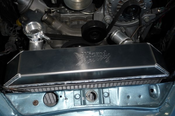

Default radiator pics...
Originally Posted by MK2
Primaz,
. Did you do that yourself or source that to a specialist?
Thanks so much and congratulations.
Lin
Here are some pics that will give you the company we used to make the custom radiator...

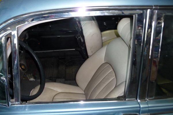

Default Front seat mods just about done...
Here are some early shots of the front seat mods to allow full travel of the Jaguar Vanden Plas seats into the 3.8S
This is exactly what i want to do but with XJ40 seats, was this hard to do and do you have any tips/dimensions I can use. how did you determine how much to cut out.
