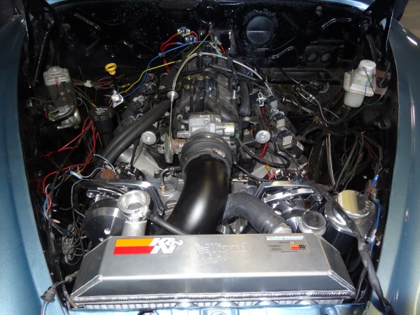

Here are some more pics,
the cold air intake is done and came out clean, it is routed thru the passenger inner fender and we fabricated a louvered metal shroud to prevent water from entering via the wheel well. The air has been ported from the passnger horn gril so it will give good flow.
an extra brace for the steering rack linkage and we had to strengthen the frame to hold the brace.
brake booster on my car was moved to the battery location but now that I am putting the modern AC system which is designed to mount on the stock battery tray we re-routed the brake booster to driver inner fender well. Brakes are all done.
more shots of the serpentine setup. If there was more of a gap between the radiator and the pulley, etc. you would see more shine but it looks very cool.

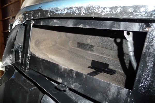

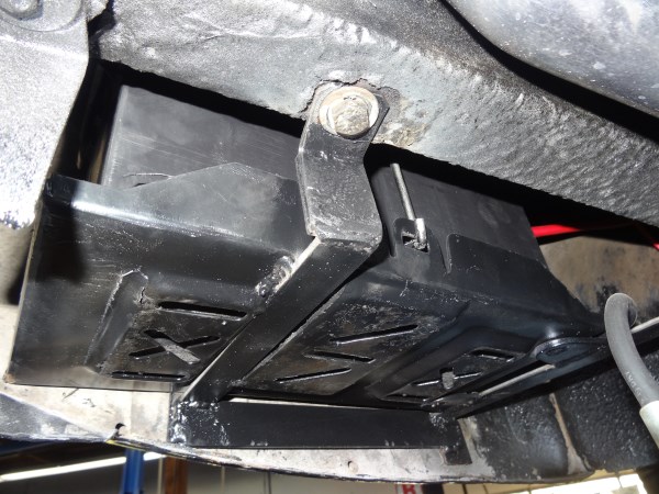

I am using the Jaguar 3.8s kit from Retroair, that kit has the evaporator blower unit designed to mount wear the stock battery used to be. There are some nice pics of his kit as it really looks like it came that way from the factory once installed but it is a tight fit for the evap/blower unit and I was told a little tight for the kits ductwork setup but it all is designed to fit ; he has a version for the 3.8s and MKII's. I was lucky since using a GM v8 which is so popular to restomod a huge variety of cars that there are so many serpentine kits to allow more variations to mount the AC compressor and other accessories as well as many options for radiator connections and engine mounts, etc. I wish you luck on making mounts for the AC compressor as that could be very difficult. I will take some pics once we mount the unit so you can see how it fits. Things are all fitting but we need to make sure we do it in the right steps as it is getting tight in that engine bay.
What I am doing is putting the batteries in the rear but I have this crazy mobile office set up with a full network color lazar jet printer, color scanner, refrigerator, microwave oven, huge low frequency pure sine wave inverter in the trunk so for power requirements and space requirements we mounted a total of three batteries. There are two 6 volt AGM batteries in series on the passenger side under the rear fender where one of the gas tanks used to be; then there is a standard full size battery on the driver side where the other gas tank used to be. These utilize a special battery isolator system mounted back on the engine bay firewall.
The batteries are removable from under the car and the wiring is routed up to the trunk. The two AGM batteries will give a huge resever of power so that all of the coputers and accessories can never drain the main battery. We also added a modern fuse set up and removed most of the electrical to that to keep the stock set up just to start the car as the Brittish electrical has a bad reputation and I need this to be a reliable daily driver.

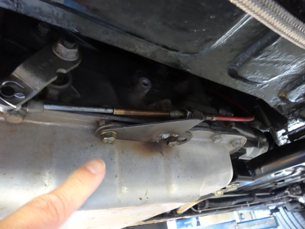

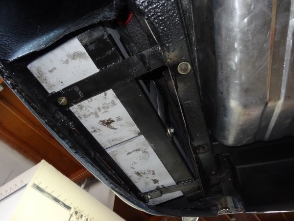

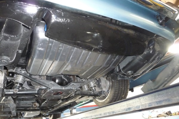

Default batteries mounted, new driveshaft, shifter bracket pics...

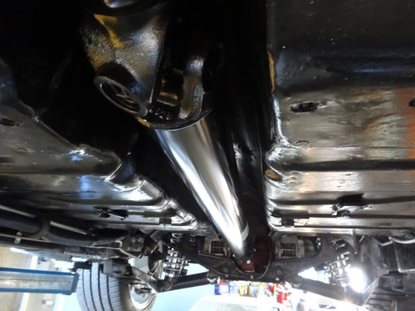

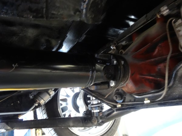

here are the three batteries mounted, new drive shaft and new bracket to keep the stock column shifter functioning with the new GM tranny...
Attached Thumbnails 3.8 S Sleeper bodywork almost done!-dsc01874.jpg   3.8 S Sleeper bodywork almost done!-dsc01875.jpg   3.8 S Sleeper bodywork almost done!-dsc01876.jpg   3.8 S Sleeper bodywork almost done!-dsc01879.jpg   3.8 S Sleeper bodywork almost done!-dsc01880.jpg

Default ready to fire it up in a few days....

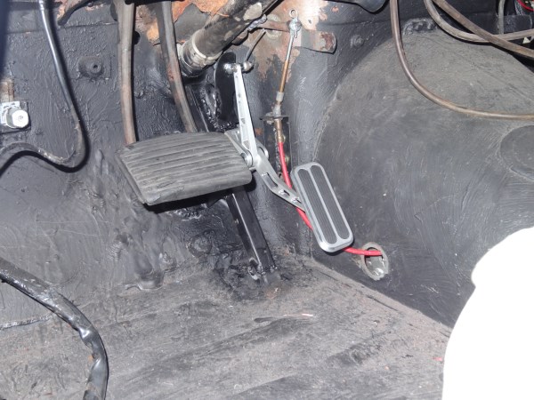

Finished the new gas pedal, the linkage modifications to keep the stock column shifter operation, later model windshield wiper motor. The small bits always take more time than expected. We just need to drill a small hole for a vacuum line off the cold air intake and put gas and fluids into the beast in order to start her up! I hope to bring the car next week to get a new custom stainless exhaust system! You can still see minor bits in work in progress like mounting the Retro-Air air conditioning system, the heater box, and new steering wheel, and that list goes on when you go beyond the engine bay..... I can see why some well done restomod cars sell for more money than a stock restored car as if you have the money and do not want to take so so much time you could just plunk down cash at a Barrett Jackson Auction, etc....
Attached Thumbnails 3.8 S Sleeper bodywork almost done!-dsc01883.jpg   3.8 S Sleeper bodywork almost done!-dsc01884.jpg   3.8 S Sleeper bodywork almost done!-dsc01890.jpg   3.8 S Sleeper bodywork almost done!-dsc01885.jpg   3.8 S Sleeper bodywork almost done!-dsc01889.jpg

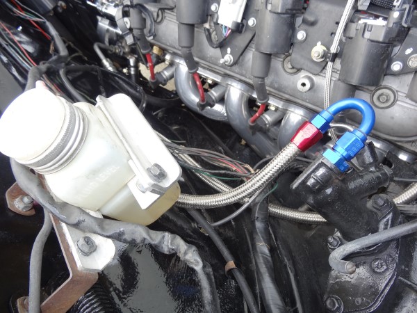

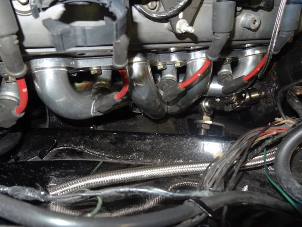

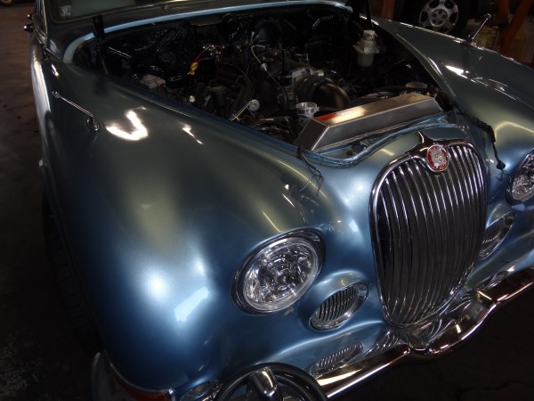

Primaz, it looks like you're in the home stretch. I can't believe you managed to squeeze headers into that engine compartment. Judging from the diameter of the throttle body intake this thing should scoot pretty good. The pedals are an absolute hoot - old school Jag just connect the brake and clutch arms with a single pedal for the automatic model, right next to the high tech billet aluminum accelerator linking you to all that horsepower. It's perfect. Good luck with the fire up and first run. No tickets.

Doug,
It was third time the charm as we tried two other slim headers that did not fit and the third was the charm. So that is why there are two arms; that stock brake pedal is so huge that I think we might look for one to match the new throttle that is smaller. I am so eager to get this Jag on the road and it is amazing all these little things that seem to take so much time. Thanks for the reply as it is not easy to keep up all this work when it seems to take forever. Too bad we are not closer to each other as it would be cool to have a restomod Jaguar cruise with everyone on this forum whom restomodded their Jaguar when we are all done!

Default LS1 installed and fired up with open headers...

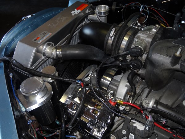

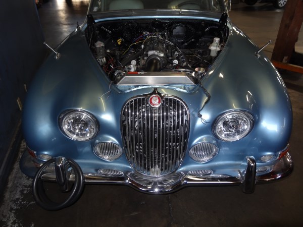

The motor is now installed and here are some pics so far and a youtube video of it running with no exhaust mufflers etc. installed yet just running open headers so it's a beast now Exhaust should be finished next week. It will be full stainless to prevent any rust and mufflers to keep the beast hidden as more of a sleeper. Still needing to finish stereo, interior, trunk mobile office, clean up the wiring, install new steering wheel, so more to come...
Attached Thumbnails 3.8 S Sleeper bodywork almost done!-dsc01932.jpg   3.8 S Sleeper bodywork almost done!-dsc01931.jpg   3.8 S Sleeper bodywork almost done!-dsc01918.jpg   3.8 S Sleeper bodywork almost done!-dsc01919.jpg

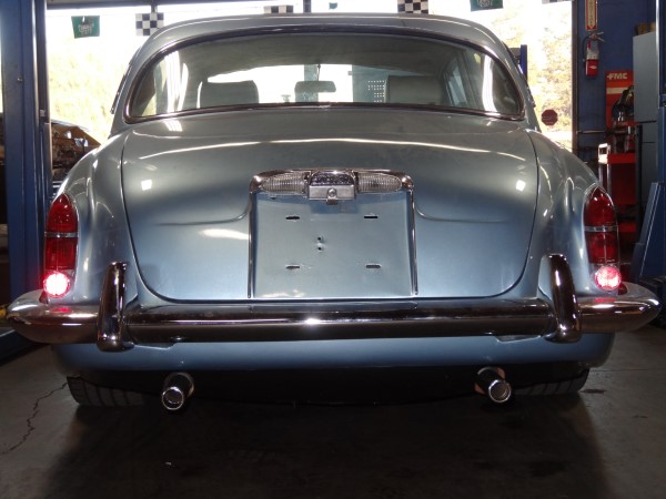

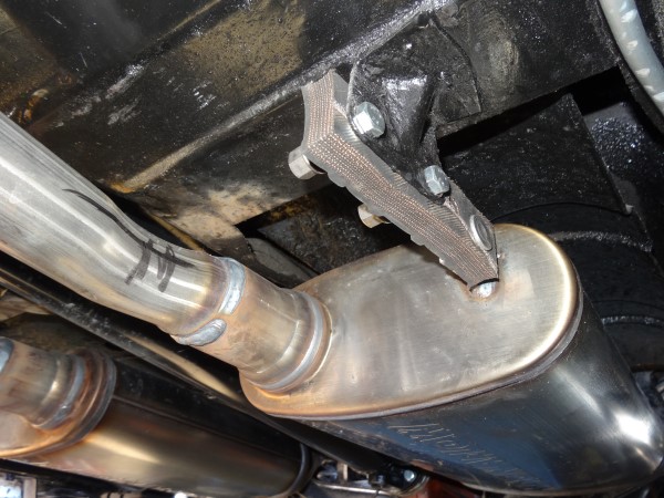

Default stainless exhaust system is done....

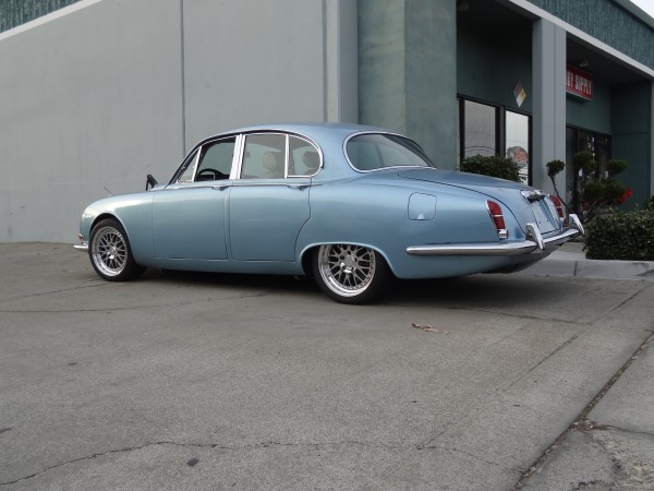

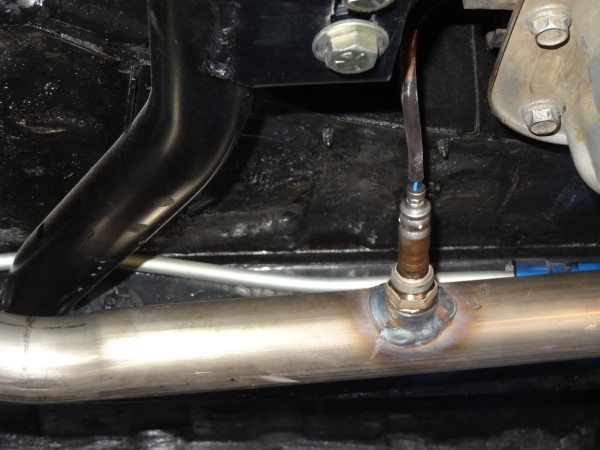

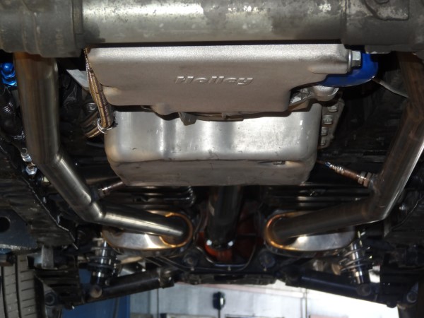

Lin, I will try to look up the liquid sound dampening product but I am not relying on that alone as I am also using Dynamatt on top of it as well.
The exhaust system is complete and is all done in stainless steel to prevent any worries about rust.
Attached Thumbnails 3.8 S Sleeper bodywork almost done!-dsc01953.jpg   3.8 S Sleeper bodywork almost done!-dsc01952.jpg   3.8 S Sleeper bodywork almost done!-dsc01947.jpg   3.8 S Sleeper bodywork almost done!-dsc01946.jpg   3.8 S Sleeper bodywork almost done!-dsc01937.jpg
3.8 S Sleeper bodywork almost done!-dsc01935.jpg   3.8 S Sleeper bodywork almost done!-dsc01941.jpg
