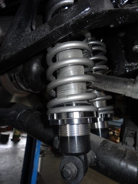

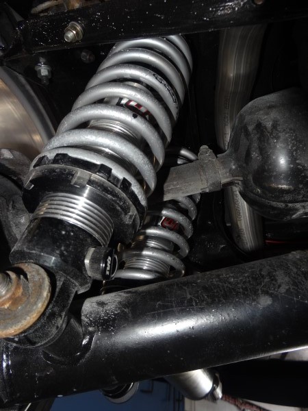

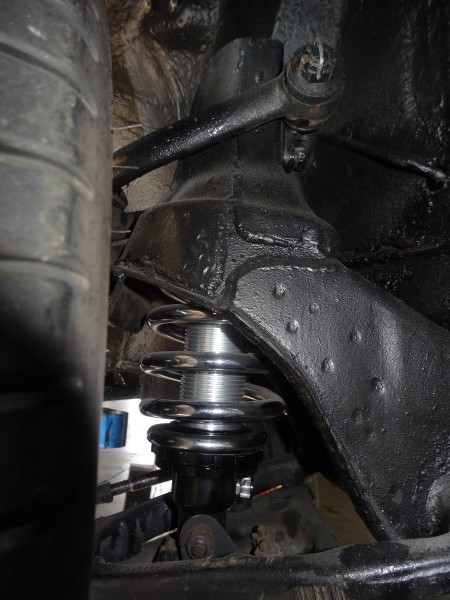

Hi Primaz,

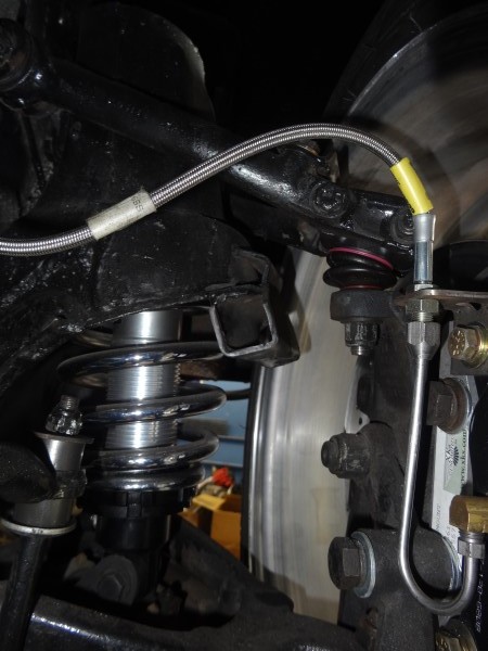

Would you mind sharing some information about your front coil overs? Which model did you use? Do you have any photos? Did you need to modify the crossmember turret to accommodate the coil-overs? I am using the stock 3.8 engine with Moss gearbox and overdrive with perhaps some weight added due to the rack and pinion I have installed. How does one determine the model of coil-overs needs?
Finally, how does one install the coil-overs compared to the stock coil springs? Thanks very much!

I used the QA1 adjustable coil over shocks and have posted pics, take a look either at this posting or my other posting on beefing up rear suspension as there are lots of pics. The front was a bit harder especially with the Jaguar having tapered springs rather than springs of the same diameter top and bottom.
MK, I will try to take some more pics as I realized most of my pics were of the rear coil overs.....

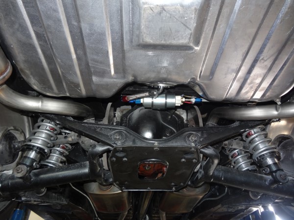

Originally Posted by MK2
Hi Primaz,
Lin
Front suspension novice

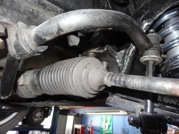

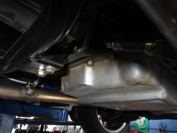

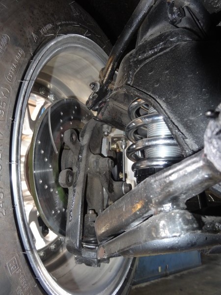

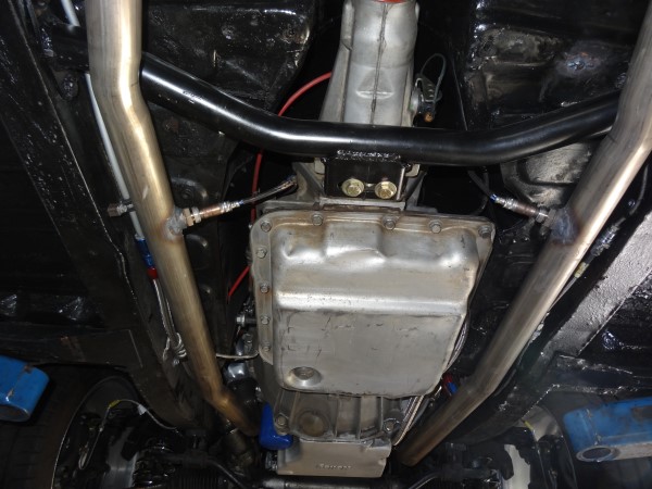

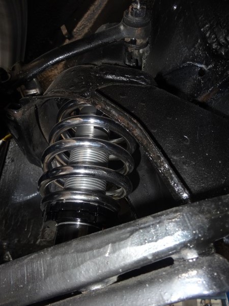

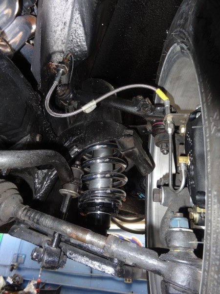

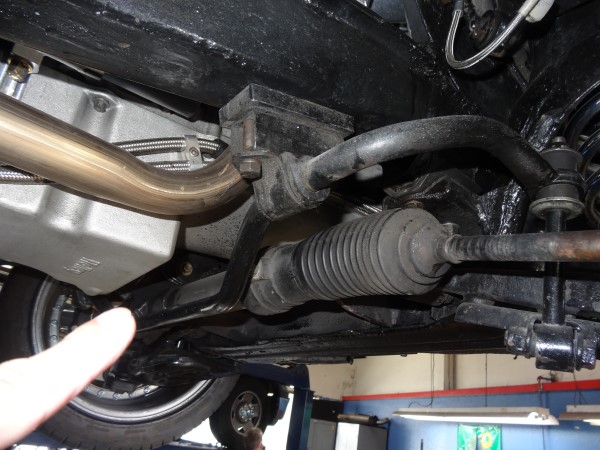

Here are some pics of the front suspension Lin. We just installed the front sway bar as well. I included a couple of shots of the rear coil overs along with a couple shots of the exhaust with CO sensors
Attached Thumbnails 3.8 S Sleeper bodywork almost done!-dsc02034.jpg   3.8 S Sleeper bodywork almost done!-dsc02033.jpg   3.8 S Sleeper bodywork almost done!-dsc02023.jpg   3.8 S Sleeper bodywork almost done!-dsc02024.jpg   3.8 S Sleeper bodywork almost done!-dsc02025.jpg
3.8 S Sleeper bodywork almost done!-dsc02026.jpg   3.8 S Sleeper bodywork almost done!-dsc02027.jpg   3.8 S Sleeper bodywork almost done!-dsc02029.jpg   3.8 S Sleeper bodywork almost done!-dsc02028.jpg   3.8 S Sleeper bodywork almost done!-dsc02030.jpg
3.8 S Sleeper bodywork almost done!-dsc02031.jpg   3.8 S Sleeper bodywork almost done!-dsc02032.jpg

Those are great! Thank you. It looks as if the coil overs were installed without modification of the turret? Can you share the part numbers for the coil overs you used? I will still talk with the supplier, but it would be nice to start with what worked on your car.
You are the best. Thanks again!
Lin

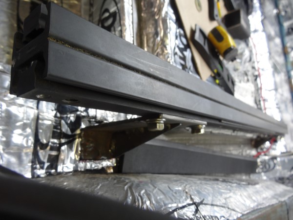

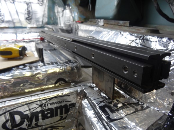

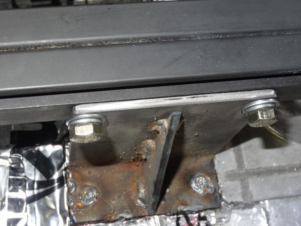

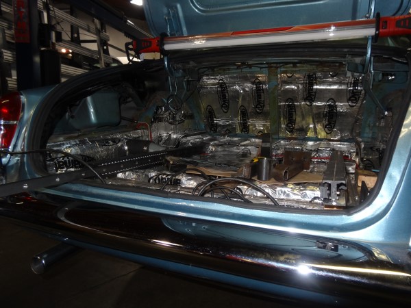

Default Dynamat installed...

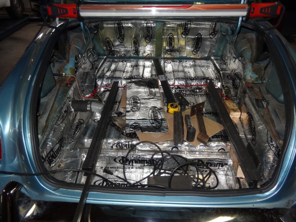

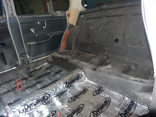

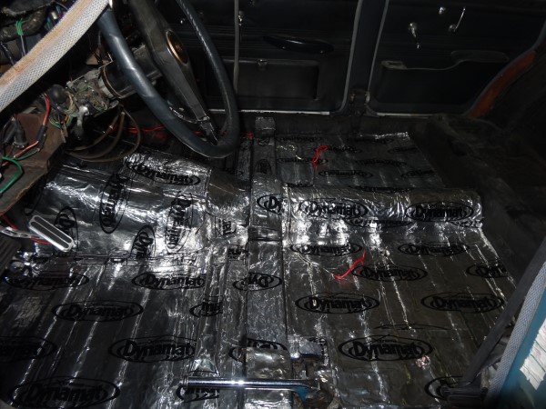

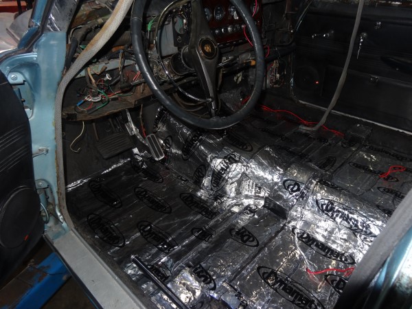

Trying to get ready for bringing the Jag to the interior shop. Dynamat installed on the interior and trunk over the layer of sound insulating paint. Starting to work on mounting the trunk rail system. Each rail is rated for about 700-800 lbs. The two rails will have a custom aluminum frame to enable all of the mobile office to be mounted. This will enable the entire trunk to slide out for easy access to the refrigerator, microwave, color lazar jet printer, high speed scanner, hole punch & pro binding machine.
Attached Thumbnails 3.8 S Sleeper bodywork almost done!-dsc02043.jpg   3.8 S Sleeper bodywork almost done!-dsc02042.jpg   3.8 S Sleeper bodywork almost done!-dsc02041.jpg   3.8 S Sleeper bodywork almost done!-dsc02040.jpg   3.8 S Sleeper bodywork almost done!-dsc02039.jpg

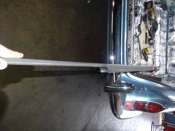

Default mobile road warrior....

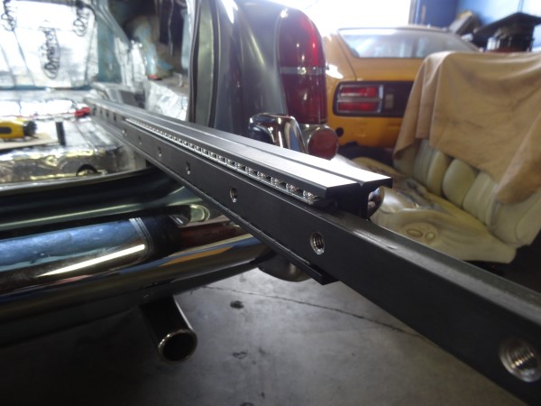

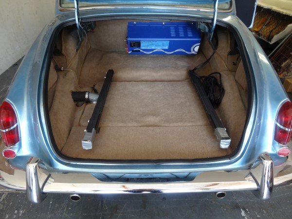

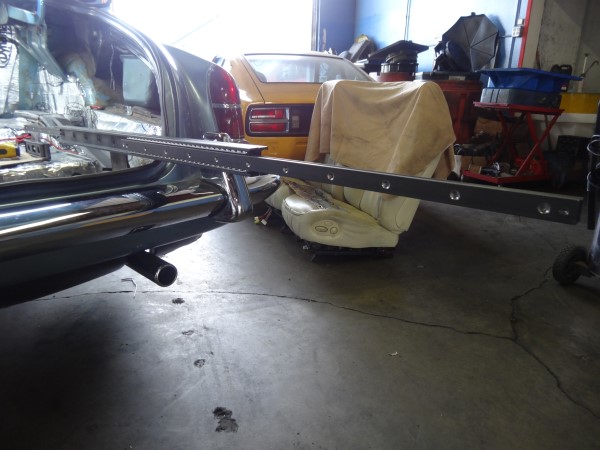

check this out.... By next week both rails will have the custom mounts to hold them in place. These rails are made for industrial applications and they are so strong you can put your entire weight on one rail and it will hold you with ease. This will make it easy to access any of the office tools and when work is done grab a cold beverage chilled to 40 degrees
Hmmm.... I wonder if there will be any room left to stuff a sexy secretary in the trunk????
Attached Thumbnails 3.8 S Sleeper bodywork almost done!-dsc02049.jpg   3.8 S Sleeper bodywork almost done!-dsc02048.jpg   3.8 S Sleeper bodywork almost done!-dsc02047.jpg   3.8 S Sleeper bodywork almost done!-dsc02046.jpg   3.8 S Sleeper bodywork almost done!-dsc02045.jpg

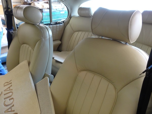

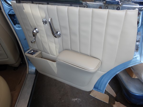

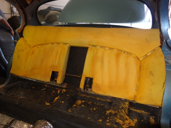

Default I think these will be the last progress pics...

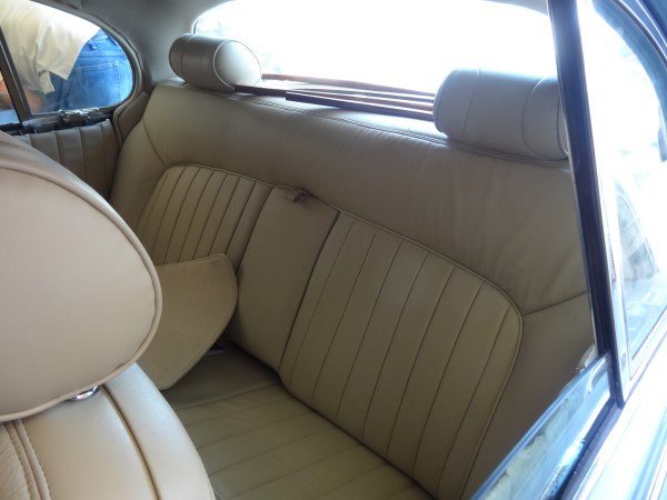

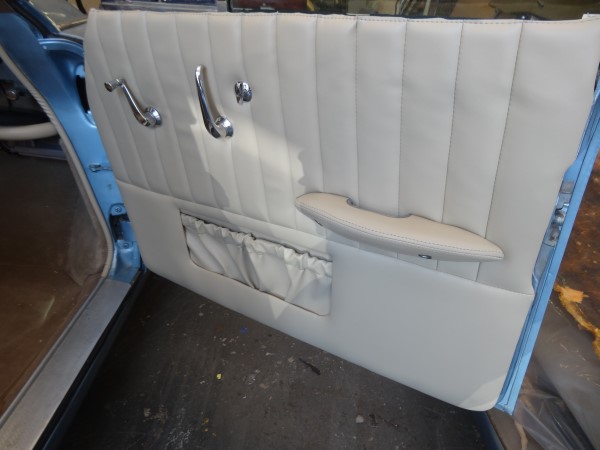

After these pictures, my next posting should be the completion photos! The interior is coming along very nicely and only will be a few more days before it is done. Then there are still small bits: installing the wood, new steering wheel, AC, heater, troubleshooting steering rack, and finalizing the rear trunk rack and shaking the car down. I hope to post the completion photos by the end of May if all goes well...
The stereo really came out great! It rocks! All speakers are completely hidden. Separate Focals hidden in a custom rear deck and custom kick panel enclosures in the front with 6" JL Audio subs in a custom speaker box located at the passenger floor that kick like 10"'s. I cannot wait to make this my daily driver.
Attached Thumbnails 3.8 S Sleeper bodywork almost done!-dsc02549.jpg   3.8 S Sleeper bodywork almost done!-dsc02548.jpg   3.8 S Sleeper bodywork almost done!-dsc02416.jpg   3.8 S Sleeper bodywork almost done!-dsc02079_renamed_26506.jpg   3.8 S Sleeper bodywork almost done!-dsc02546.jpg

The seats look fantastic! Got any photos of you speaker installations?
Lin
