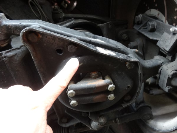

Here is a good picture of why the stock A-arms are not good for lowering the car and putting maximum tires on a Jaguar. The stock A-arms when you put coilovers and lower it the A-arms will hit the rim and to stop that temporarily I had to limit the turning ability and then it turned like a bus. Also when you lower it you change the geometry and you cannot shim it enough so you will waste a tire in literally a few thousand miles.
The old A-arms were close but we could not get adjust the camber enough and they were not the same. Basically at max we were still a little too negative. The tire wear was ok but probably lost about half of the tire life. Michigan Metal Works made an attempt to make a drop spindle but the weird shape could not take the heat treatment to make it strong and it ended up looking like a fire breathing dragon melted it into an unrecognizable piece of scrap metal. So instead of that we re-measured everything and changed the design so we would have enough camber adjustment without a new spindle. This set up will allow you to fit a 17" x 8.5" rim on all four corners with 245 wide tires with no rubbing and lower the car for a nice stance.

yes I see you have got better turning ability ,
but how much have you moved the front upright pivot point to get your camber that you want,
running 19" wheels on mine.
thanks,
David.

I will try to let you know once we install these improved lower A-arms. The current lower custom A-arms with the additional QA1 coilovers were the only new custom pieces not stock (other than some minor mods to mount the sway bar) and while we came close with adjusting it with the shims it could not be adjusted more due to the A-arm itself. The new ones reduce the distance from the bushing to the ball joint mount 1/2" shorter toward the bushing will then enable plenty of adjustment with shims to get both sides perfect. We also changed the openings to mount the coilover to fit better as the old one needed some mods to make it fit. When you are making custom one off suspension parts and while I shipped them a stock suspension setup they did not have the car nor coilovers, etc. so sometimes things are not perfect but this new set should be...
I think that if anyone wants to go full coilovers this new MMW lower A-arm with QA1 coilovers will enable it to be done on the stock suspension. Having the Jaguar with 245 wide tires front and back really makes a huge improvement in the handling.
