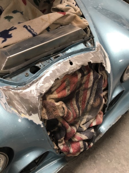

Default Another tip regarding the body on a 3.8s
The old school method to join the front fenders as well as shaping the body was lead. Lead besides being a hazard for your health/environment, is not an ideal method for a performance Jaguar as the lead will flex over time and create cracks in your paint. I should have removed all of the factory lead but found out the hard way that the front fender seams had both cracked the same on both fenders.
To eliminate this from occurring we got rid of all of the lead and they used lead not just on the seam but all around that section around the front grill. New steel was cut and made to weld and provide an even stronger connection to the body panels than stock. Here are some of the shots during the repair/upgrades. It did take about 60,000 miles but those cracks look so annoying so if anyone is doing a full paint you might want to consider removing all of the lead welds. I did the same thing on most of my Datsun 240Z's but they used less lead; the Jaguar used it on the seam and it seemed like they used it instead of filler?
Attached Thumbnails 3.8 S Sleeper bodywork almost done!-519150454.jpg   3.8 S Sleeper bodywork almost done!-519249949.jpg   3.8 S Sleeper bodywork almost done!-519349184.jpg

Originally Posted by csbush
It looks really nice. But I absolutely would not get rid of the lead. It is a much better seam sealer and filler than any plastic body filler. I have never heard of lead cracking- the metal seams under the lead perhaps, but not the lead.
Any yes- Jaguar and all the other car manufacturers of that era used lead to seal seams and fill imperfections. It is not used in manufacturing today because the tolerances are better, and it is too time consuming. It is used in high end restorations because give the choice between plastic and metal, it is an easy choice.
I agree if you are comparing it with plastic BUT I am NOT using plastic. I would recommend using steel and welding over lead. I have other cars with lead seams and you always chase those cracks. For example 90% of every Datsun 240Z will have lead cracks at the rear quarters. Lead will crack over time and if you have a higher performance set up they will crack even faster. Datsun 240Z cars with big HP will have cracks at the windshield lead seams often if the lead is not removed and the metal is not welded.
I drive my cars a lot and drive them hard. If you baby your Jag and do not put many miles the only thing you are doing is delaying the inevitable cracks. Many Jag owners do not drive their cars that much . My car is a lot more horsepower than most but if you drive it a lot the cracks will show up. I drove over 65K miles in the first two years after this build. For me I own my car to enjoy it not collect dust and keep it in the garage and put very few miles on it.
The only way to not have that happen is weld with no lead and no filler/plastic. Doing it without lead is more work than using lead as you will often need to fab a bit of new steel contoured and then weld before you are ready to do the final body work. I am mainly talking about the seams. On all seams I would NOT recommend to use lead but instead weld with steel. If you want to keep the lead they use for non seams that is up to you but if that part can flex I would not keep it lead.

I suppose if structural stresses are breaking the metal seams between the chassis and fenders, then yes, you would have to remove the lead to get at the metal panels to weld them. Lead was never meant to be a structural component, but a filler to seal and smooth the welded seams (lead is less porous than steel). It is also used to help with gaps around doors.

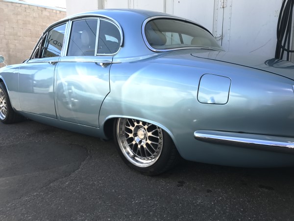

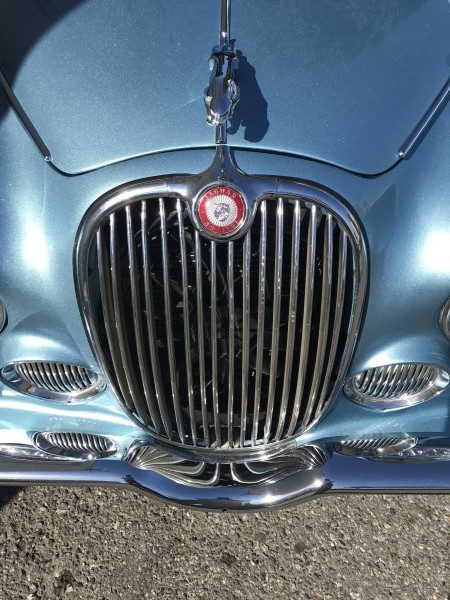

Default Lead removed and car back on the street...
Attached Thumbnails 3.8 S Sleeper bodywork almost done!-img_3366.jpg   3.8 S Sleeper bodywork almost done!-img_3360.jpg   3.8 S Sleeper bodywork almost done!-img_3364.jpg

Failure of lead leading to cracking is mainly due to the lead not being allowed to move freely, you may think I'm going mad, but bear with my thought process.
A lead roof must have movement joints, if it does not it will fail early as the lead has a high expansion coefficient so it expands considerably when it heats up and shrinks when it cools, if it is allowed to move it will last for 100's of years. However thinking about your issue Primaz, ( and I know that this is not experienced by everyone) I am wondering if with the higher HP engines, driven as they should be,have larger and/or faster swings in temperature leading to the cracking ?
Lead is very ductile and will withstand a lot of vibration and torsion, but it really does not like temperature swings if it has restricted movement, bearing in mind that the lead is bonded to the car on one side, could this be an explanation of the problem, and would it effect all high HP conversions, and is the front effected more because it is directly above the radiator ?
Just a thought, but if this is the case it may well effect Doug and others ?

Jon,
In my experience with other cars like the Datsun 240z's which also used lead in the same manner to join some of the panels together, they all end up cracking. I have seem hundreds of stock 240z's all share the same cracks as Z's with big HP engines. Sure the larger HP engines will likely speed up the process but they all end up cracking due to the nature of lead as it flexes and the paint will end up cracking.
To me any lead seam will end up causing the paint to crack over time. These Jaguars are so old that I would recommend eliminating the lead so you do not get upset after spending thousands on a new paint job to then find unsightly cracks in your fancy paint job.

Good info Primaz, for interest is it the paint that cracks or does the craking go right through the lead too?
What happens as the lead gets old is that part of it starts to lose the bond and cracks partway. Even just a tiny weakening of that bond will make the lead flex even more as the temperature changes which is beyond what any paint can handle and thus cracks will form. That to me is just an inevitable thing as these are dissimilar metals and is never as strong as a true welding of metals. Like I said cars like the Datsun 240z will all crack at their rear quarter panels as those like the Jag are panels seamed with lead to appear as if they are one piece. It was hard to tell on the Jaguar as they used so much lead that it did not appear at a glance that there was lead joining a seam. On a 240z the amount of lead they used was small so when you strip the car to bare metal it is more apparent. I have seen many Z car owners upset after a new paint job that they get cracks at those spots and then need to redo that section of the car after welding or re-leading with new lead. I plan on keeping this car so to me that then makes welding more of a no brainer.
