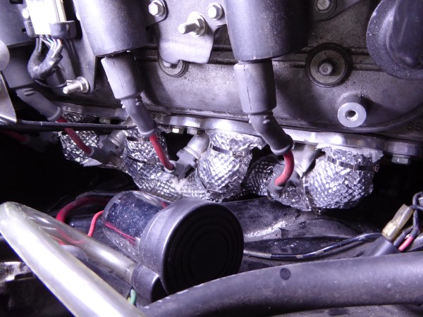

Yes a V8 can fit in a Jaguar 3.8s or MK but heat can be an issue. I've done a few things so that heat is a non issue. One of the best items is the Heat Shield header armor. I could not apply it completely as recommended which is they show doing individual pieces on the down pipes then a large wrap over the rest of the headers. For me I did individual pieces and separates ones under the car at the down pipes due to the tight header clearances.
This by far is better than wrapping headers as full wraps will make the headers brittle and break. These only cover about 70% of the pipes so that heat is directed down and this does not void your header warranty.
I also used the MSD starter that is made to handle extreme heat of the death valley type environments and do so for big racing engines. This alone might have eliminated my starter issues due to heat but this along with the header armor seams like a ultra safer way to deal with heat. I also used Heat Shield hot rod sheathing around the power steering lines.
Before all of this you literally could fry an egg easily as the engine bay would be super hot! Now it is drastically cooler and the heat has been tamed. I should have done this earlier as I went thru two starters due to heat, several issues with power steering heat issues, and my air horn compressor failed due to heat. It is good to use Heat Shield products on the engine fire wall and tunnel which I wished I did but I think the header armor is great as it eliminates most of the heat at the source.
This Jag is now an ideal daily driven car. The car will do 0-60 under 3.9 seconds, is reliable, has all the modern luxury of AC, power steering, big brakes, back up camera, etc. I was shocked to realize I've put about 20,000 miles on it now; this car is driven daily and driven hard.

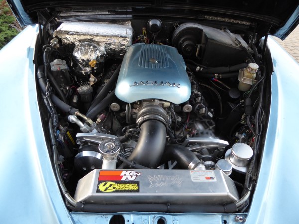

Here are some pics of my latest tweaks to the Jaguar 3.8s. Doug & Blue Rooster and others doing V8's you might think about these mods. What I found was after at least 30,000 miles driving it as a daily driver is that while all the improvements to cool the V8 were fine they did not address the venting of the engine bay for extreme conditions.
What I found out is that on a hot day of long driving my engine was at perfect temperature after all of the various tweaks previously but the engine bay temperature around the engine was not cool enough on stop and go after driving a good solid two hours or so. What I experienced was the engine was running off during that stop and go after two hours of hard running and it almost died. I might have fixed the issue with the header coatings and heat shield wraps and this situation might have been due to a small exhaust leak near the starter. Now I did replace the crank and another sensor after fixing the exhaust leak.
Since this is a daily driver I did not want to wait to find the exact cause as I need the car daily so in addition to the above I had my body shop create some ram air intakes. These are just low enough to scoop air both to the steering cooler yet are primarily designed to direct air around the engine/header more so the air can then escape the triangular openings on both sides of the inner fender wells near the firewall. This has greatly reduced the temperature in the engine bay. Now my previous mods of the header coatings and heat shield did reduce the engine temps but it was still a bit hot to me.
Lastly I also rewired the fans to that both the puller and pusher go on at 180. Before it was just the puller fan. I think I have finally solved all of the heat related issues now.
I will keep you posted on this and another mod coming up in the near future for suspension/brakes. Also you might notice the cool new headlights, these are the Vision X 7" LED and these are the best lights I have seen and definitely an upgrade for any Jaguar saloon, I recommend to go on Ebay http://www.headlightrevolution.com/V...xil-7rdkit.htm
